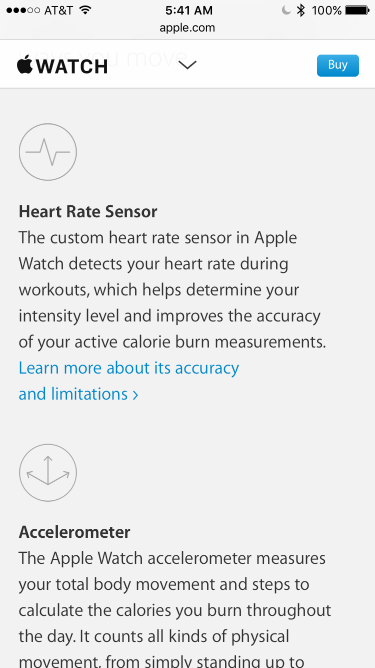

http://support.apple.com/en-us/HT204666
And also from the store page (Sceeenshot posted).
The information has always been available to the consumer. I don't think it's Apple's job to make sure the consumer is educated. I believe it's the consumers job to educate themselves before they buy something.
