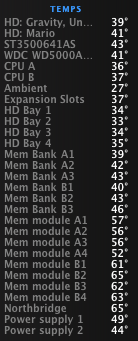

well my ram temps are still over 80 degrees celsius, and all the computer is doing is being a web server. what could i possibly do to try and reduce the heat?

Without the computer doing anything but being a web server, the temps are still high.

surely someone can help me out? 80 degrees Celsius can't be right while the computer is doing nothing (but being a web server)
ok, today i shut down the mac pro, took out all the ram and hard drives, and went to town with some compressed air. tried to get all the dust out and i even took each ram module off the ram banks.
now, after putting all back together, here are my temps and rising:
