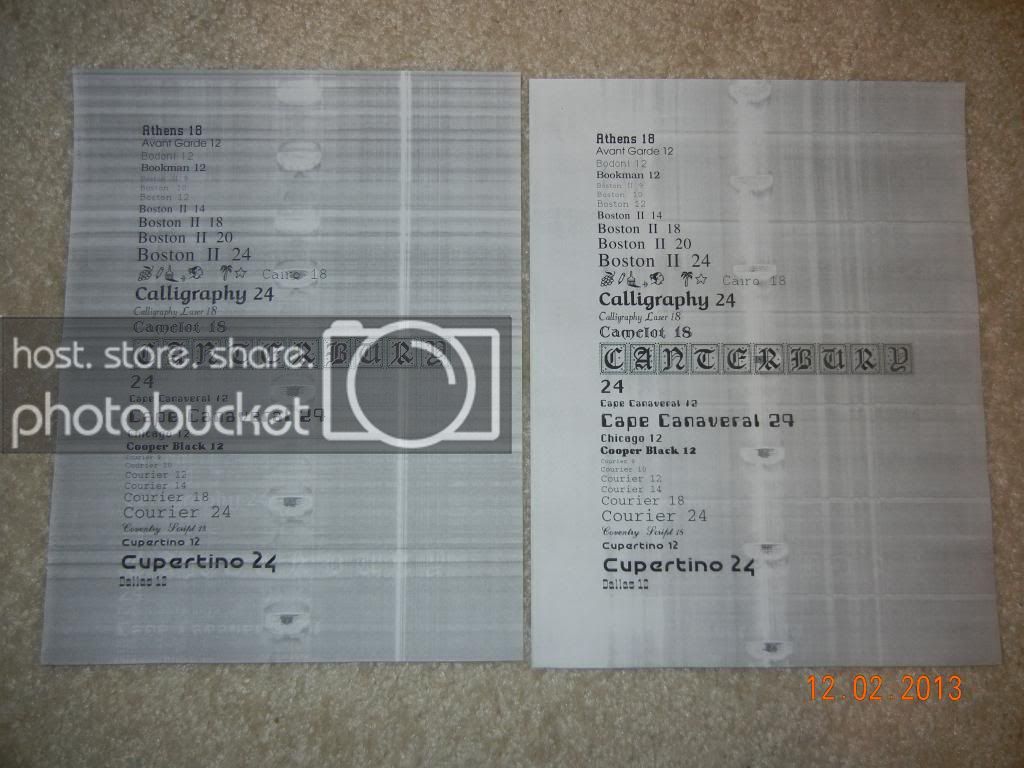

Check out this photo today.
They were printed with the same cart.
The light side is after I cleaned the small removable roller and cleaned it with alcohol.
How in the world does it get so covered in toner? Is it because it's a bad cartridge?

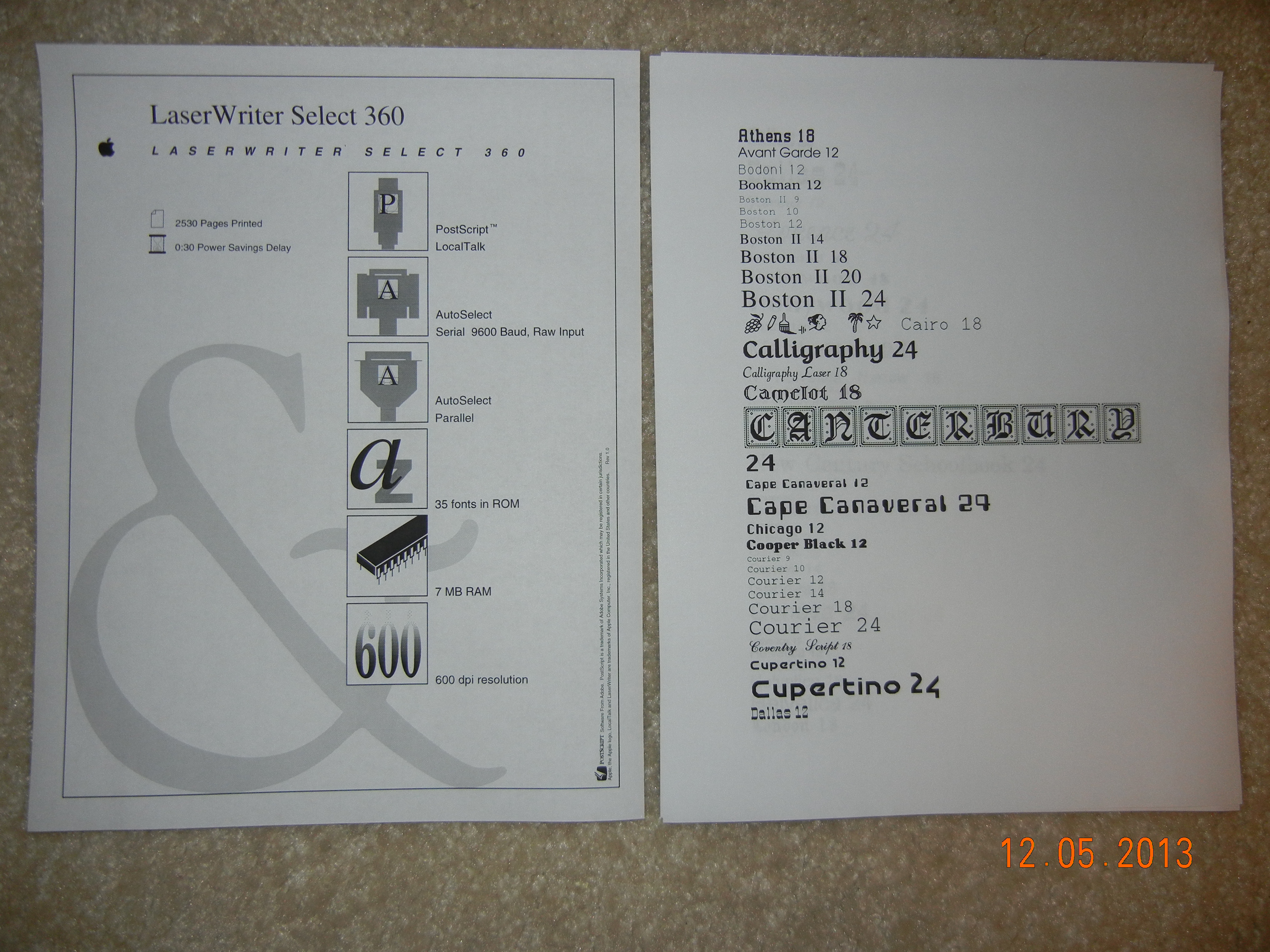

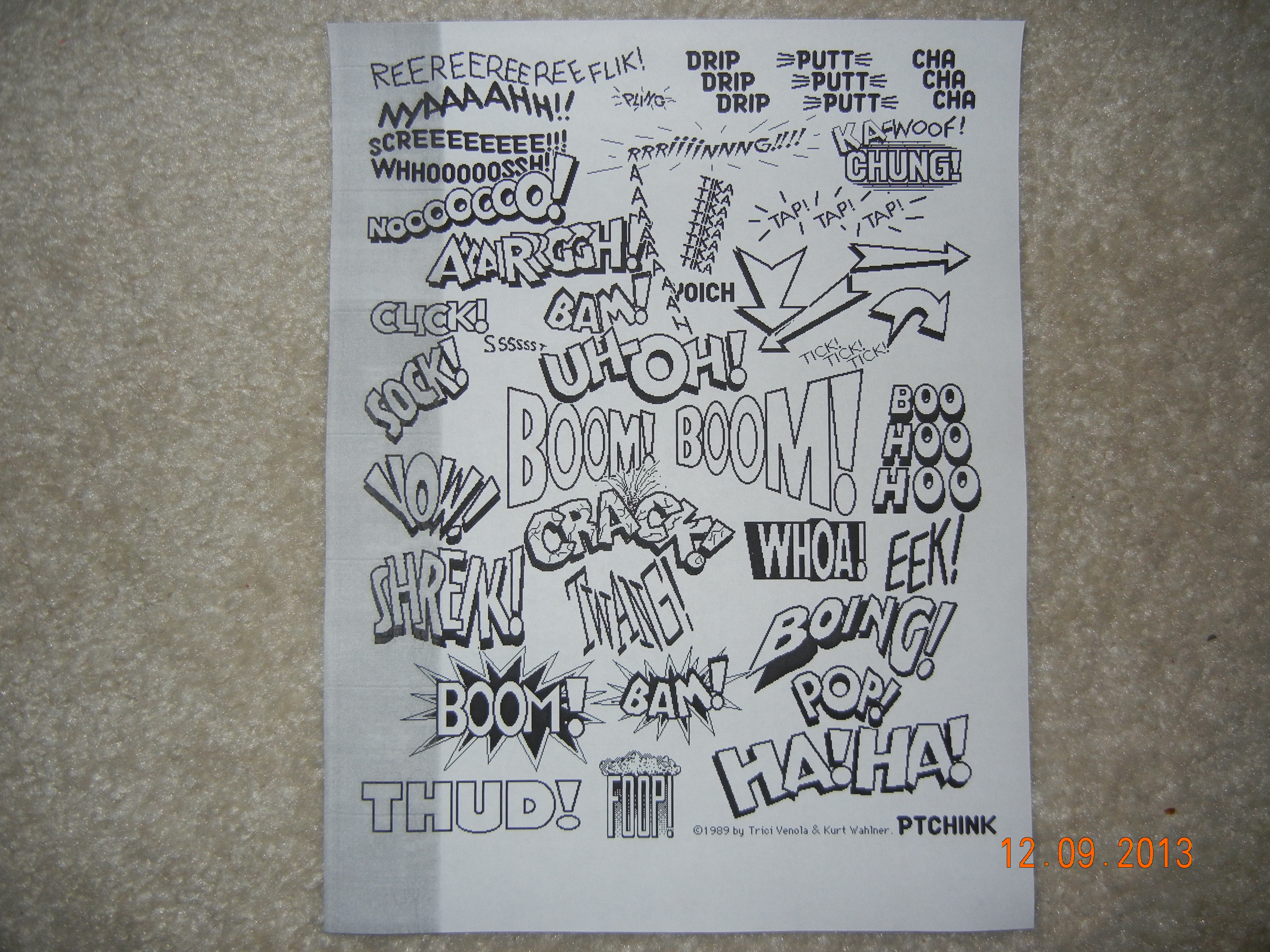

I got the new cart today, it is a REAL Apple cart, an original still in the foil bag! I didn't know they would stay so long.
Anyway, here's the photos of the new cart's printouts.
Hooray!
That's a pretty good looking print. 🙂
The old cart probably has a bad wiper or a charge problem with the drum.

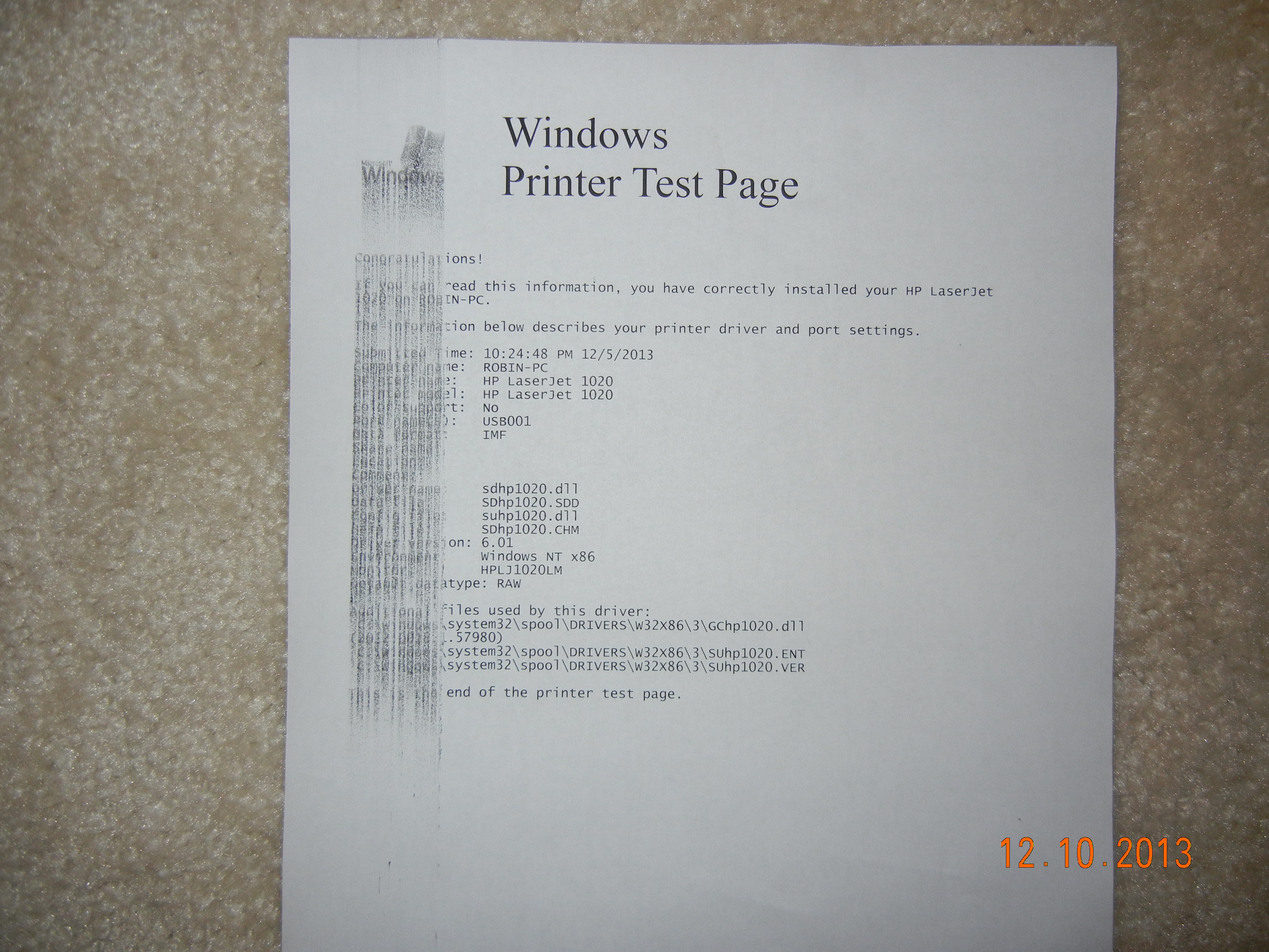

Meanwhile, what do you make of this?
My wife's HP 1020, I took it apart and couldn't find anything obvious, have the service manual, and this print is after a brand new cart. It's very rough, like tire tracks. Both doing the same thing. I ordered a fuser.
