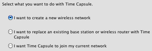

Upon setting up my time capsule, which of the following options would I choose to go with:

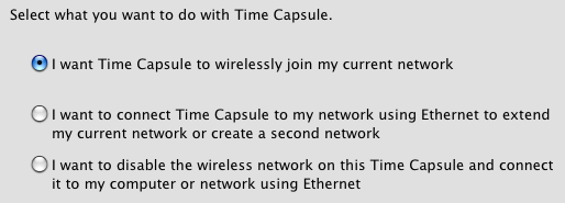

If I decide to have the Time Capsule "Join the existing wireless network" (which to me would seem the logical choice), which of the following options would I then choose to go with:

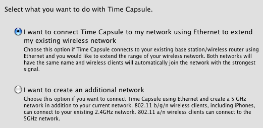

If I choose the option to connect the time capsule to my network using ethernet to extend my current network (which again would seem the logical choice to me), which of the following options would I then choose to go with:

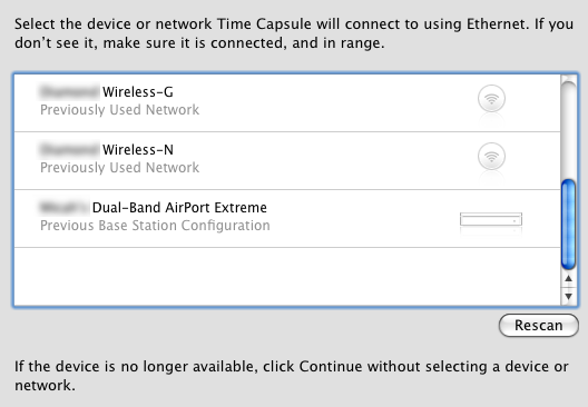

** THIS HAS ALWAYS CONFUSED ME...DO I CHOOSE THE DEVICE OR THE NETWORK? (i.e. do I choose the dual-band airport, or do I choose the Wireless-N network):
