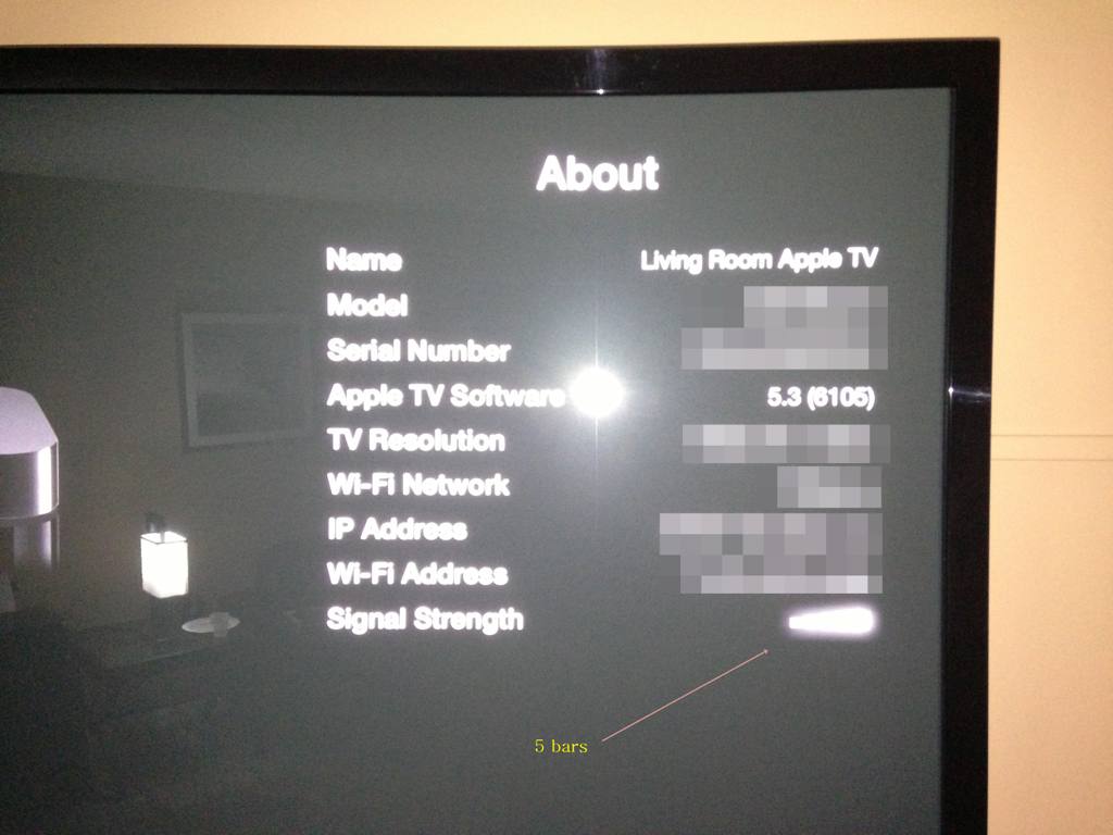

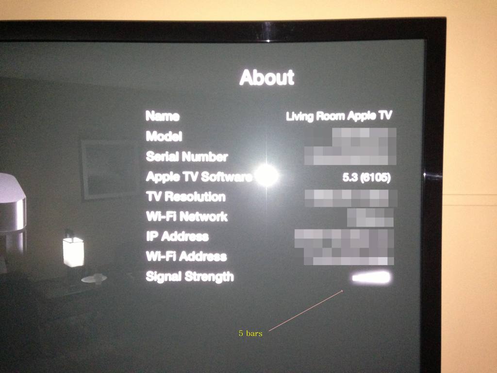

Tell me something. How do you know for a fact that your device actually recognizes that a Ethernet cable is connected to it? Is there conformation in the setting menu?
In the settings, my ATV displays a signal strength which doesn't make any sense to me bring that it's hard wired. Does your state the same thing?
Because when I go into settings, network, it shows an Ethernet address. Plus I never set it up to use wifi.
Also when I click on About, it shows ethernet address instead of signal strength.
