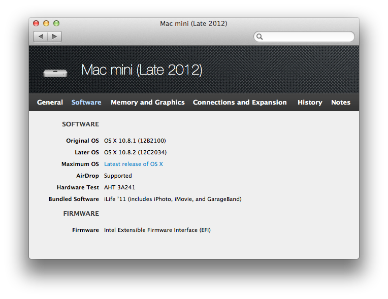

No you can't, If it's a 2012 Mini you can not instal an earlier OS.
Edit: To Install Mountain Lion again use internet Recovery by holding Command-R

Just to confirm the target mode install workaround wont work on the 2012 mini- only on the 2011 and previous.

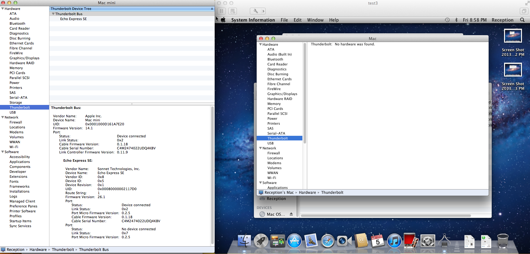

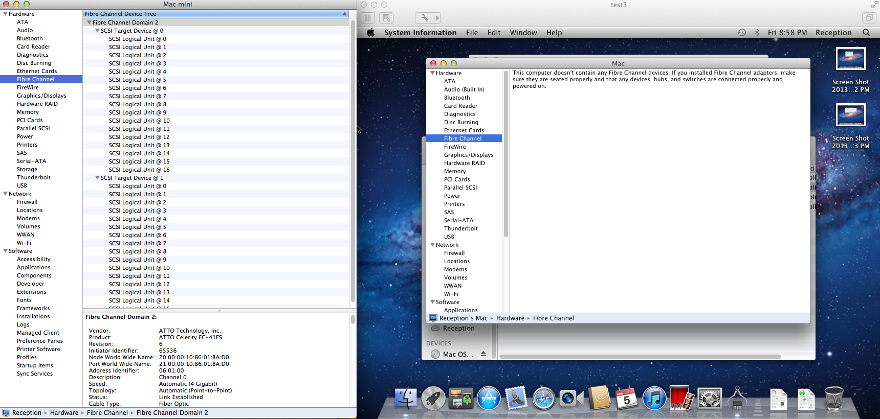

This is so frustrating. The software installs fine on my VM 10.7.5 and now the VM OS doesn't see my ATTO Card! See screenshots with side by side -- ML VS L --
How do I work with Thunderbolt in VM?!

What is that Atto card doing? Making a super-fast external drive, or more?
If it is just a drive, than VM can use any drive as shared network volume.
Yeah- it's 24TB of shared storage that works with project sharing with Avid Media Composer. Ill never buy another Avid hardware device again!
