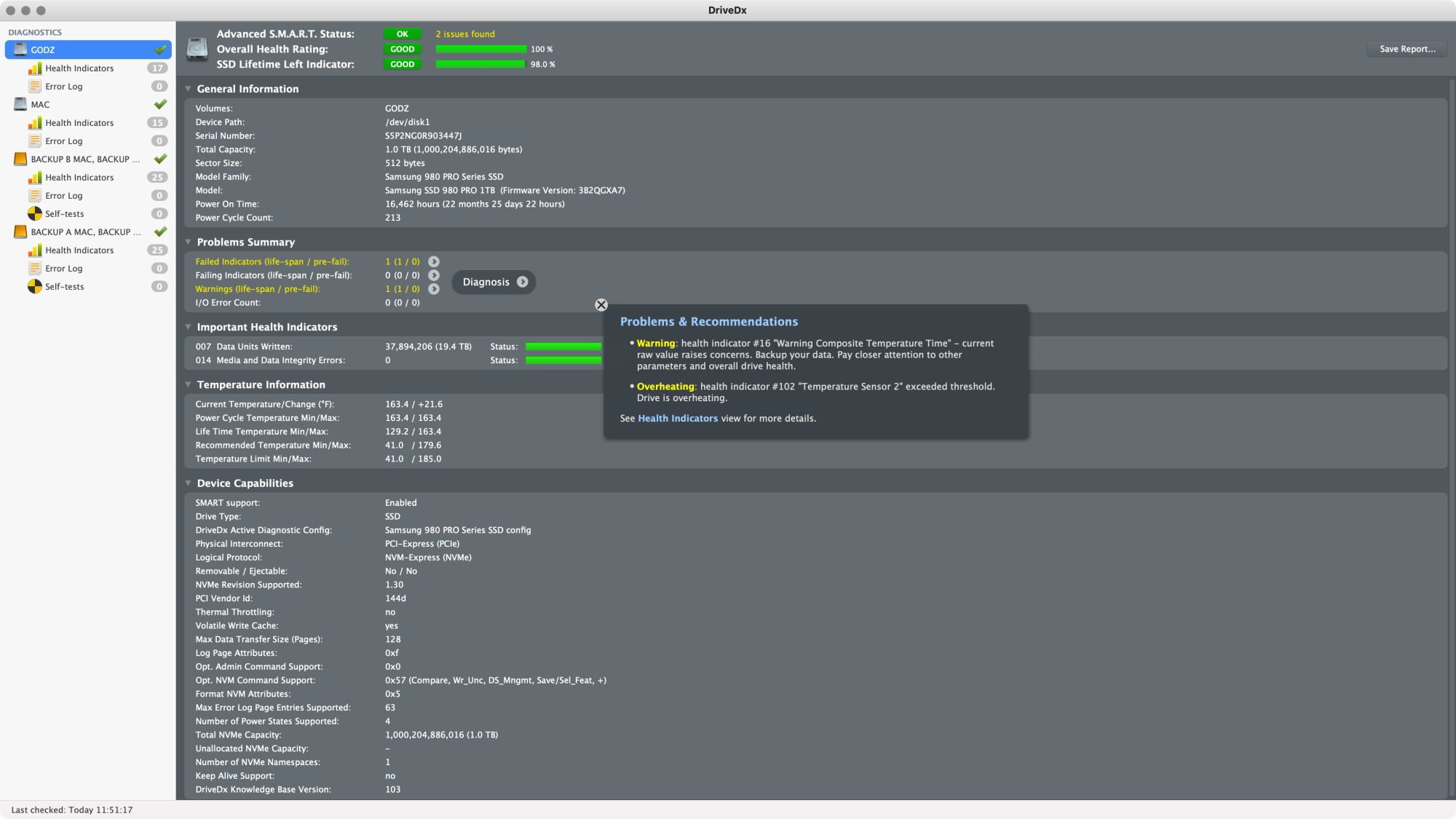

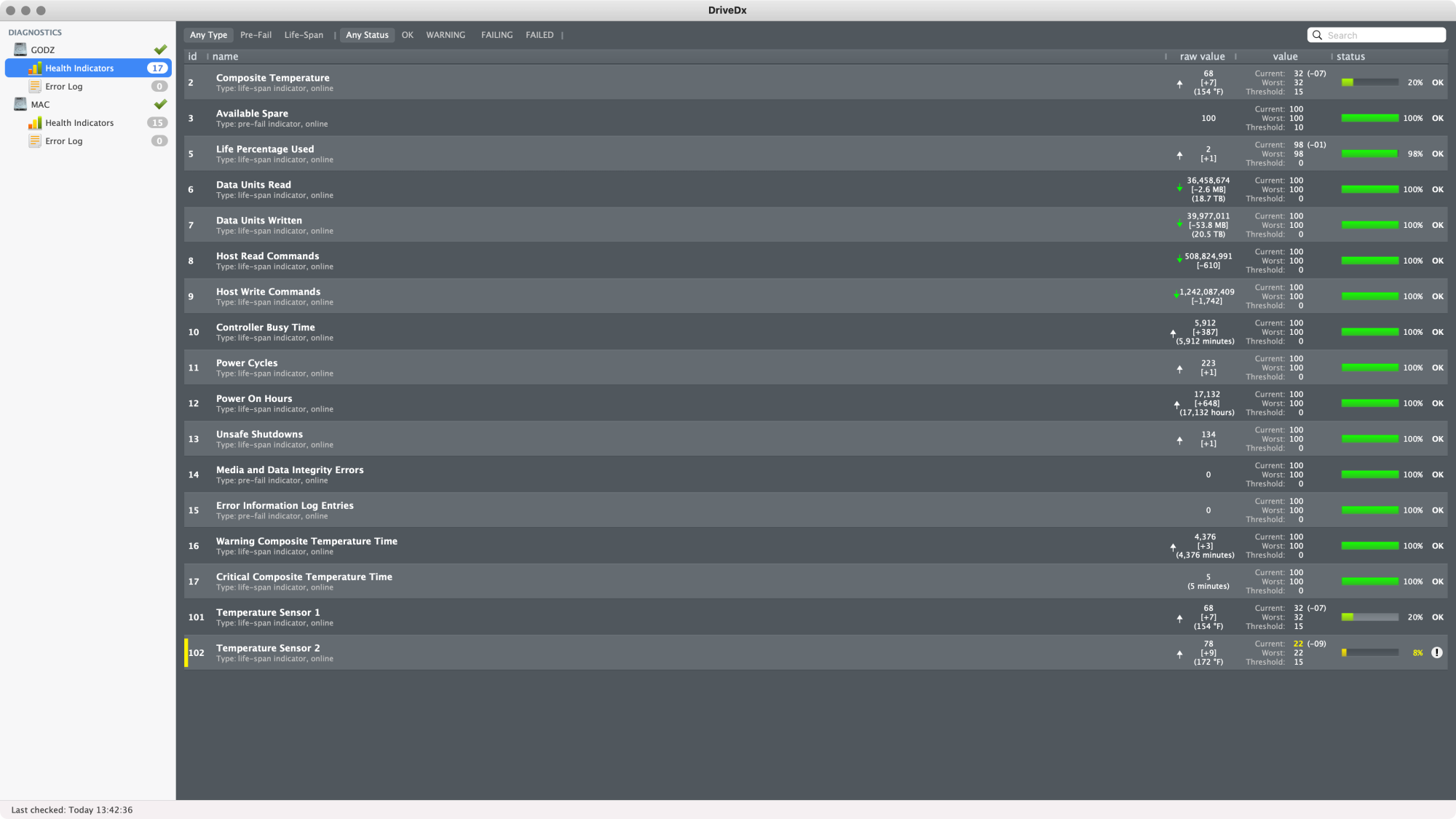

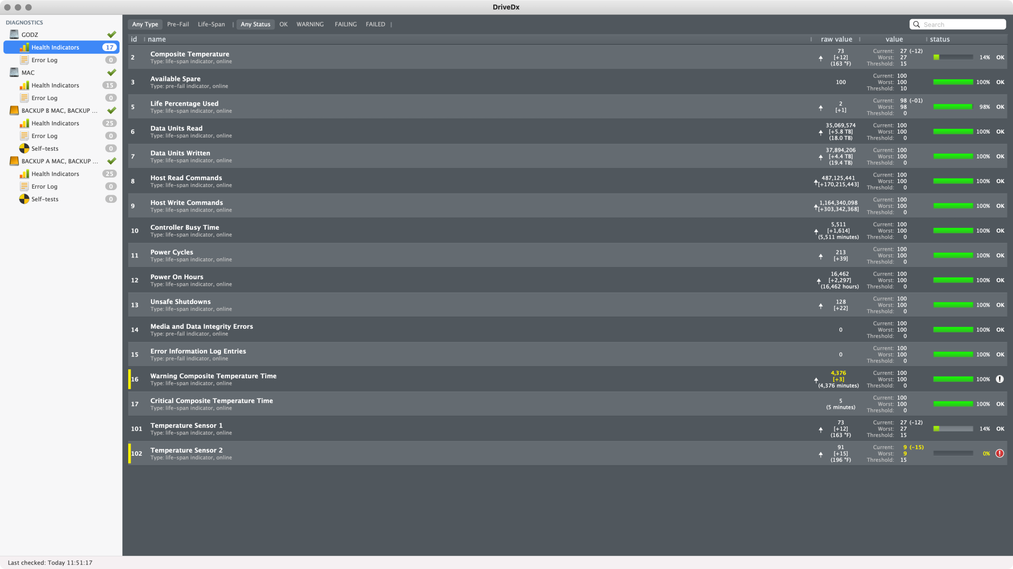

Recently I discovered it's almost always running at SMART alert temps 78c/172f, and recently warning temps of 91c/196f. I'm not putting that much strain on it and this definitely doesn't seem right. Could this be a physical NVME failure or what can I check?

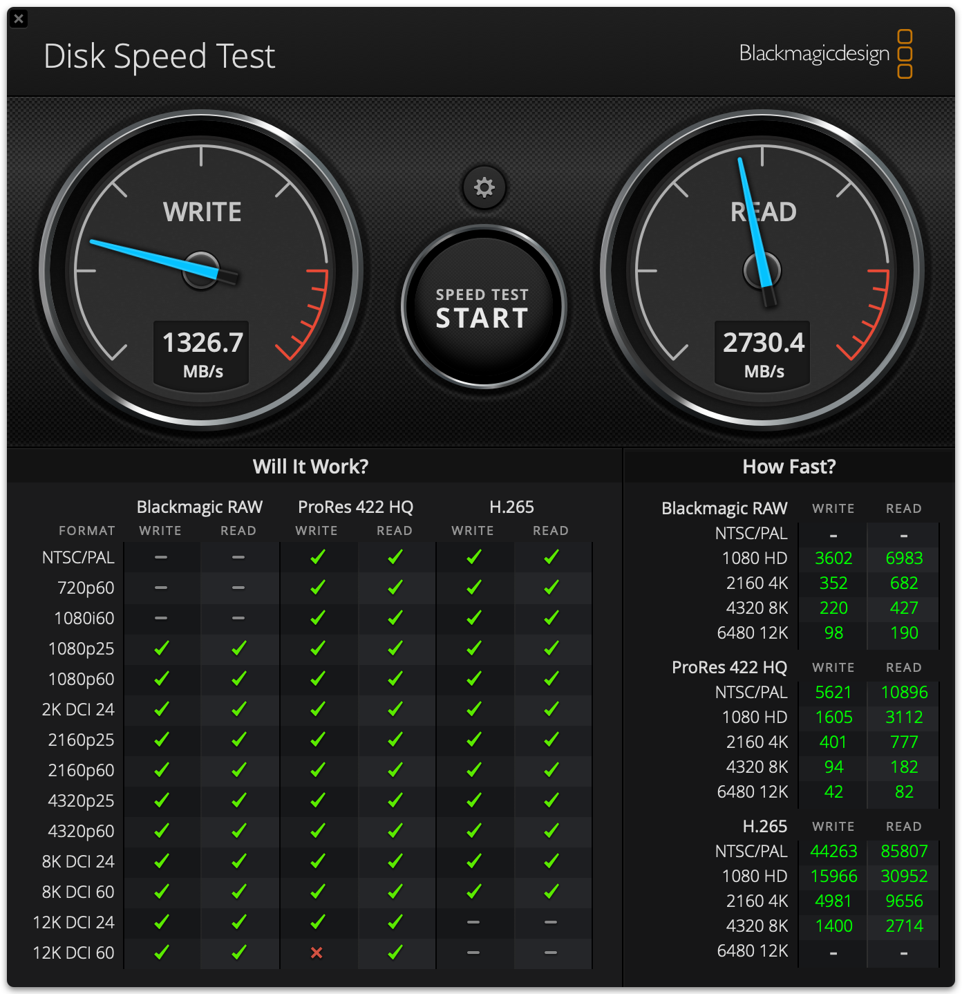

EDIT, I'm also getting it where my normal write speeds should be 2300 MB, but it's dropped to 1400 MB.
Do you have good contact between the SSD, thermal pad, and enclosure?
Given that everything else looks fine, I would make sure the drive is able to dissipate heat better.
as @meson said, also have you tried getting replacement thermal pads and maybe even another brand? I have the OWC NVME enclosure so I am not sure how much room you have between the case and NVME but if there is enough gap maybe you can put a 2nd pad on top. The 980 like other NVMEs will generate a good amount of heat, but nothing these enclosures and a good thermal pad shouldn't handle.
