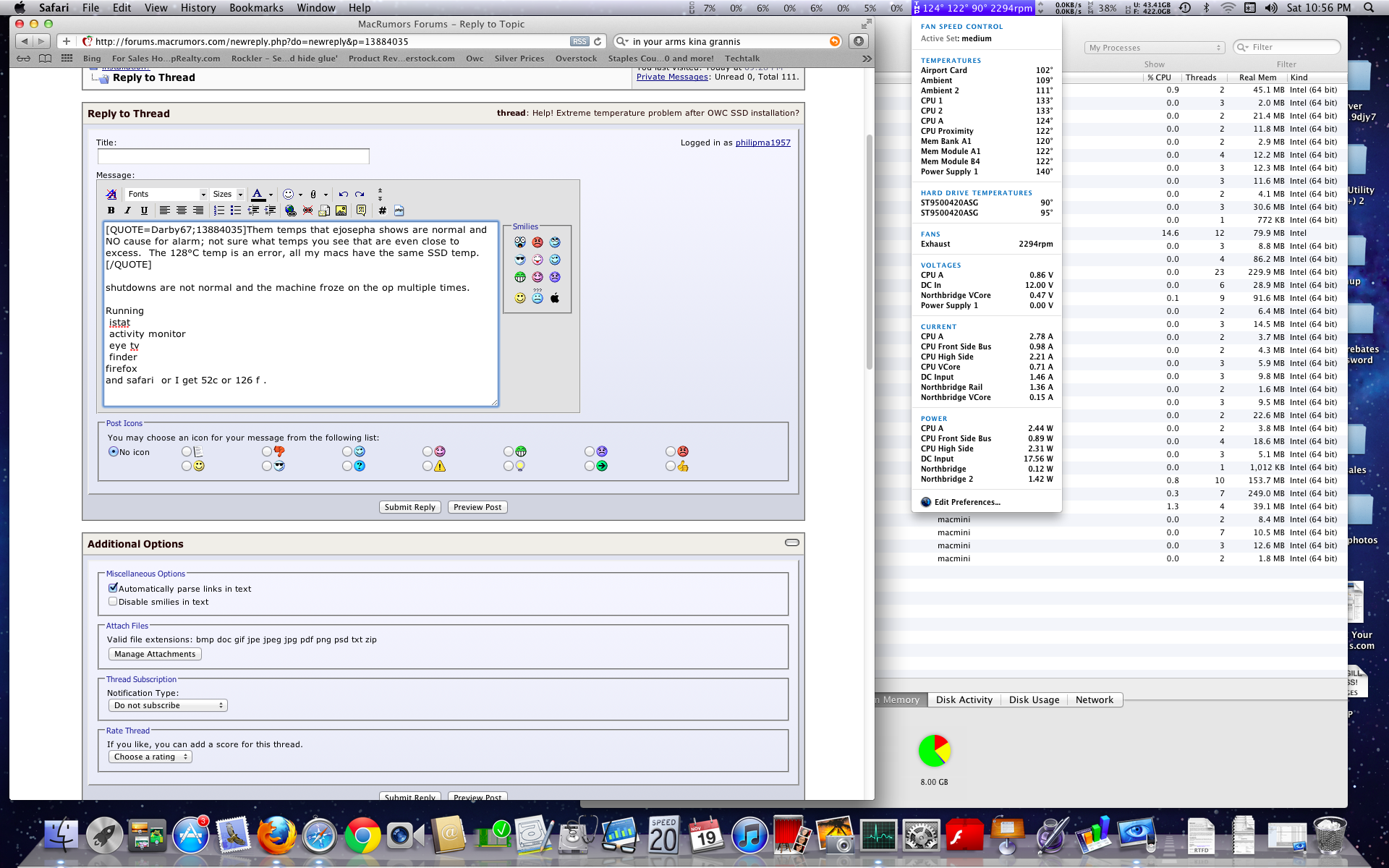

Running
istat
activity monitor
eye tv
finder
firefox
and safari or I get 52c or 126 f . see thumbnail
so op set your machine up with the same programs on activity monitor. see if you get the same readings I do. you have the i7 dual core i have the i7 quad core.
if you get 180 or 81 c with the same programs running that i show pull the ssd put the oem hdd back in run the same programs and see what you get. if you get 20c lower with the stock hdd dump the ssd or you will burn your machine out.not in a day or a week but in 13 months or 15 months.
my programs in the screen shot are not pushing graphics so if you run a game that pushes graphics you will shut the mini down.
just my take on this.
