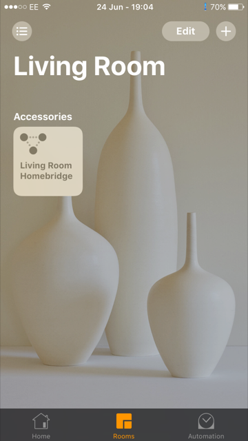

I can see Homebridge on Homekit on my iPad and iPhone. It's under Rooms and is titled 'Default Room Homebridge No Response'. Does that look right?

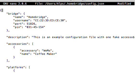

Thanks WB. This is what I done:
ping raspberry.local (ping raspberry just did not work so I done a bit of research)
ssh @192.***.*.**
nano ~/.homebridge/config.json
I then copied and pasted your text above and I've attached the result. Does it all look correct? Or still messed up?
If correct, what is my next step please?
PS How do I exit out of the attached screen and back to terminal and the raspberry command screen?

Once you get to that step and have pasted in the text, hit control-x and you will get a screen asking if you want to save the file. Hit y to save the file.
If you look along the bottom of the nano window it has a list key command options.

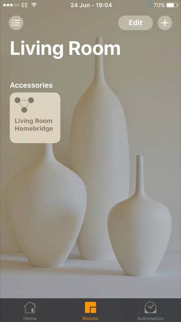

On Homekit on the devices, Homebridge is showing in 'Living Room'.

Yes... exactly. Each time you add a new plugin to support some device, you need to edit the config file to add it.
I have no idea about the specifics of adding the Ring though sine I have not done it.
It is good you can see the Homebridge setup in Homekit, so you have done something right! 🙂

Yep... I just logged in to mt Pi and when I control-x I get the save dialogue then hit y and it saves and quits the app.
Strange! I’ll try again in a few days. In the mean time, could it be what version of nano text editor I’m using or the config.json I’m using? I can’t remember how I installed it, but if there are updates to these then what version should I be on?
Cool. Ill try editing , control x and 'y'ing again just in case I'm don't something wrong.
Just tried again and it turns out that after pressing 'Y' I then need to press 'Enter' to exit Nano.
