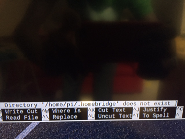

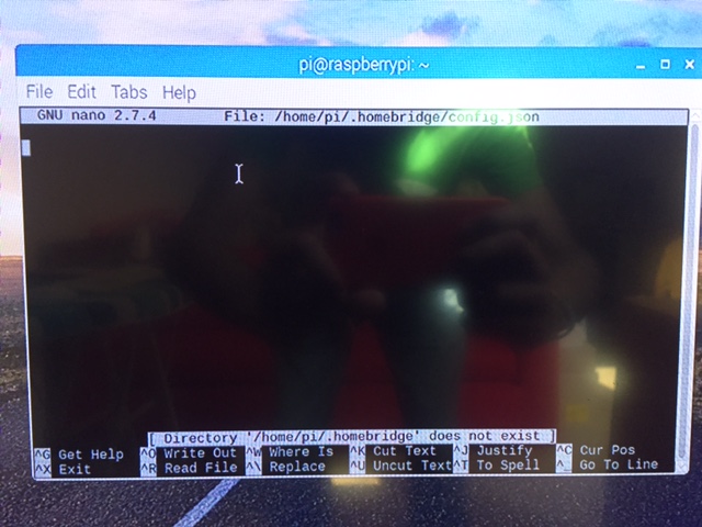

I’m back at it again. I entered as you advised above and here’s what I got What have I done wrong this time?
nano ~/.homebridge/config.json
You need to run this with that ~ tilde there, not the word home.
Strange! I did run it exactly as you advised so no idea why it says 'home'!!!
I tried several times too. Should I try going through the whole apt-get update route again? Maybe start from scratch?
Edit - I had a thought - over here in the UK, the tilde key ~ is to the left of the Z. However, when entering it directly from the Pi, it's the key to the left of the Return key. So I used that key.

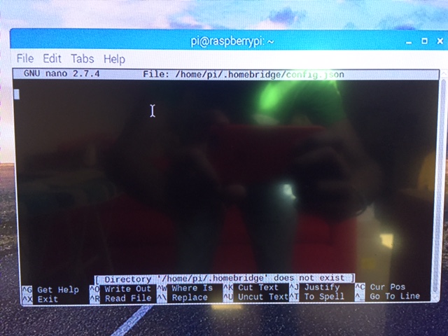

The only thing I can't get right is the config file
pi@raspberrypi:~/node-v4.3.2-linux-armv6l $ ~/.homebridge/config.json
-bash: /home/pi/.homebridge/config.json: No such file or directory
