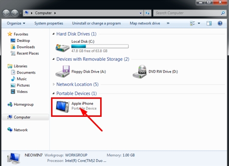

Yep. On a PC it appears as a drive with photos and videos that you can just drag and drop, regardless of a passcode.
You can't do that on a computer that's not a 'trusted' device.

OP-what should happen when you connect the phone, is that a box pops up asking you if you want to trust the computer you've attached it to.
From memory, I think you get a box that says "Trust/Cancel" (perhaps someone else can confirm), so if you can work out where the Trust box is on the damaged screen you can press it and then the phone should appear in Explorer.
