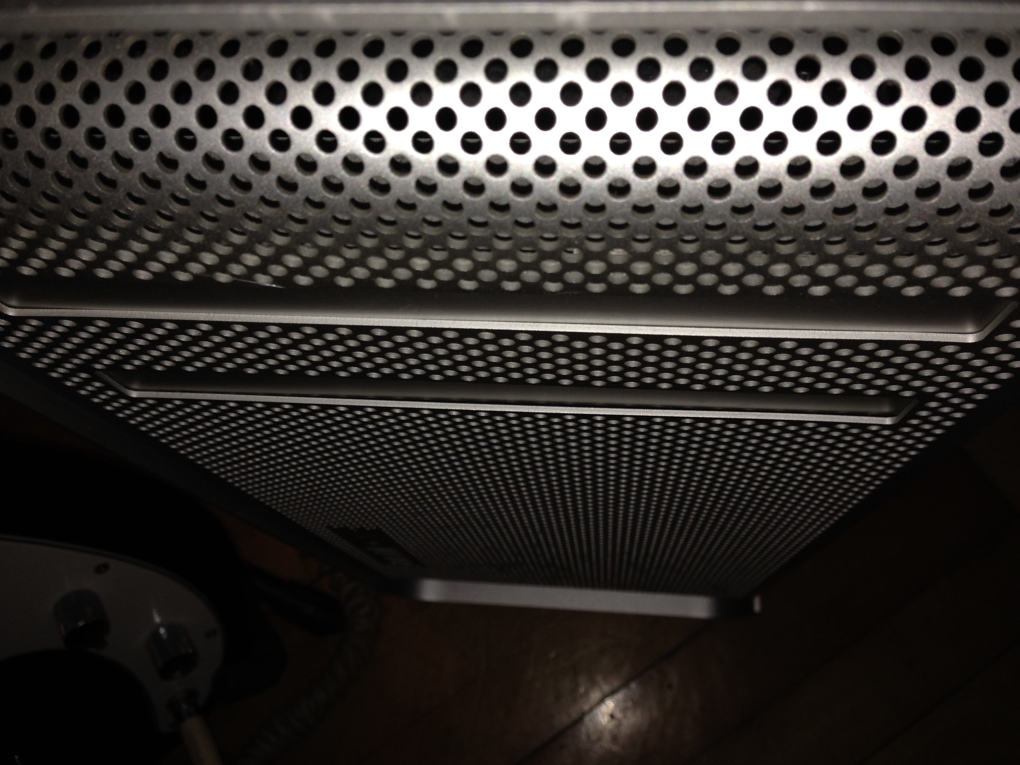

I have a Mac Pro 2010 which I baby'ed since purchase.
Yesterday, the metal door that opens and closes when the SuperDrive tray ejects and retracts start to stick. Now, even when the tray retracts fully back into the SuperDrive, the drive bay door remains open in the retracted down position.
I found this thread from MacRumors forum long ago and have already tried the suggested fix, but it did not help:
https://forums.macrumors.com/threads/anyone-elses-sliding-drive-door-stick-on-mac-pros.281969/
Can someone please give me some other troubleshooting tips or fixes? Anyone tries to "oil" the hinges? If so, how? What about out-of-warranty repair by Apple? Is this possible?
Please help!!!!

Anything I can try for a self-repair beforehand? It is truly disappointing given how much care I baby'ed my MacPro and still have a mechanical part breaking.
It's hard to tell if can be fix easily.
At least you have to open it up, take the optical drive out, and have a look what's happened to the door mechanism.
How often do you use the DVD drive? The quick & dirty fix would be to either jam the door open or remove it entirely. If that offends your aesthetic sense then forget about the SuperDrive buy a USB external drive for peanuts. Why not treat yourself & buy a Blu-ray burner? Then you can tell yourself it's an upgrade not a workaround for a defect.
You are correct. It is jammed in the open position. Admittedly, it is cosmetic. But also it keeps dust out. I have removed the optical drive bay and have thoroughly cleaned the bay and the door. No change. I don't see anything obvious. I can forcefully close the door by flicking it back up, but it would stick again. Possibly some spring mechanism issue?
I think his door is now jammed at the open position, so, won't affect any ops, just cosmatic issue.

I have the same problem and have spent hours without luck. The design is finicky and once it jams, there is little you can do to adjust it. Replacing it is a major job, since you have to take all the insides out to get to the back screw that holds it in place. I know close it manually by flicking the little tabs that get push by the sled, when it is opened.
Here is a tip that you may try if you are brave enough.
I got a Genius Bar appointment today at my Apple store. Showed the Specialist a video I captured of the door jamming. He said he had seen this before. Because the MacPro is very heavy, I did not bring my own system to the store without knowing first whether or not it is fixable. By chance, there was a Mac Pro at the store (not on display) that the Specialist said was also having the same problem. He took it out from the back room to see what's wrong with it (assuming the problem would be identical to mine) so that he might give me a quote for the repair cost.
Then a strange thing happen. As he was tugging the plastic frame holding the door mechanism from the inside backward, the frame suddenly gave a little, after which the door worked normally again. When we looked at the door, neither of us however could see any visual difference in the position of any of the parts. In the end, he said it was likely that there was a subtle misalignment of the frame against the chassis. He was tugging quite hard, obviously without breaking it, and I could see that the frame was partly moving away from the frame. After the tug, the frame must somehow reseated into the correct position to fix the door jamming.
I am too scared to try this on my own system. If any of you are brave enough to try, please report here your findings (with some photos if possible so the rest of us can follow you).

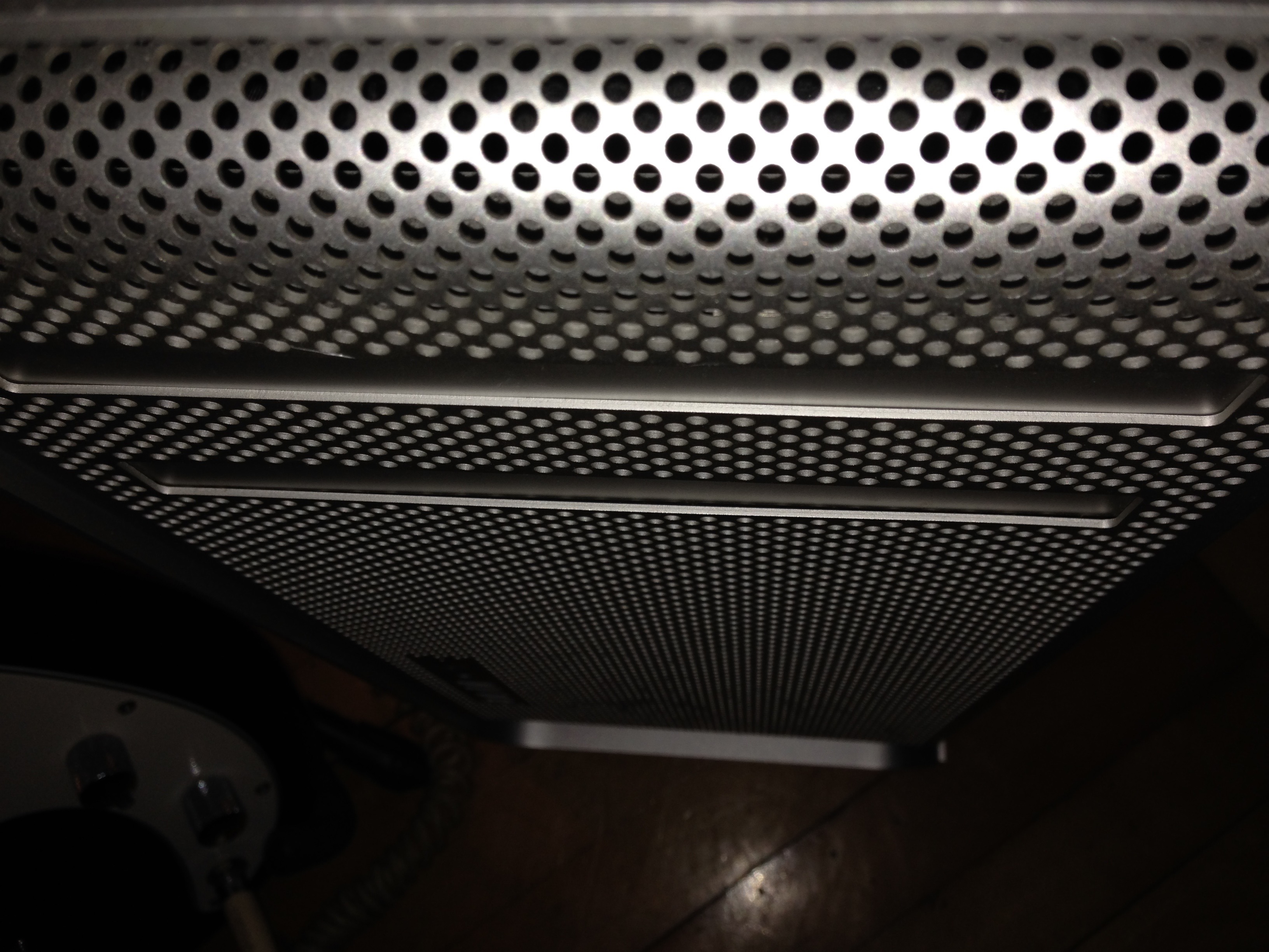

Can confirm - gently pulled back on the plastic frame for the door trays and the top one is now unstuck.

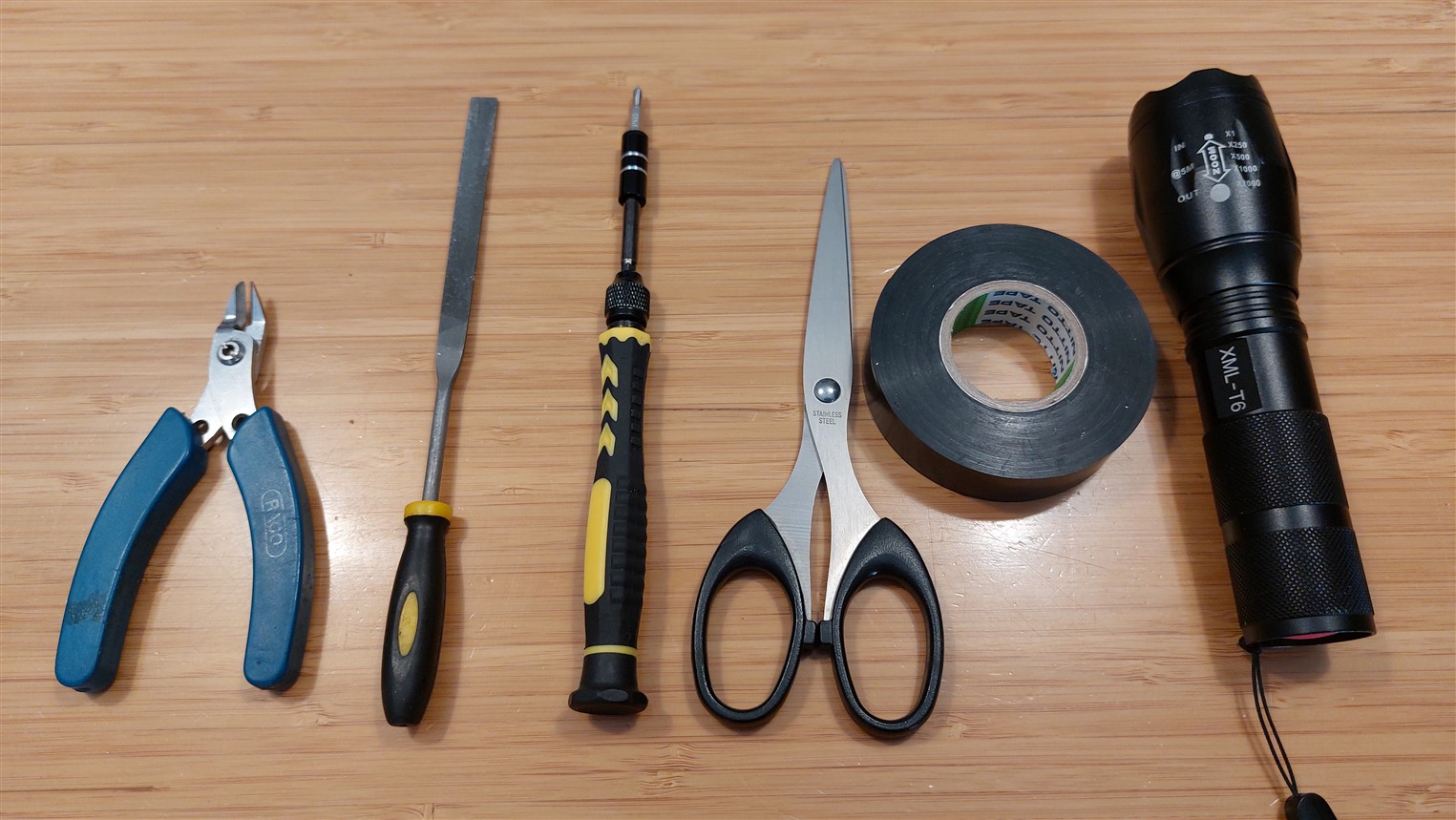

I found that a torch and magnetic tipped screwdriver was essential with those tiny screws and the angles of accessing the case.
These are the tools I used in order to solve the problem.

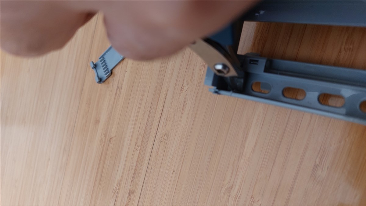

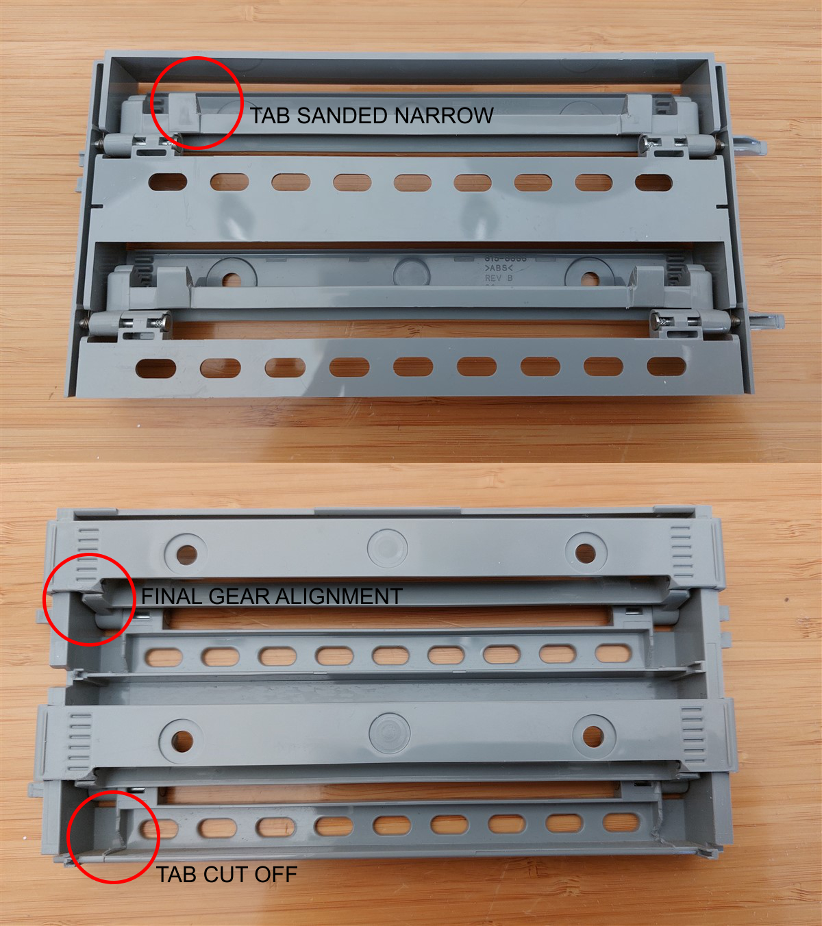

This solved the problem of the mechanism locking up on itself when it is out of the case.

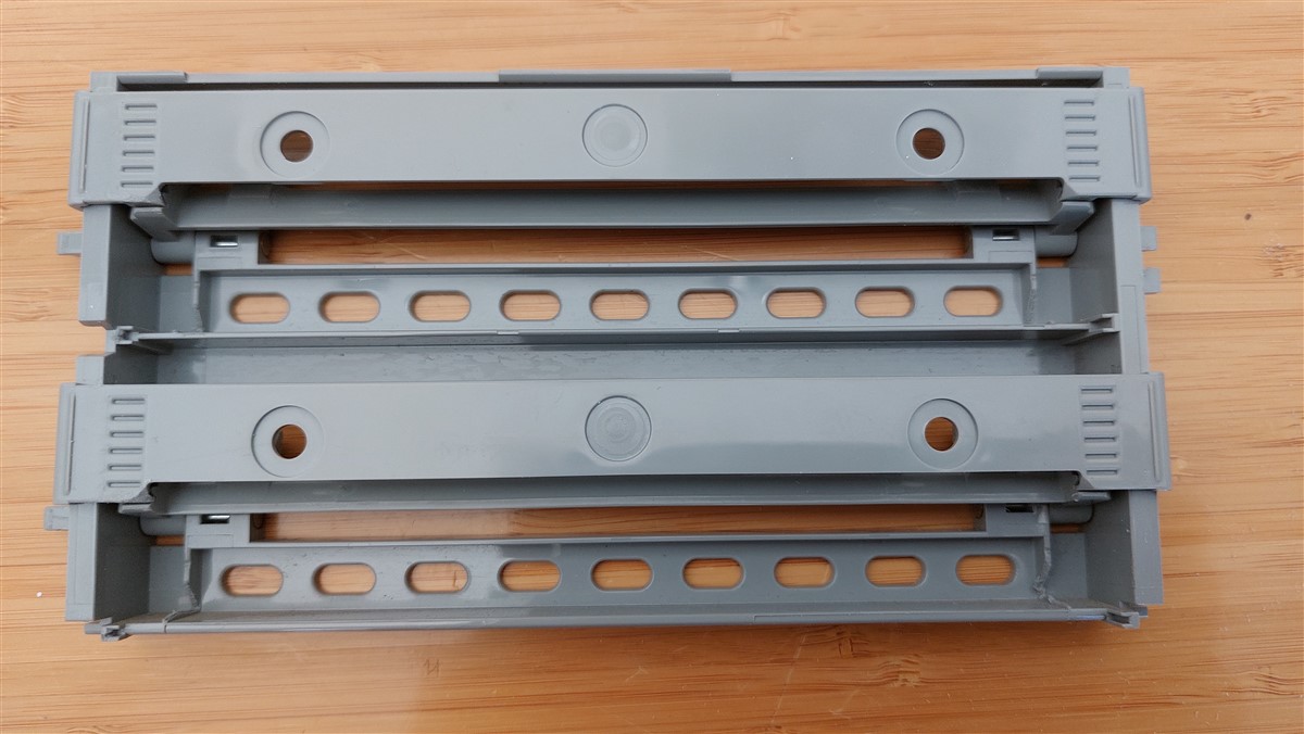

Cut the tabs off with the pliers.

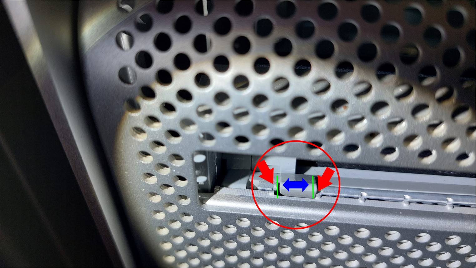

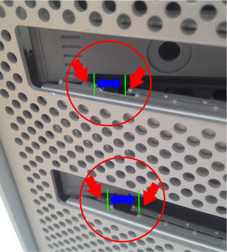

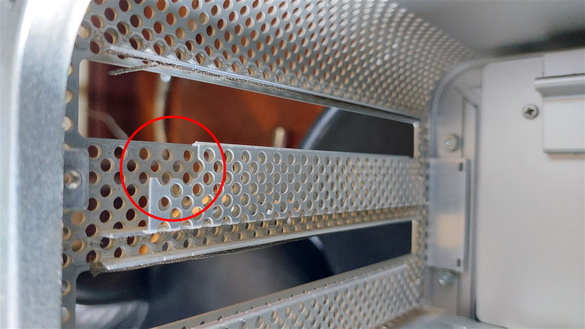

I still had the drive door not closing and had a closer look.
When the plastic drive mechanism goes down it was still grinding against the inner aluminum mesh of the case. The problem was on the sides of the drive sled tabs. The optical drive tray/sled pushes the tab down and slides on top of it when it opens and closes.
There is almost no tolerance between the tab sides and the aluminum case mesh.
Depending on where and how the mechanism was seated the problem got worse. That explained why it would sometimes jump free when the mechanism got nudged to the back or the side.
This image shows the pinch points - the tab against the mesh with almost no clearance.
The mesh is grinding against the plastic sled tab. Pinch points from the front.

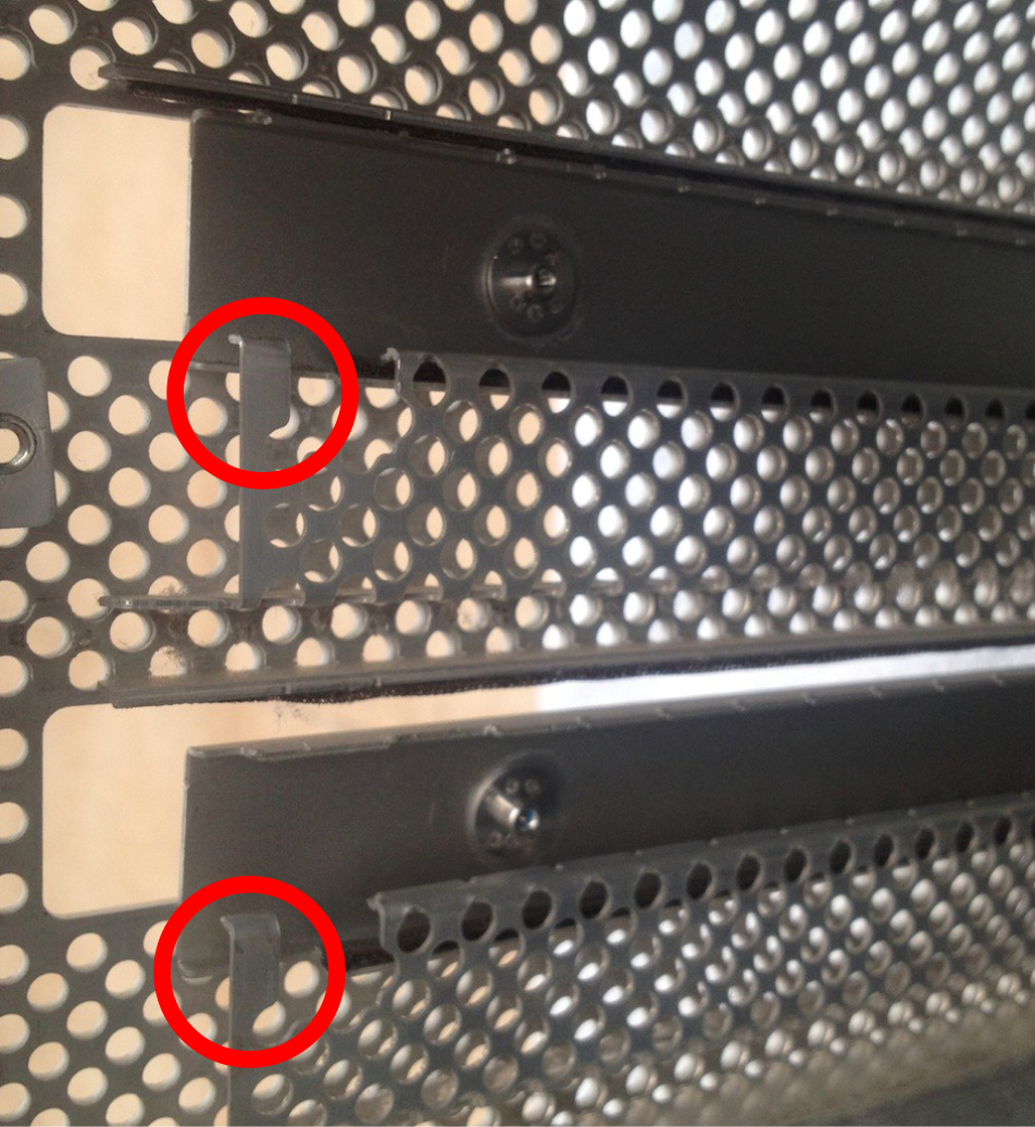

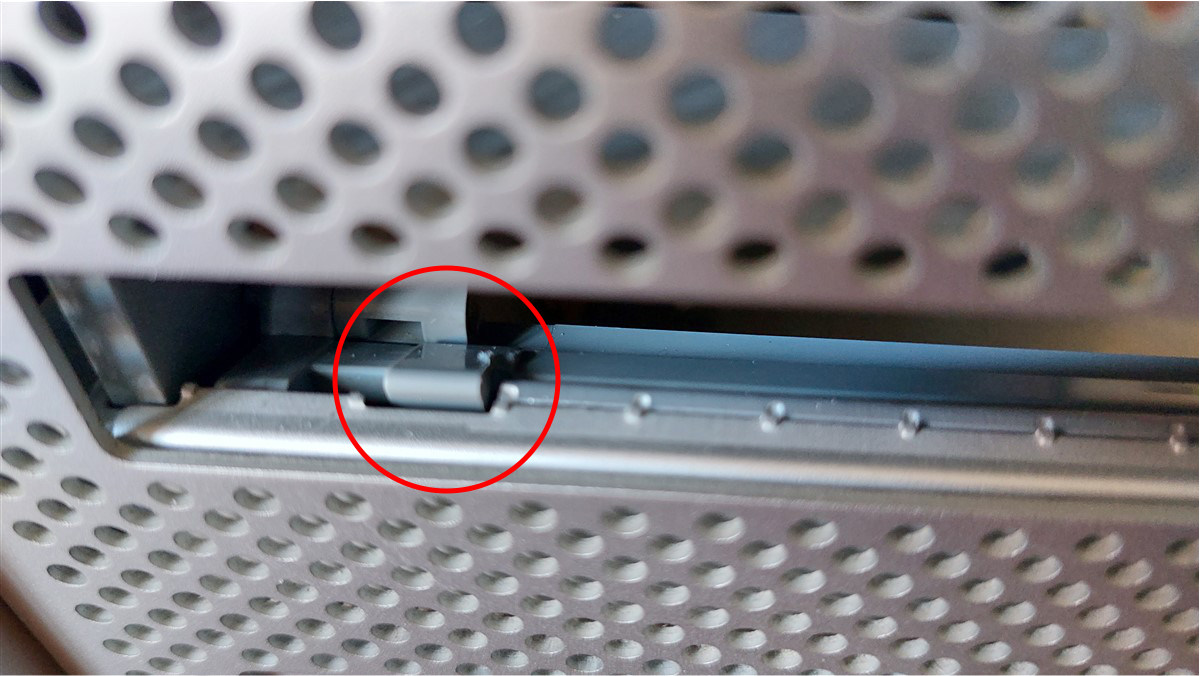

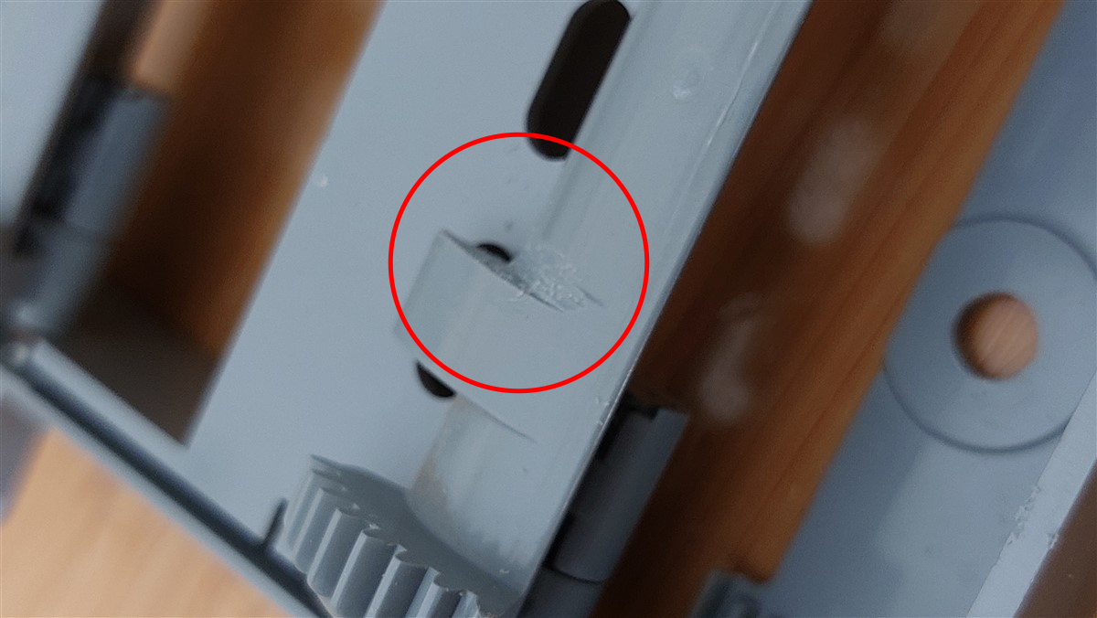

Notice the tab bent out of alignment on the top left.
The image below shows the pinch points from the inside.

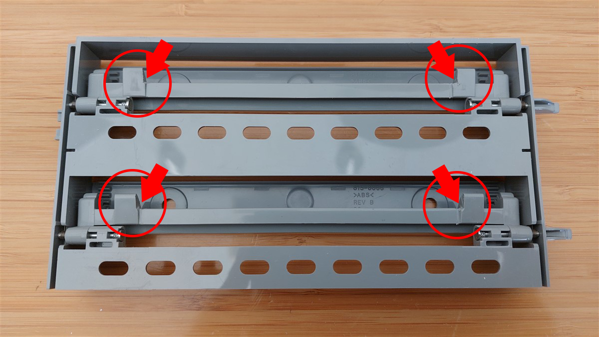

So I removed the aluminum tabs on the outer part of the mesh. I just bent them a few times (left to right) and they snapped off.
It seems they have no use at all and do not affect alignment.
These tabs bend easily and caused them to grind against the outer edge of the sled tab.
Image below shows one of the tabs removed. Remove all four.

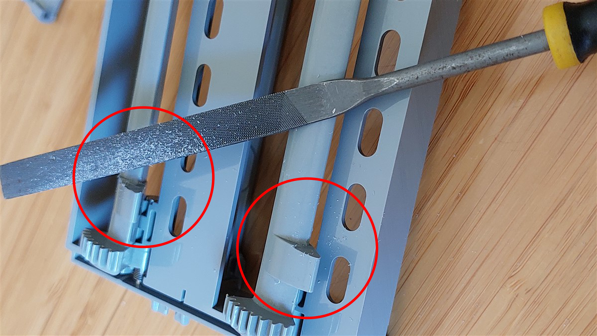

Then to take care of the inner part of the plastic sled tabs rubbing against the mesh. I filed the inside edges of the tabs down by 2mm to increase the clearance between the plastic tab and the aluminum mesh.
You could also file away the edges of the aluminum, but it was easier for me to just file the plastic tabs. (no metal shavings in my case)
It still got stuck when pushed all the way down. So I rounded the sanding off some more.
Rounded inside tab edges.
All four sled tabs filed narrower on the insides. The tabs still work and the door mechanism is not compromised.
This image shows the final clearance between the mesh and the sled tab sides.

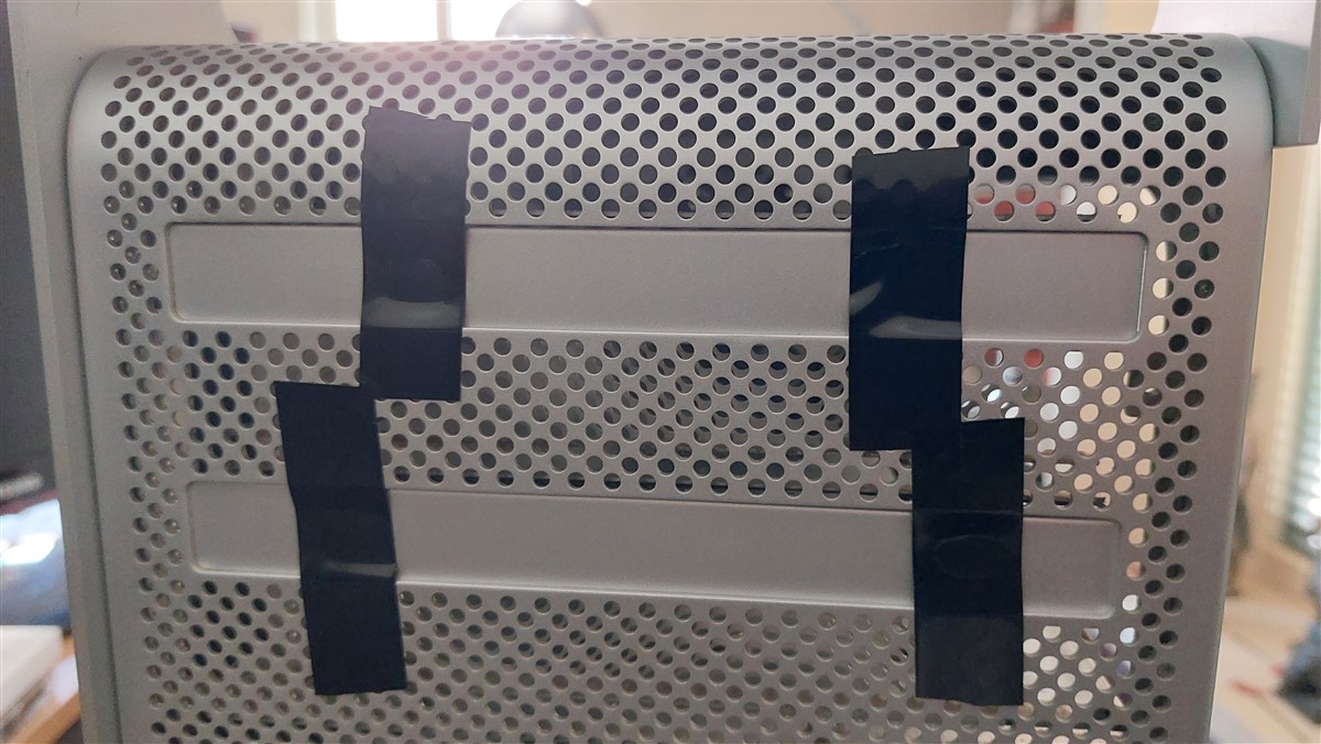

Finally lined up the doors with tape before replacing the mechanism.
The image below shows the final state of mechanism before putting it back in the case.
Use tape to line up the blinds before screwing everything back in place.
