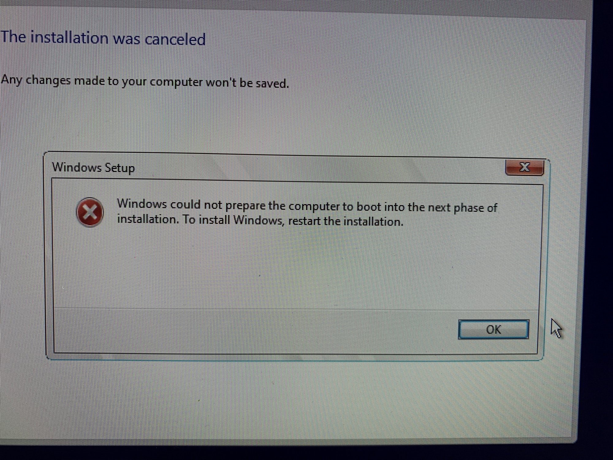

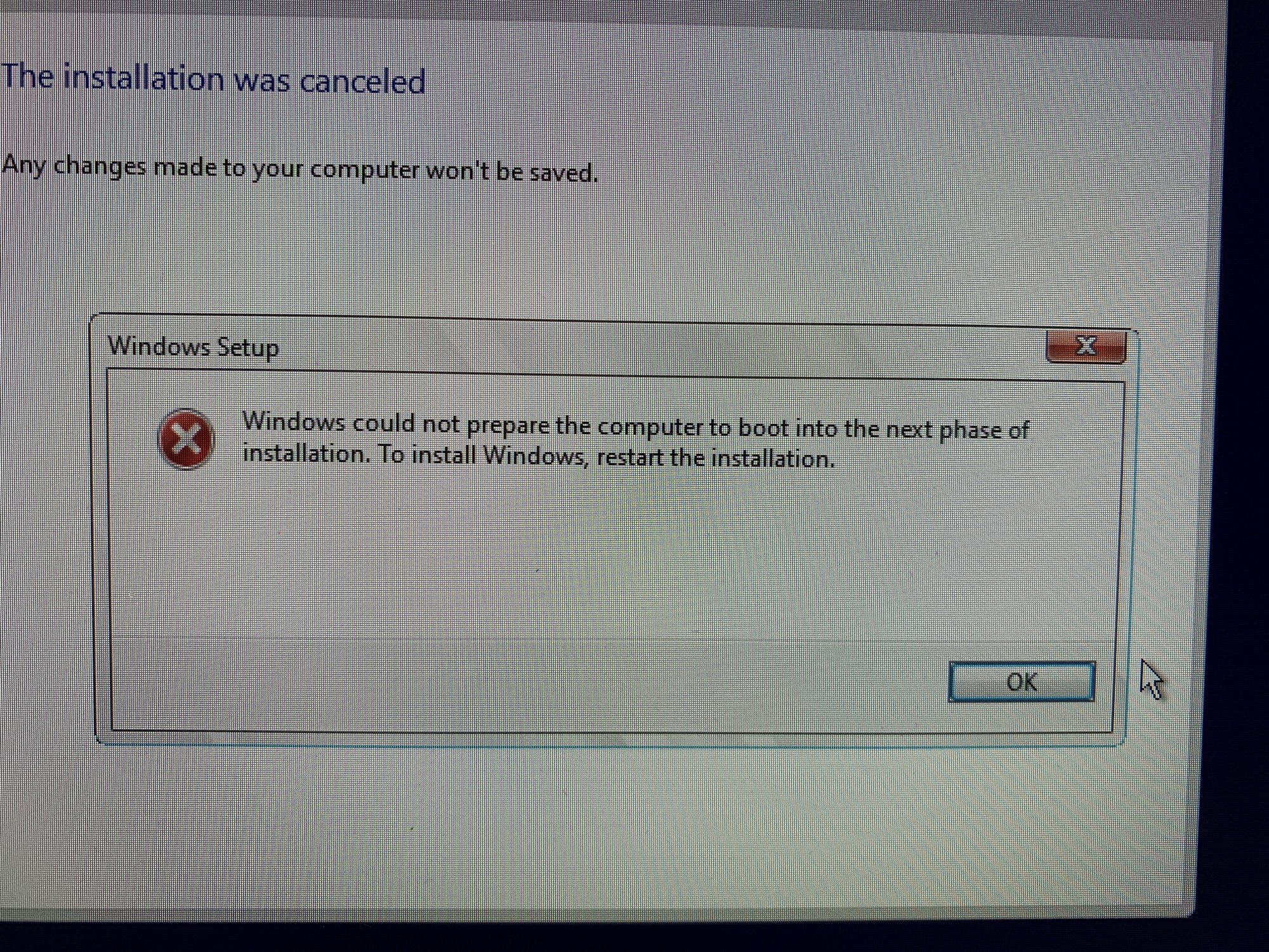

Hi, recently i've been trying to install windows 7/10 on my 27" imac 2011 with a quadro k1100m. ( my only os is high sierra, also I have the original 1tb hd and an 480gb ssd, where osx is installed ) So far, I've tried everyting, and nothing seems to work, not even bootcamp on high sierra, even with dvds, with no modifications for windows 7. At this point, I don't know if it's even worth it to try anymore, unless someone knows a fix, I've even tried the VirtualBox method and it also failed... ( did everything on a fresh install of High Sierra )
Here's the error that I'm getting on my latest take on this: ( virtualbox method )

I think Bootcamp works best if you just have a single disk installed in the machine. If you are comfortable opening it up you could try that. Then put the second disk back in after getting Bootcamp working.
For UEFI Windows (you get this if you install from USB) you'll want to be using OpenCore from the Graphics Card Upgrade thread or to use a DSDT override to get the speakers working.
Where do you get stuck doing it using the Bootcamp method?

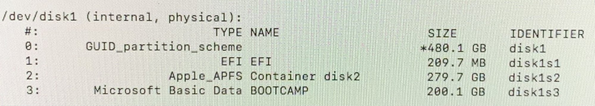

I was reffering to the fact that I have 3 partition, right now I have only High Sierra installed, experimented a bit with Big Sur, and then I tried to install Windows and accidentally wiped my entire ssd, luckily I had a backup of High Sierra. I would like to know if I can install Windows alongside those 2 OSes. I can also wipe everything off of the SSD and start fresh with Windows, and then install the other OSes, since I have a backup.
The condition is that MacOS needs to make space for a second partition. What you apparently can't do is have MacOS installed with a single partition, and then use Windows to create two out of this. You have to let MacOS do this, and this is done using Bootcamp.
Once you have this second partition, you remove the MBR portion, and then you can cut it up into further partitions to allow more than just a second OS.

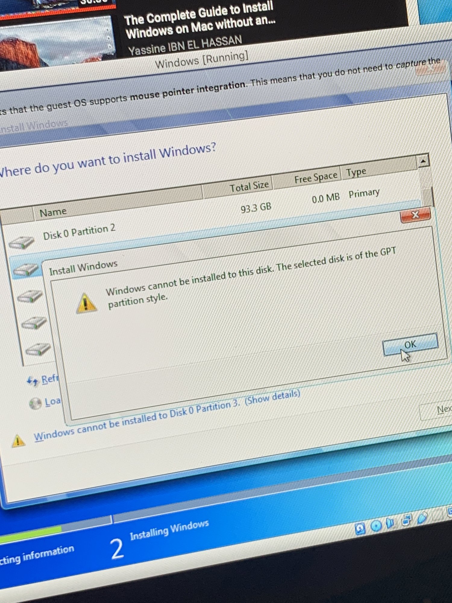

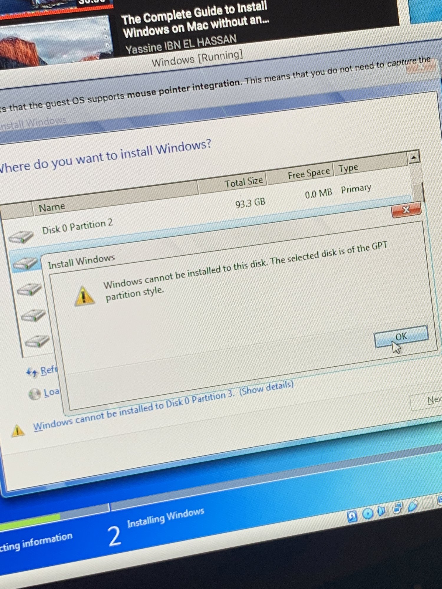

I managed to convert the partition to gpt and format the bootcamp partition, but now i get this error:

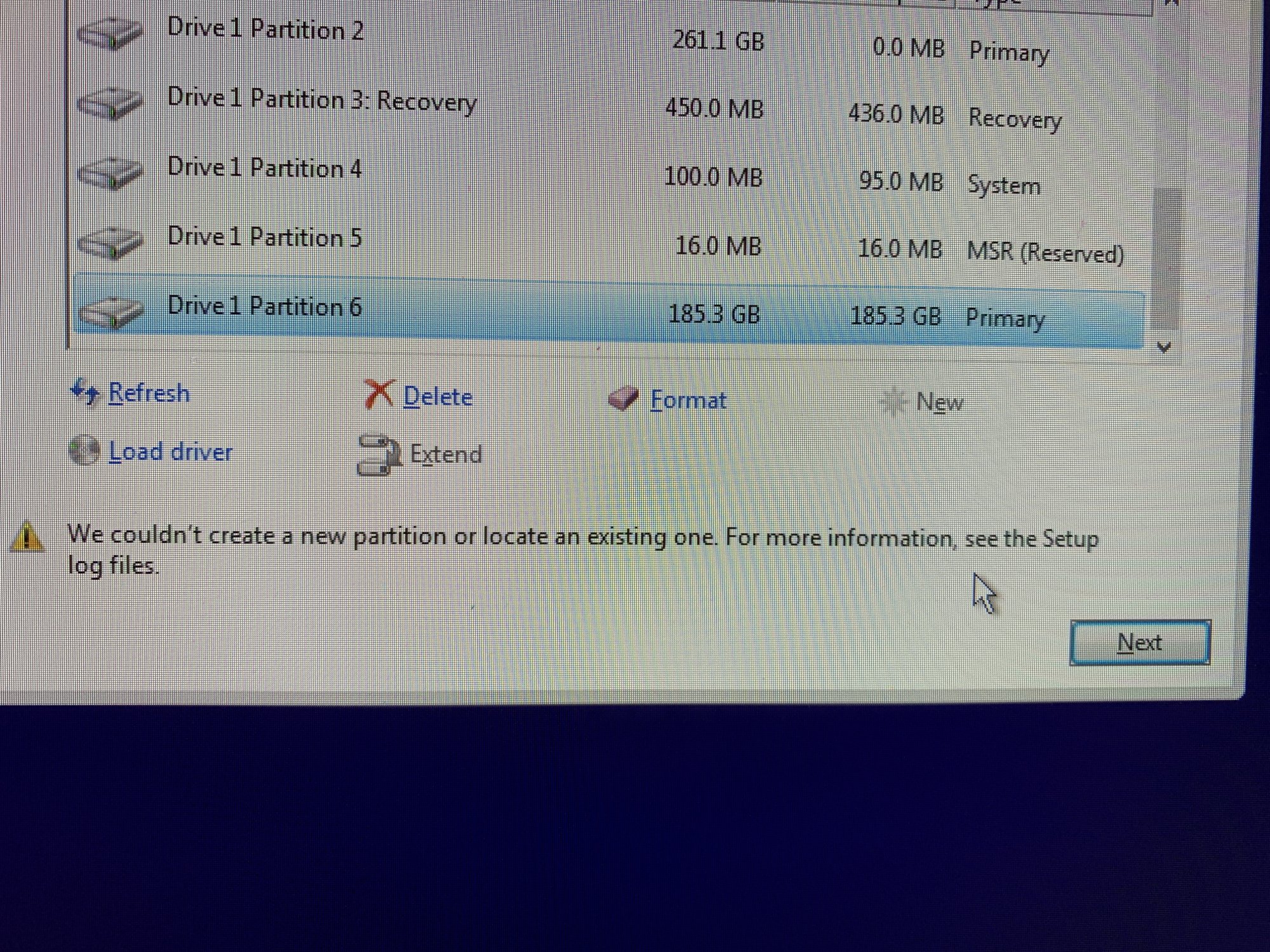

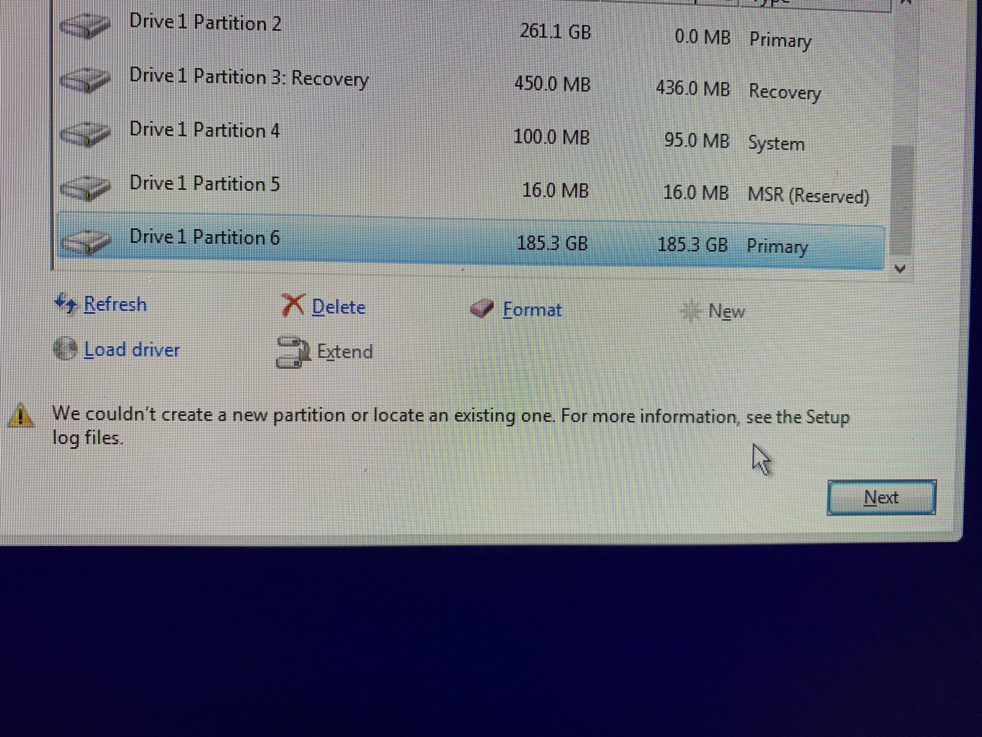

I Managed to find another Win7 ISO that actually installs on the BOOTCAMP partition, but after the install I get this:
Windows should be installed on partition 1, 2, 3 or 4. Windows has problems installing in partitions 5 onwArds. There are apparently solutions, but I do not know, so please search and let us know.
Your attempt with Windows 7 is probably the same reason.
Nope, tried installing windows 7 on partition 3 and the result is that.

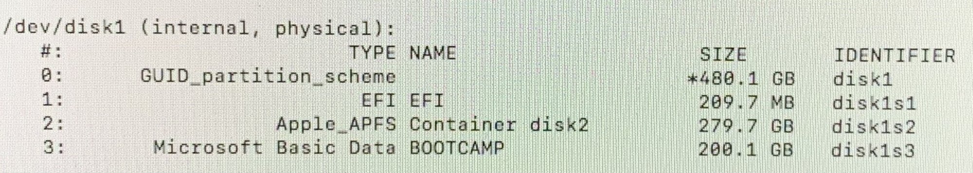

As you can see, these are my partitions on the SSD:

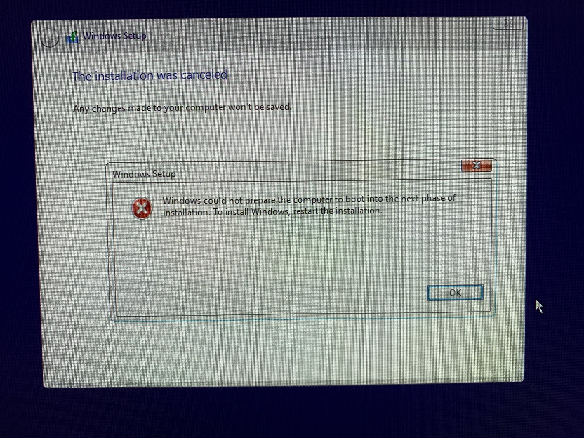

EDIT: Tried reseting the PRAM, but i get the same message: (second pic)

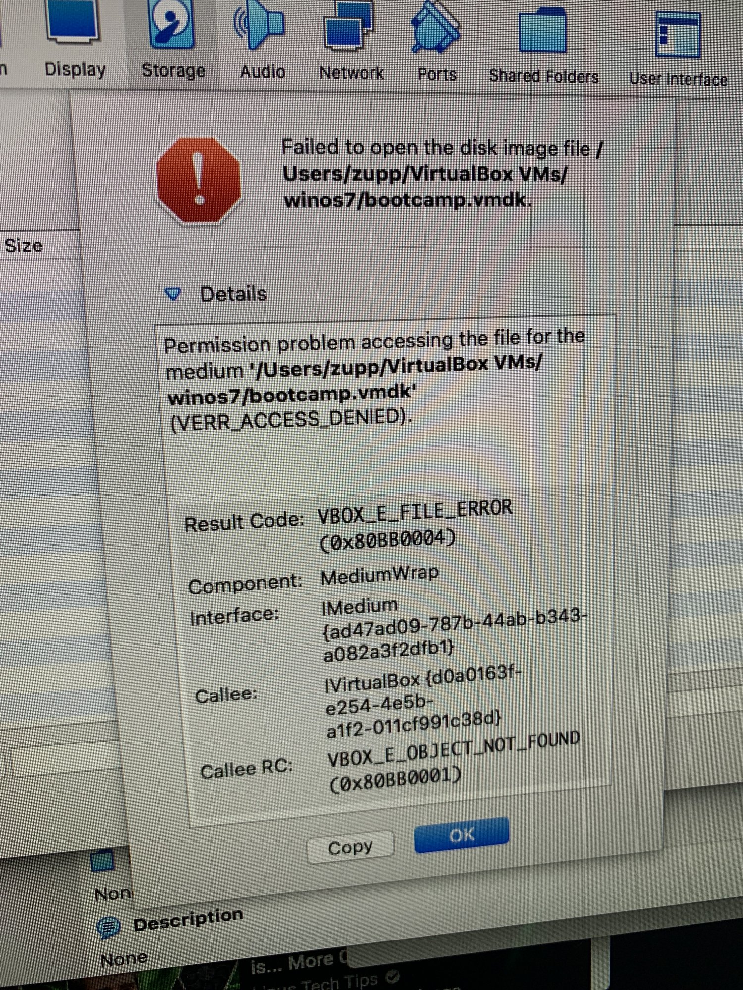

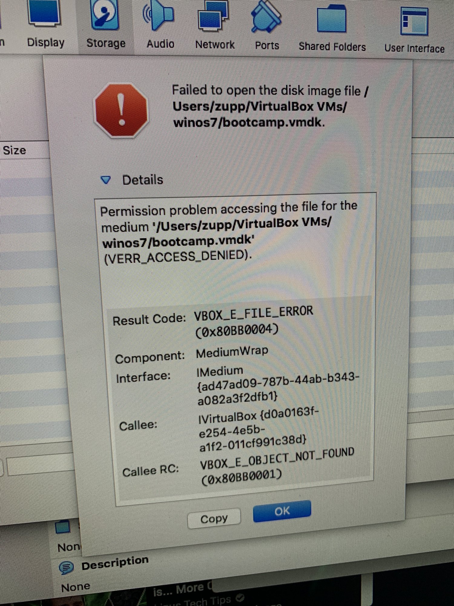

EDIT 2: Tried the VBox method again, I'm getting this error: (third pic)

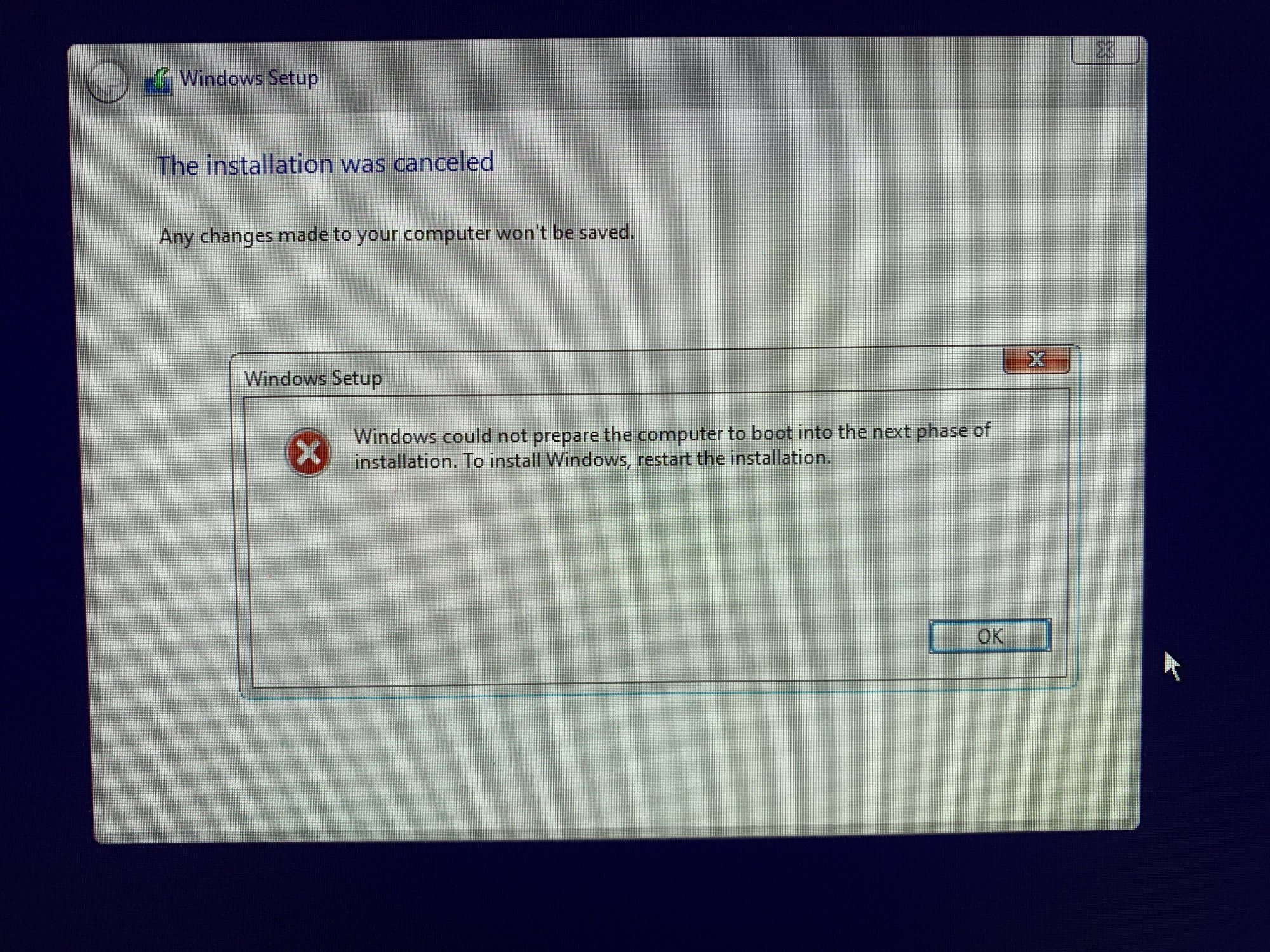

EDIT 3: Managed to get the partition to work ( formatted as NTFS with Tuxera ) but now I get the "disk is of the GPT partition style" error....
EDIT 4: Tried multiple win7 isos on a usb but none of them gets past the "Windows is loading files..." screen. ( I waited around 15 minutes and nothing changed )
