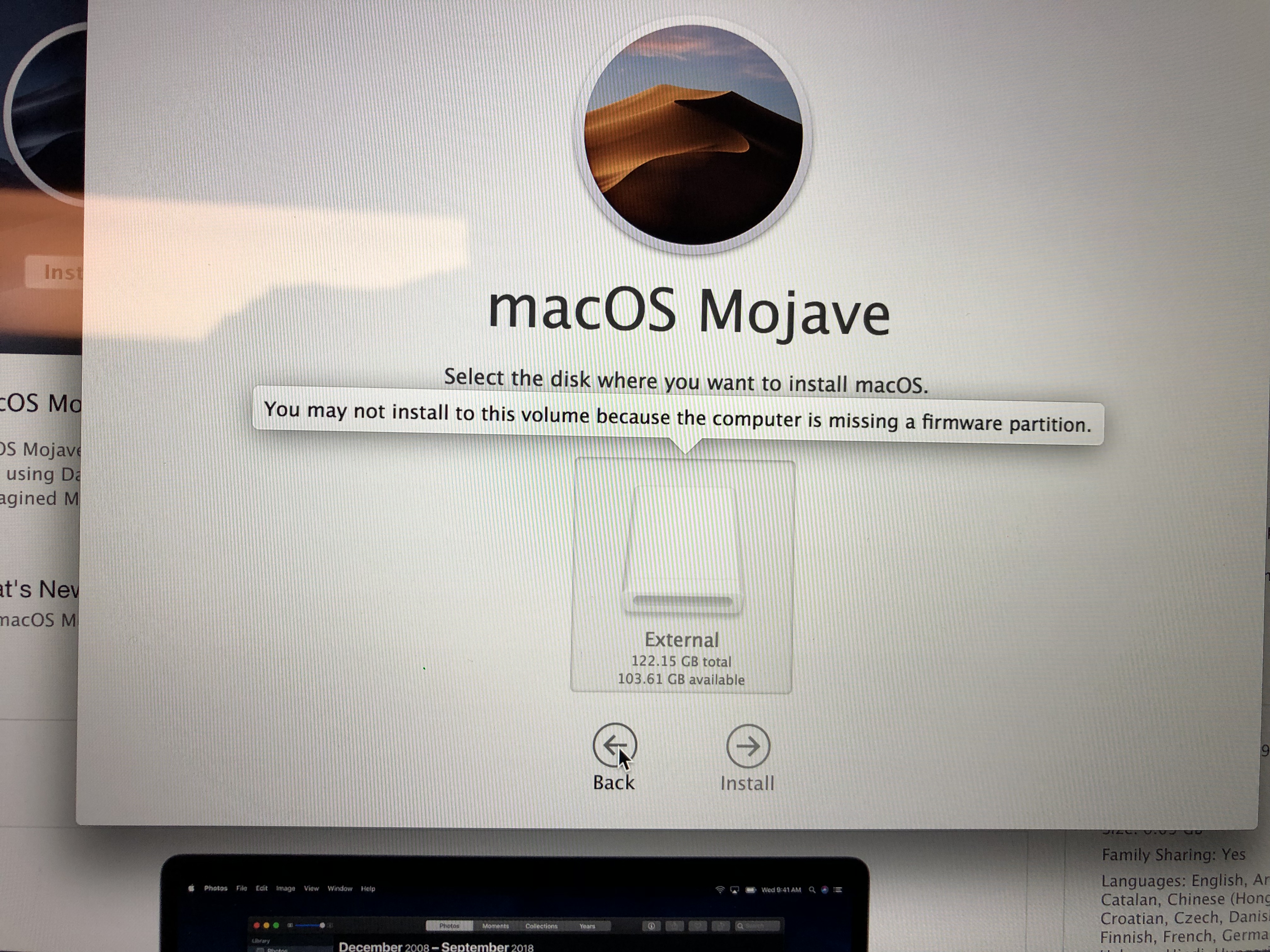

Alright. I was able to get Mavericks to install on the usb external drive. However, when I attempt to install mojave, I get the error that the computer is missing a firmware partition. Now I’m stuck again. Can anyone help?
Once started up with the Mojave installer, you need to first partition your SSD drive using disk utility - you should be able to run disk utility once the installer is started.
In other words: before starting the installation fire up disk utility and partition your SSD. This shouldn't be too difficult (also see: https://www.macworld.co.uk/how-to/mac/partition-hard-drive-mac-3619175/)
Once completed, start the install procedure; this time you should see your SSD

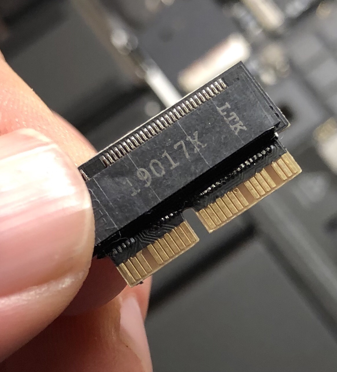

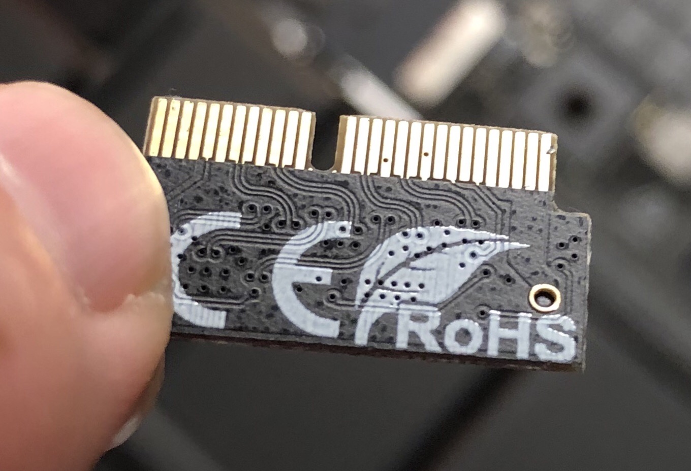

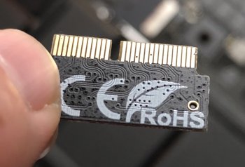

I guess the best approach to follow is to first find out which adapter is installed in your Macbook. Since a NVMe SSD was installed, some sort of adapter is installed for sure, otherwise the NVMe SSD could not even be installed.
Once you know what adapter it is (perhaps post an image or consult the thread mentioned above) we could go ahead from there....
Not much to go on with this. It doesn’t look like the cheap bad one but the pcb looks to be the same configuration as the known good adapters.
Hm... never saw that particular adapter.
Check out this wikipost: #1
Do you by any chance have access to a Sintech adapter as depicted in the wikipost, maybe from a friend? My first guess would be you have a faulty/incompatible adapter. In any case, mentioned adapters are not that expensive (around 20 bucks)

I went ahead and ordered a Sintech adapter. I figure at this point, I’ll only have $75 wrapped up into it and if it doesn’t solve the problem, I’ll hunt for an Apple drive. I’ll have an update on Sunday.
Got my authentic Sintech adapter today. Looks identical to the one I pulled out. Down to the black pcb and numbering on the plate. The only difference is that it appears to have better insulation on the side where it plugs into the oem socket. I’ll give it a try and pray. Pray with me.

Glad to hear - so assumingly the adapter caused the issue?
Be careful with torrented systems though, you never know what you're buying 🙂
Honestly i don’t think it was the adapter. I kept having the same issues after installing the new one. When I look back at the whole process, I think my original bootable usb wasn’t formatted correctly.
