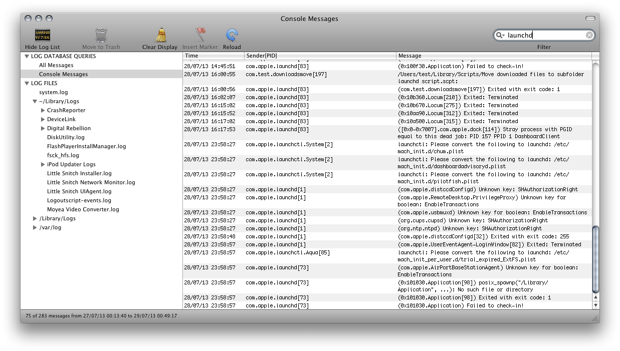

Other thing to check if he used launchd is the Console application. Open the Console application and do a search and filter for launchd. See attached tumbnail. Post a screenshot of that as well.
