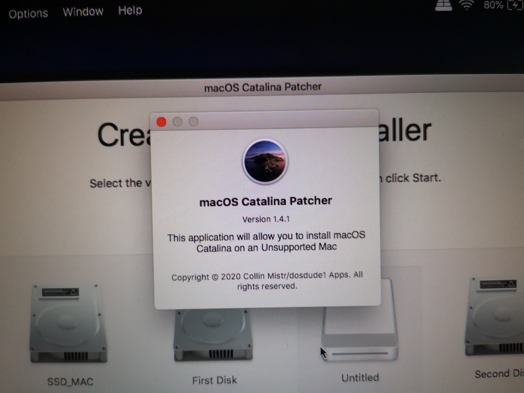

- My version of macOS Catalina Pacther is 1.4.1

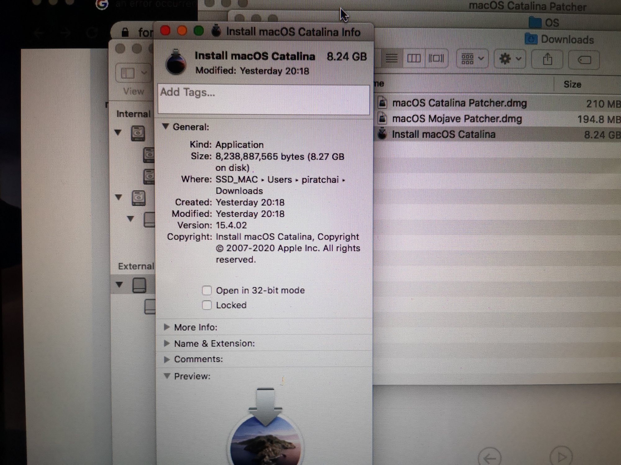

- My version of Install MacOS Catalina 15.4.02 (Download via macOS Catalina Patcher)

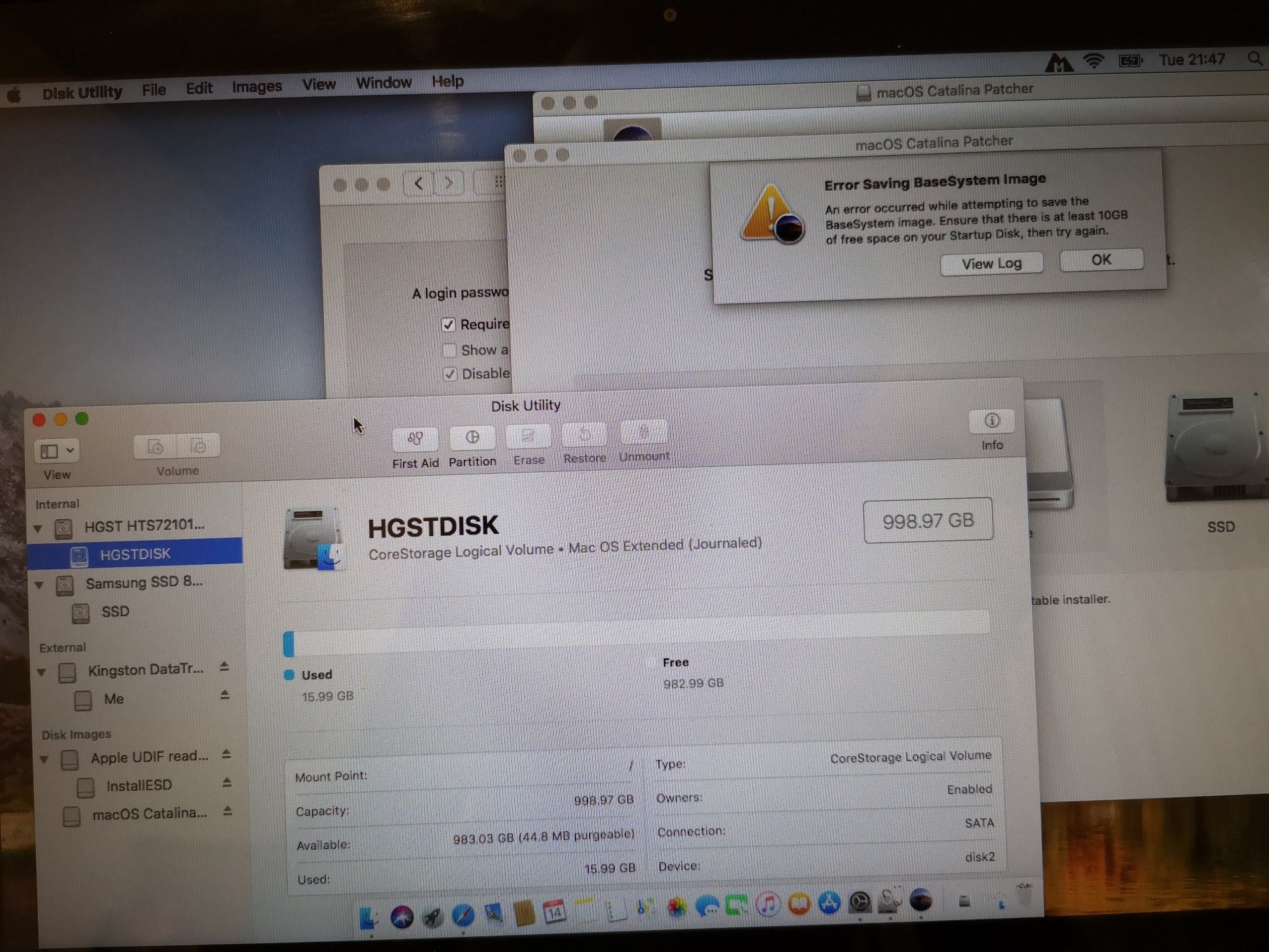

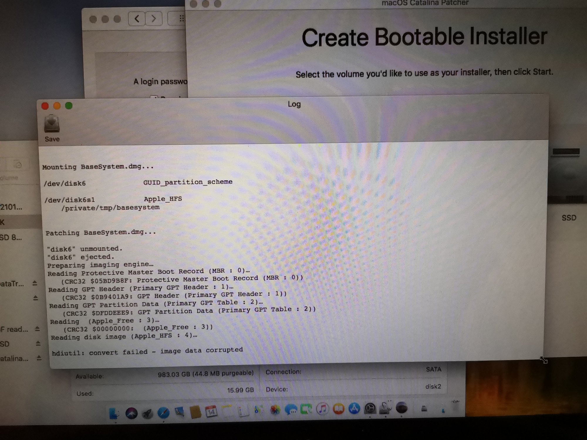

When i click start to burnning file into my usb flash drive, i found this message in picture below.
** An error occurred while attempting to save the BaseSystem image **

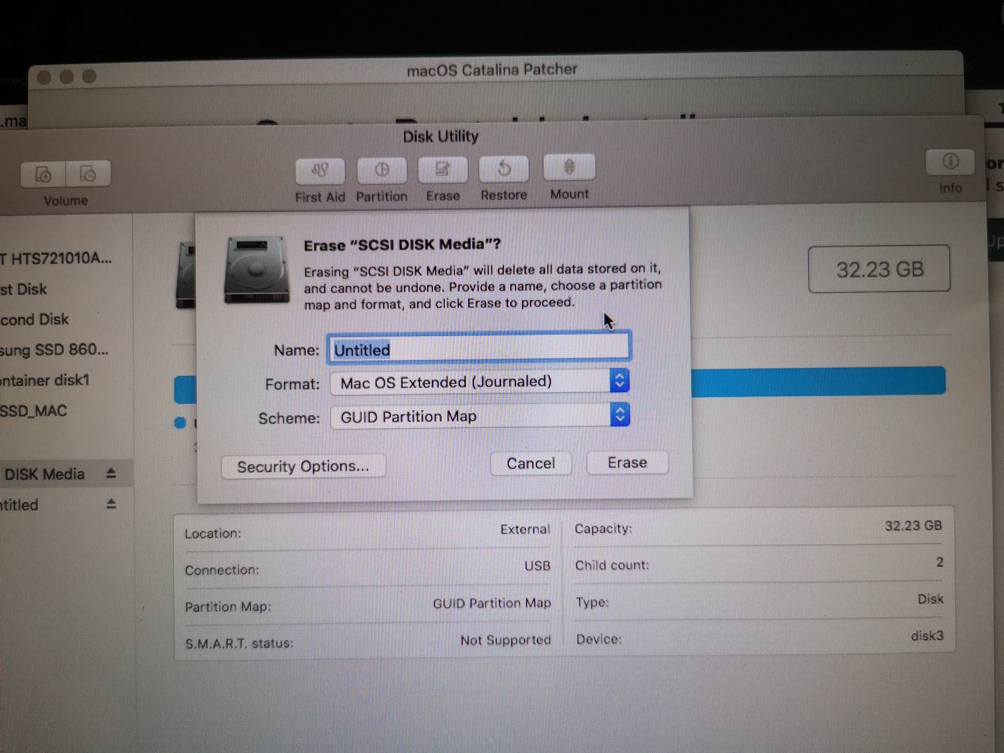

Actually, my usb flash drive 32 gb.
it should pass...
My log
My USB Flash Drive
My format USB Flash Drive

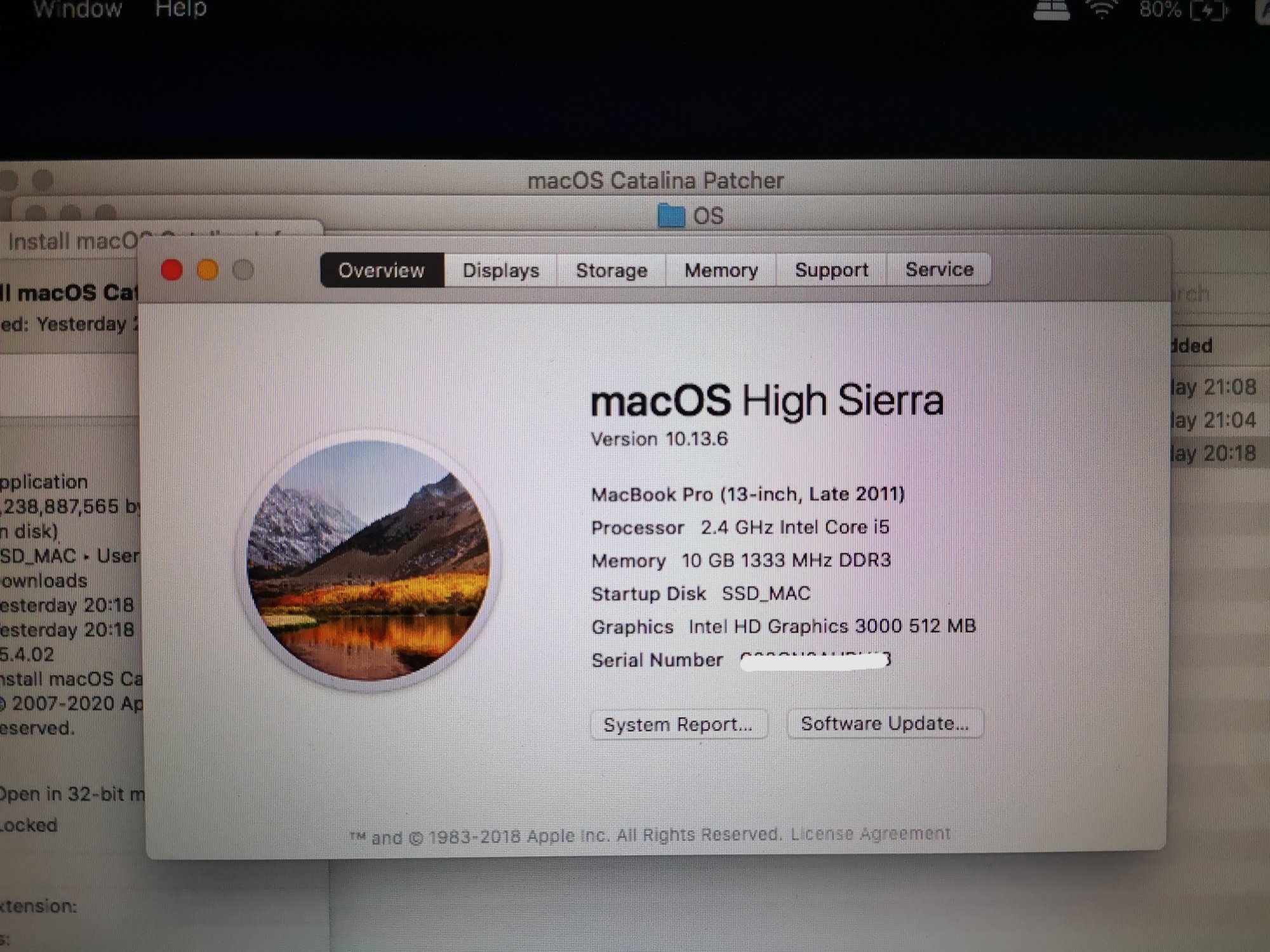

My Macbook spec

I try to switch booted drive from ssd 250GB to hard drive 1TB.
I still give the error message about 10GB.

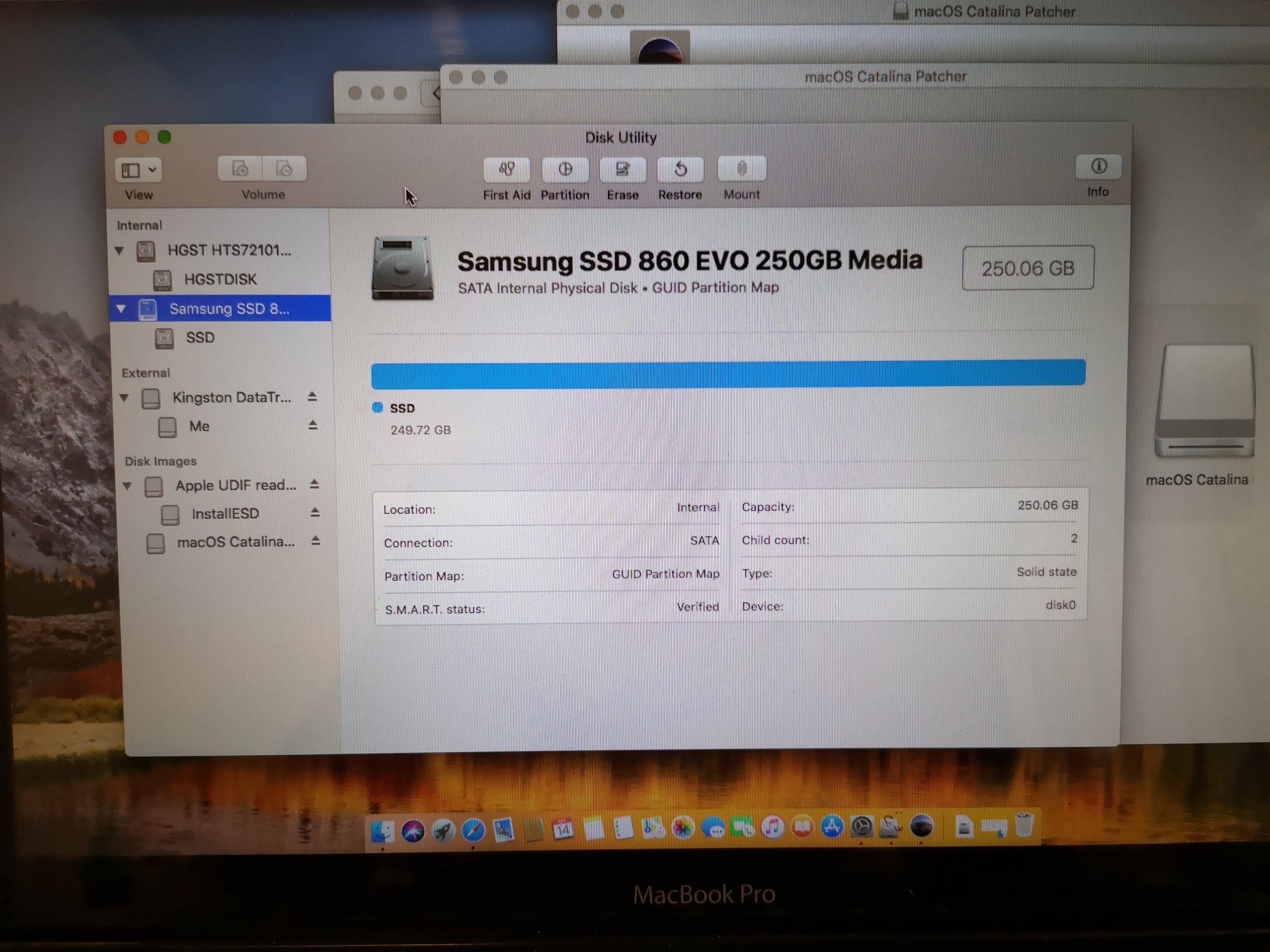

Don't see that model on the catalina compatibility list:
That's the point of using the patcher :)
@noopmac Catalina in not great on suported Macs, maybe stick with Mojave.
I never used the patcher, but the error message seems to be about your Startup Disk, not your USB flash disk.
So, enough space on HGST or Samsung SSD, whichever one you have booted from.

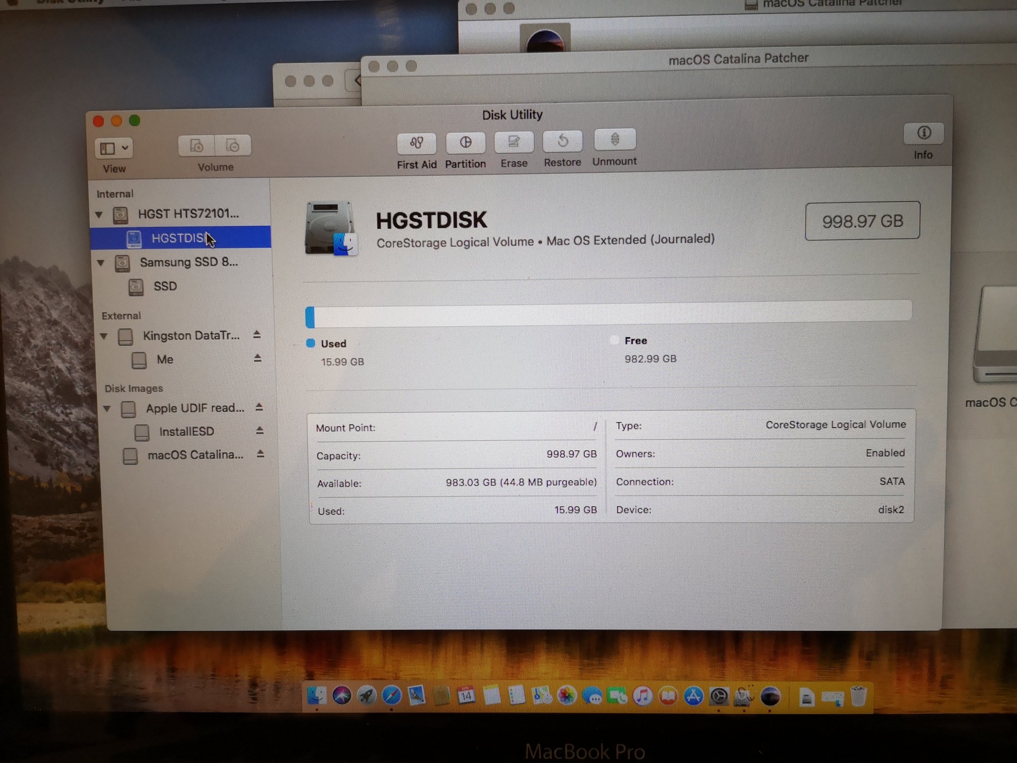

Hi, MrCorovic
I try to switch booted from my hard disk 1TB and i not used ssd to booted drive.
it still warn me about 10 GB.
My ssd
[automerge]1586916008[/automerge]
Updated

Update .... 17/04/2020
I successfully,
I remove Catalina installer file, and i download it again. And Try to installed.
It was worked for me.
Thank you.
