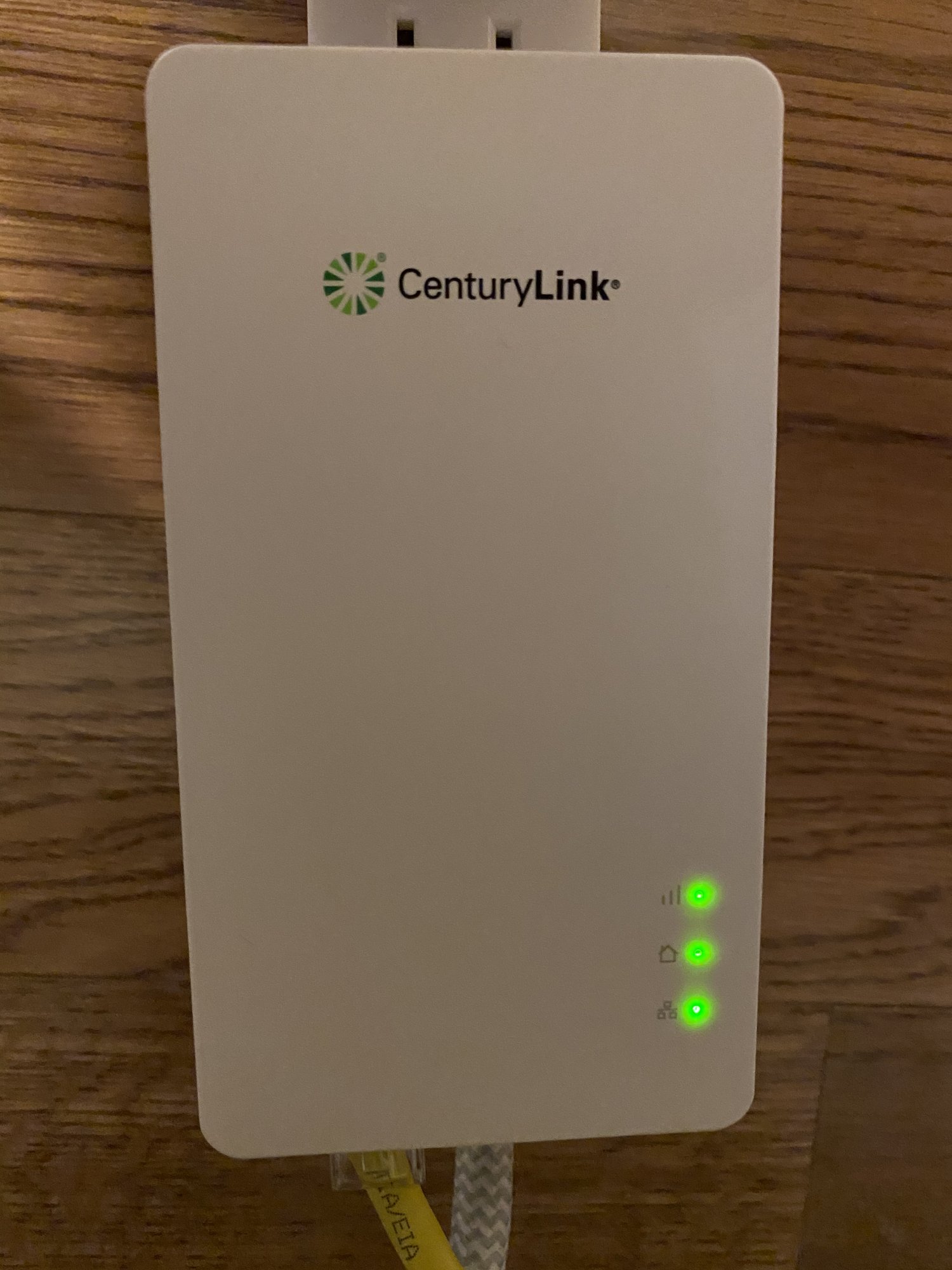

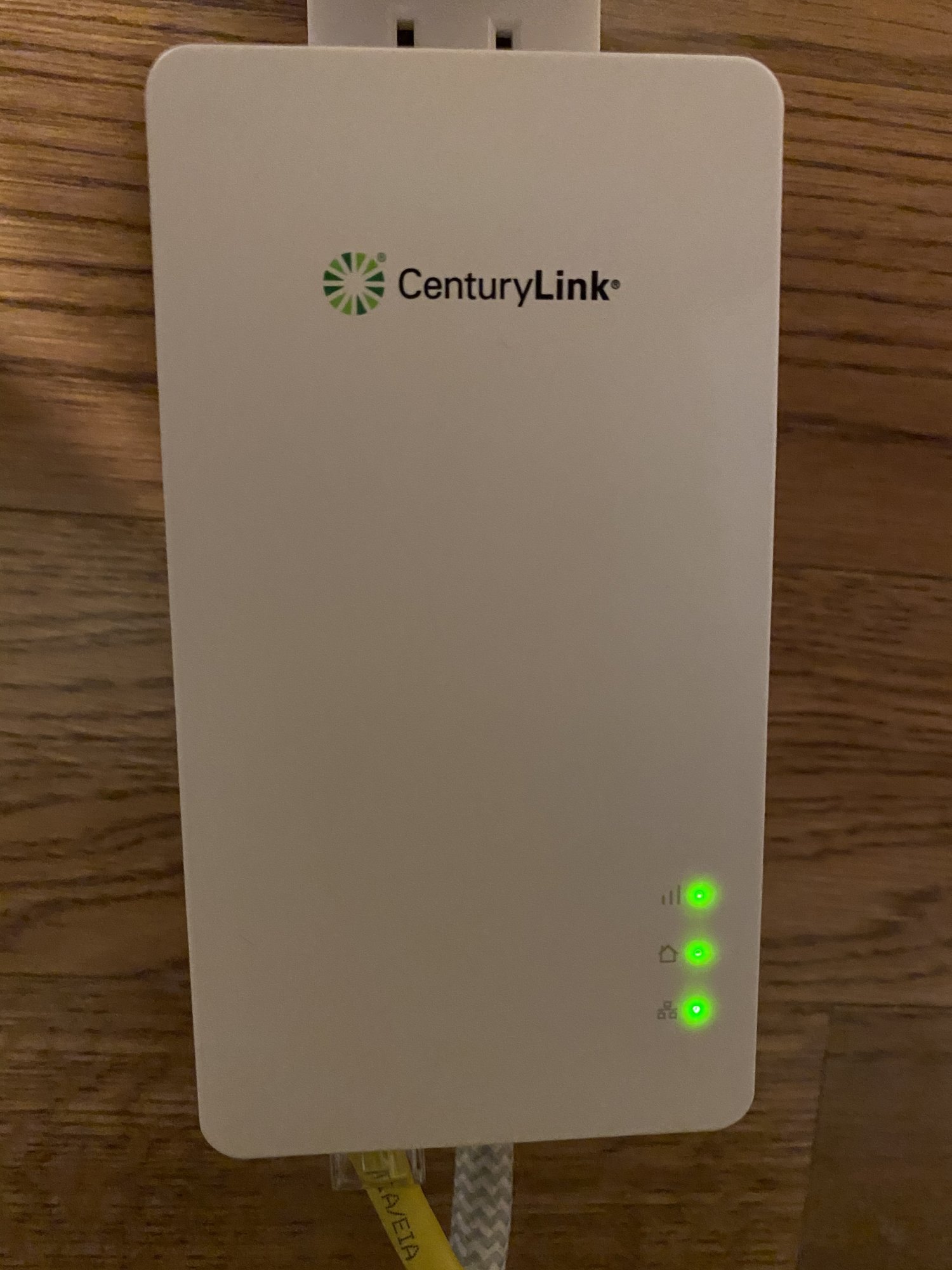

I bought a WiFi extender from Centurylink. It comes with 2 boxes. There’s one (WF-802G) that connects to power and and Ethernet cable that attaches to the modem.
Then there’s a box (WF-802GW) that you plug in to power and gives better WiFi wherever you want it.
All 3 lights are green on the base unit (802G) that’s connected to the modem as seen in the attached picture.

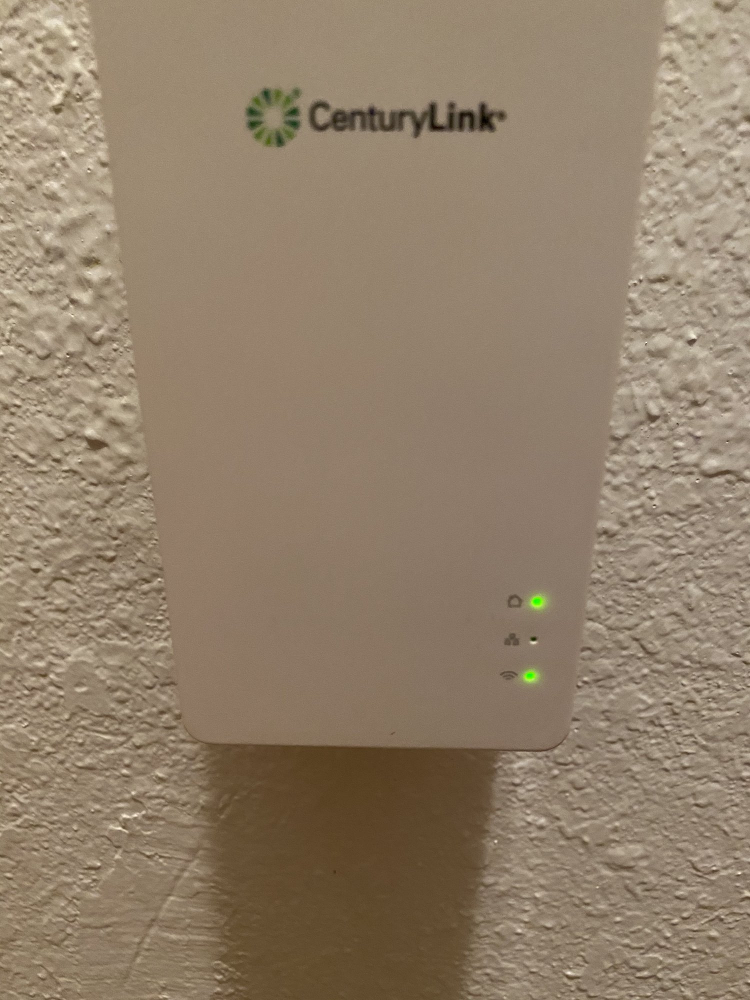

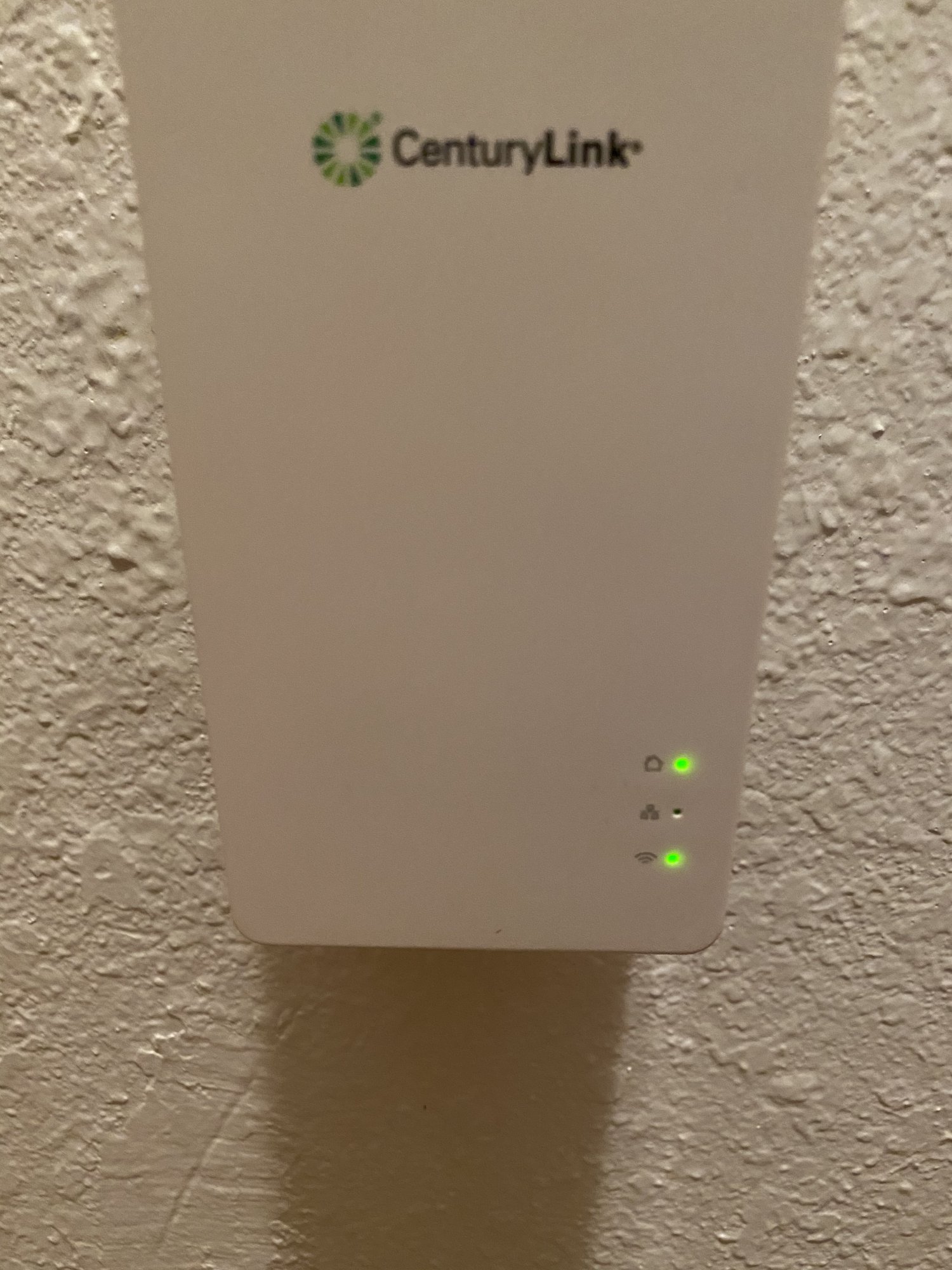

Only 2 lights are on and green on the wireless unit (802GW). I’m wondering if this makes sense? I’m thinking maybe, because I think that’s an Ethernet light and it’s not connected to Ethernet obviously because it’s receiving a wireless signal. Centurylink was useless.

I think, based on what you said, and looking at the devices, the 802GW is not receiving the ethernet signal over the powerline, but it's got an active WiFi broadcasting - i.e., it's not receiving WiFi, it's available as a WiFi AP, but since it's not getting a network connection over the powerline, it's inert.
I'm assuming you can connect to it (the 802GW), but you're not getting internet access.

It's a wireless AP (access point) that uses a powerline as the network:
Modem/Router >> 802G >> power outlet 1 == power outlet 2 >> 802GW >> WiFi signal >> [WiFi devices]
The problem is probably the ==, i..e, the connection across the power line, that's extremely contingent on the wiring, etc.

But to clarify about this system. There’s an Ethernet cord that runs from the modem to the base unit. Then, you are supposed to plug the second unit in to an outlet in an area where you want better WiFi signal. There’s no Ethernet cable that hooks up to this unit. There’s an Ethernet output of you want but I just want better WiFi on one end of my house.
So, the base u it has all three lights lit up green. The second unit only has two that are lit up green. I’m wondering if this means it’s working properly or not. I think the light that’s missing is an Ethernet connection light, so it makes sense to me that it’s not lit up. But the instructions don’t say anything. They are very basic.
Basically, I’m not sure if it’s working or not. I’m connected to my network but I’m not sure if this second unit is actually capturing the WiFi signal and extending it. I’m thinking not because my WiFi signal drops a bar like usual when I’m in the back rooms.

You're correct about the GW indicator lights, that Ethernet light is just to show an active wired connection on that end, the Home indicator is the powerline "handshake" showing it's connecting to an active powerline (i.e., ethernet over electrical wiring).
Here's the same product, different branding:
Looks like a solid green G.hn (i.e., "House" indicator), means it's on the powerline network, and communicating as expected.
I'd assume there's a unique SSID broadcasting from the extender/AP.

Looks to me like "the middle light" is for ethernet.
If it's NOT connected to ethernet -- no light.
