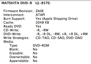

Can someone please confirm that the superdrive in my MBP can burn dual layer DVDs? (Is it the '+R DL' I'm looking for??
Also, can anyone recommend a type (brand) of dual layer DVD that works with our superdrives? Thanks.
Yes - you can burn dual layer (both +DL and -DL format)
I recommend Verbatim and burn at as slow speed as possible....
