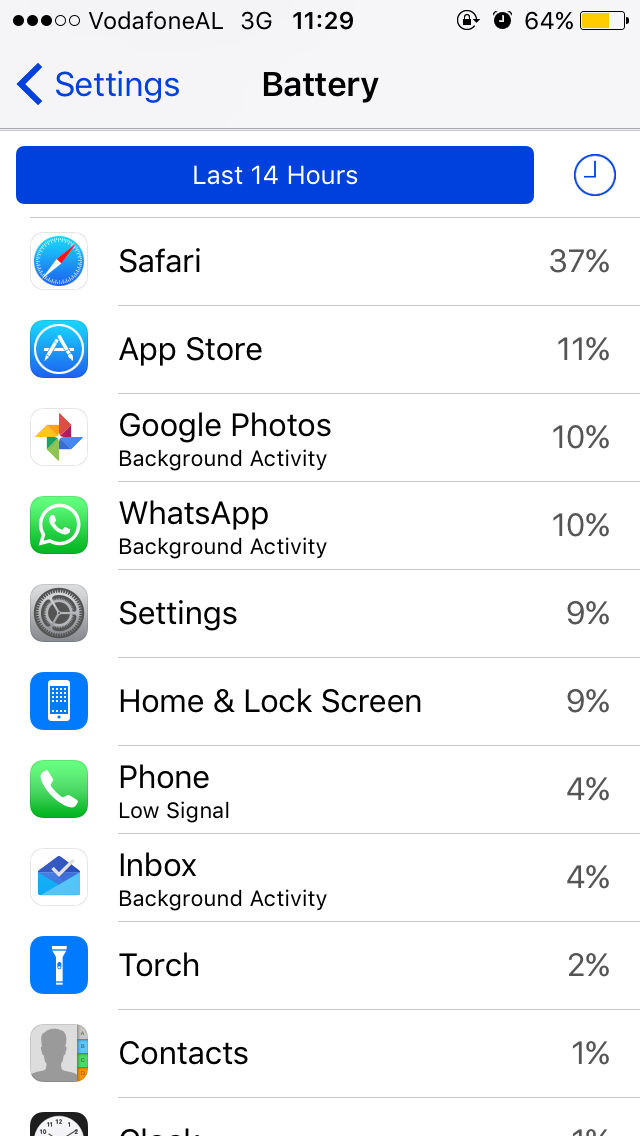

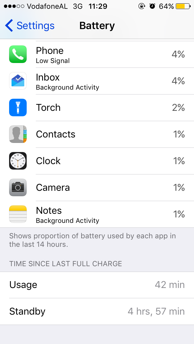

Well, leaved it during all night to charge, woke up at this morning at 7, normal use, and as you see from the attached files, at 11.29 AM is at 64% with 42 minutes of use and only 4 hours and 57 minutes of standby! So, I don't think this is normal!! At least for a new battery with 0 cycles and full capacity of 104,30%! I'm loosing it, very upset, knowing that even the new battery didn't resolve the issue!
