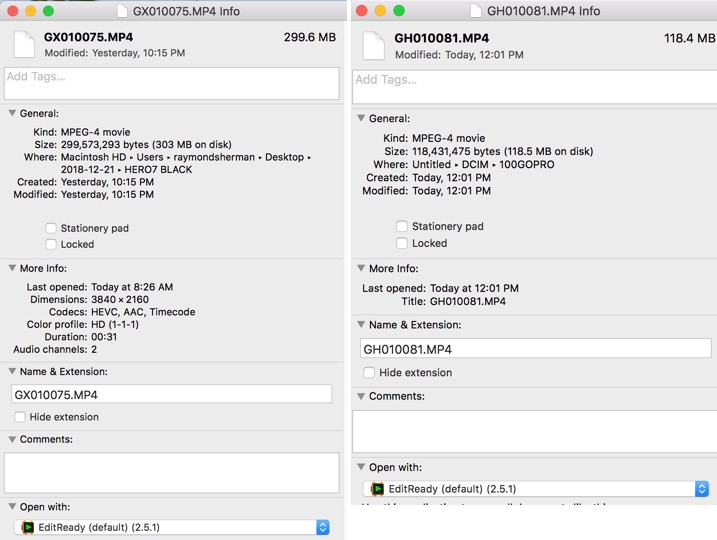

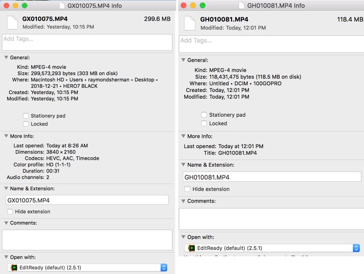

I'm having an issue with my GoPro Hero7 Black folder information not showing video codecs within Finder. The following are my actions directly from my SDXC card once opened within Finder;
Click on video within the folder > Right click on Get Info. and the Info window opens
I opened this same video yesterday which showed my video codecs under "More Info" as shown on the left below. I opened it up today in the same manner (on the right below) and now it doesn't show codec information, dimensions, color profile, duration, etc.. Also, as you can see below, the left Info window was grayed out compared to the right Info window. I restarted my MacBook Pro which gave me the same results as the right screen shot. I re-formated my SDXC card in camera and took another video which still gave me the same results as the screen shot on the right. If anyone has any idea for correction, I sure would appreciate it. Thank you. Ray
The Where item in the window on the right shows "Trash" as the location of the item.
Move the containing folder "2018-12-21" out of the trash and try again.
The Where item is in the General sub-pane, below Kind and Size, and above Created and Modified.
Sorry about that....... I did have the screen shot on the left in the trash as shown. I pulled it out for viewing purposes due to being different from that point forward. I'm glad I didn't permanently delete otherwise I would have a harder time explaining my problem. I just pulled the left one out of the trash and took a new screen shot. I also just re-formated my card and took another video. Information on the new video still lacks the codec information, etc. for some reason. Thanks for the help. Ray

I opened the SDXC card called Untitled from my desktop. I then dragged the video file onto the desktop which was a copy (video only). Checked "Get Info" and there it was under "More Info" showing everything codecs, dimensions, etc.. As for "Where" it shows Macintosh HD.
The codecs, dimensions, etc. "do not" show up when checked within finder from the SDXC card Untitled using "Get Info" There's nothing under "More Info" As for "Where" it shows Untitled-DCIM-100GOPRO
I must say this is very interesting. The missing link for getting this info. straight off the card must lay somewhere within the System Preferences. We're getting closer...... I sincerely appreciate you taking the time in helping me out. I have to go to a Christmas party right now but, I'll check back later tonight or tomorrow. Thanks again! Ray

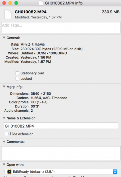

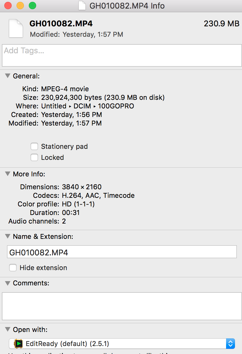

Awesome!! I checked and everything working as it should. I do have a question; Will I have to do this same procedure with other readers and/or S Cards? In either case, I will definitely file this procedure for future reference. I can't thank you enough for your time and help in getting this resolved. Hopefully from this point forward indexing will be enabled. Thank you!! Ray
