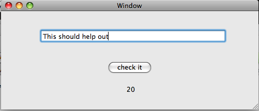

Use this, it will work.
AppController.h
Code:
#import <Cocoa/Cocoa.h>
@interface AppController : NSObject
	IBOutlet NSTextField *input;
	IBOutlet NSTextField *output;
-(IBAction)checkIt:(NSButton *)sender;
@end
AppController.m
Code:
#import "AppController.h"
@implementation AppController
	NSString *string = [input stringValue];
	NSInteger count = [string length];
	[output setIntValue: count];
@end
attachment.php

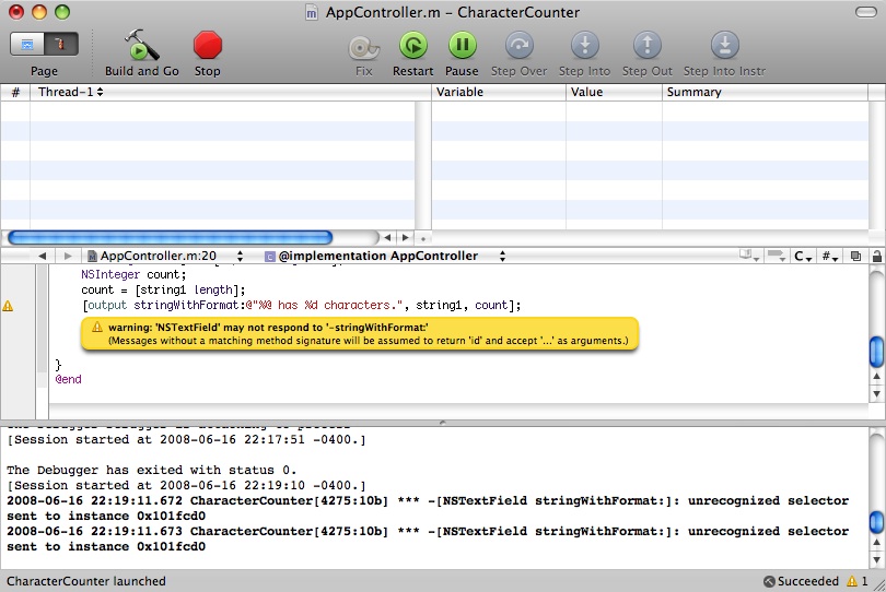

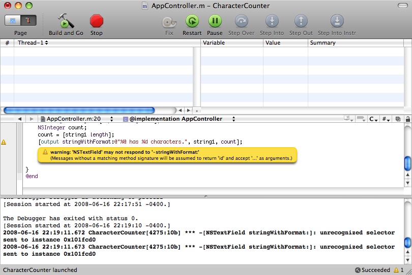

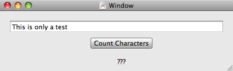

How to I get the output to display as: 'This' has 4 characters. - as opposed to just 4. Here is my new code.
Code:
-(IBAction)countIt:(id)sender
	NSString *string1 = [input stringValue];
	NSInteger count;
	count = [string1 length];
	[output stringWithFormat:@"%@ has %d characters.", string1, count];
@end
Attached is the debugger with the warnings and the error.

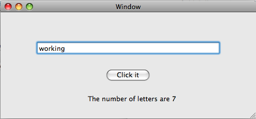

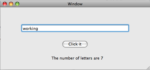

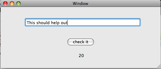

Remember that stringWithFormat is a class method, so when sending your message you need to call the class, in this case it is NSString. So change your .m file to look like this.
Code:
	NSString *display = [NSString stringWithFormat:@"The number of letters are %i", count];
	[output setStringValue:display];
and you should get something like this. I hope this helps.

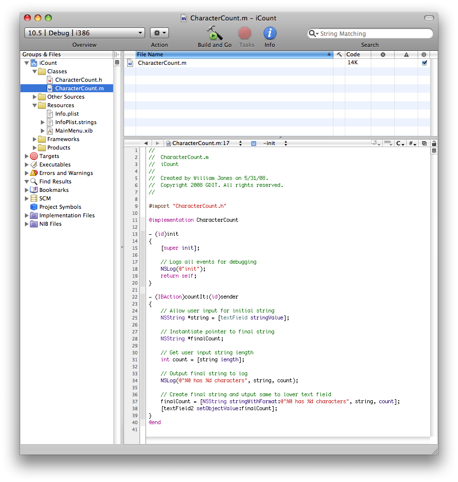

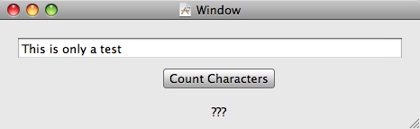

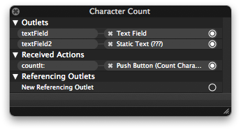

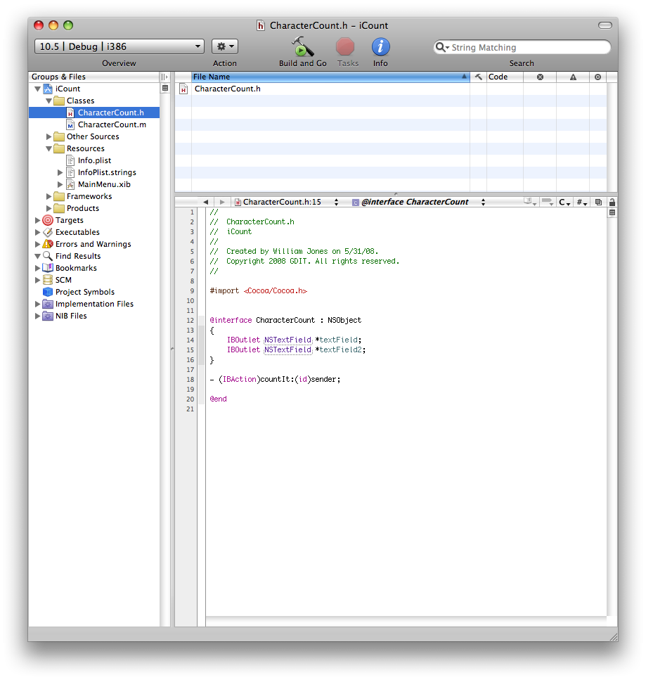

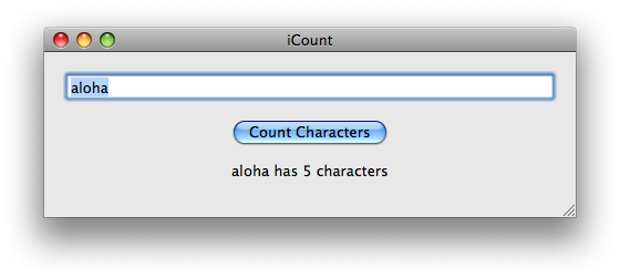

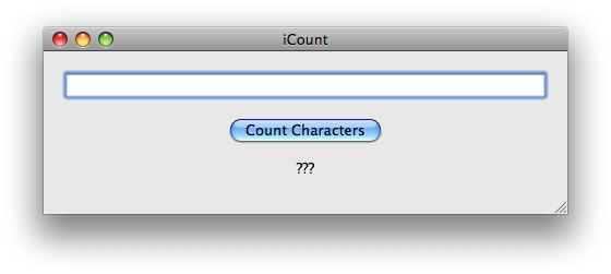

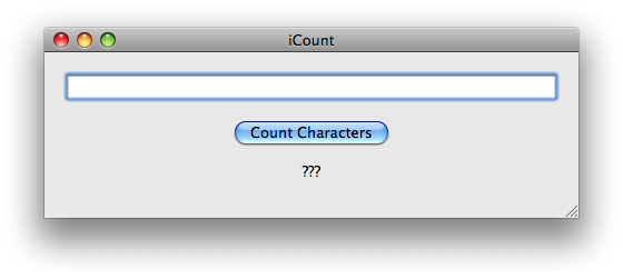

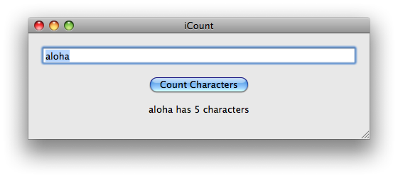

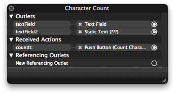

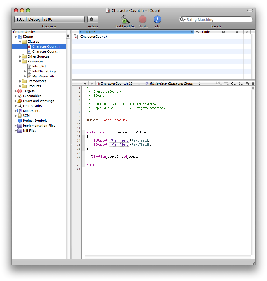

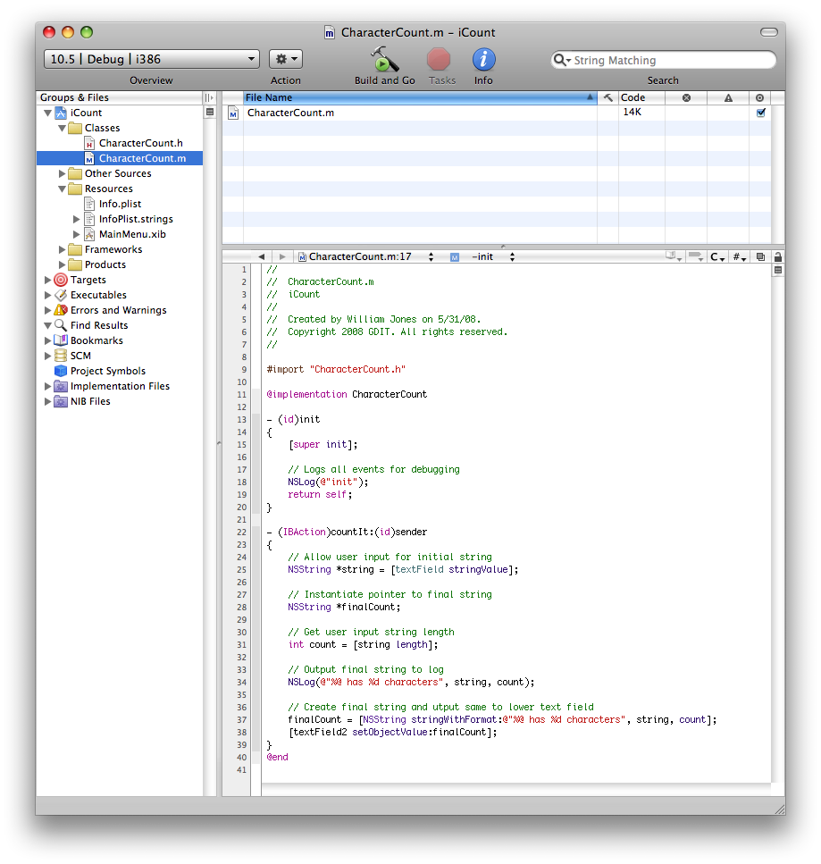

Aloha everyone,
Your solutions seem so much more elegant than mine. I have only been coding with Obj-C since I got Aaron Hillegass' book, however 😀 Anyway, here's how I solved the challenge.
On my .xib file, I have two text fields (one is a label) - textField (for user input) and textField2 (the label showing the results of the app) - and one button. I've included screenshots of the connections to my object, my .h and .m files, and the window both before and after one run. My code is a bit longer than what's been offered - I guess part of being a good coder is achieving the same results with less code.
HawaiiMacAddict

Thank you all for your solutions.... but can you explain the difference between class and instance methods (or in this case, the stringWithFormat method?) Since it's a class method, you had to initialize a "special" instance of a string, right? But why? Is it because there is no instance method stringWithFormat?
Here's the best way that I can think of to explain the difference between instance methods and class methods. An example of an instance method is length. You call count on the particular instance of an NSString to find out how many characters are in it.
Code:
int i = [myString length];
A class method is usually something that returns a initialized instance of a class. In the context of your question, the stringWithFormat method returns an initialized NSString with the format you specify. stringWithFormat would make more sense to beginners if it was called initStringWithFormat.
Code:
NSString *myString = [NSString stringWithFormat:@"%i", [myOtherString length]];
If you look through the documentation, it's easy to pick out the class methods because their methods all start with a + instead of a -.
Also, not that it makes much difference, but I suck at retain/releases so I tend to nest my coding where ever possible (Hillegas mentions this very early in the book, but doesn't use it for the most part). So instead of doing something like this:
Code:
finalCount = [NSString stringWithFormat:@"%@ has %i characters.", string, count];
[textField2 setObjectValue:finalCount];
I would do something more along the lines of this:
Code:
[textField2 setStringValue:[NSString stringWithFormat:@"%@ has %i characters." [textField1 stringValue], [textField1 count]]];
So in order to create a string that uses the string in the textfield, and the integer count of the textfield, you must initialize that string first before you set the output to display the results. But why must you use setObjectValue instead of setStringValue? Also, would this work in NSTextView- would NSTextView count as an instance of NSTextfield? Also, how would I count words instead of characters?
I didn't realize it said setObjectValue everywhere; setStringValue is correct for one of them...setObjectValue is right for the others. If you're creating a string and then setting another string equal to it, setObjectValue makes one object equal to the other. setStringValue sets the string value of the NSString * equal to a particular character string. Anyway, I fixed my earlier post so that all the statements are correct. As for the other questions, NSTextView can't be an instance of NSTextField. However, they do both inherit from the NSText parent class, so it just depends on where the count method is implemented. I'd be willing to bet that NSTextView has the same method, but I don't know for sure. I also have no idea about counting words, but I'm sure it can be done.
