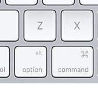

If you download the DMG, you need to use Disk Utility to restore the image to a USB drive.

Don't have that. I have fn, ctrl, then a funny shape with alt above it then cmd then space bar

got it thanks
I've never seen a Mac keyboard without an option key. That key with the funny shape may be the equivalent of the option key.
What is the keyboard's language; i.e. UK, Arabic, etc.?
It's the "alt" key. Marked with alt, and either the word "option" or a strange symbol.
