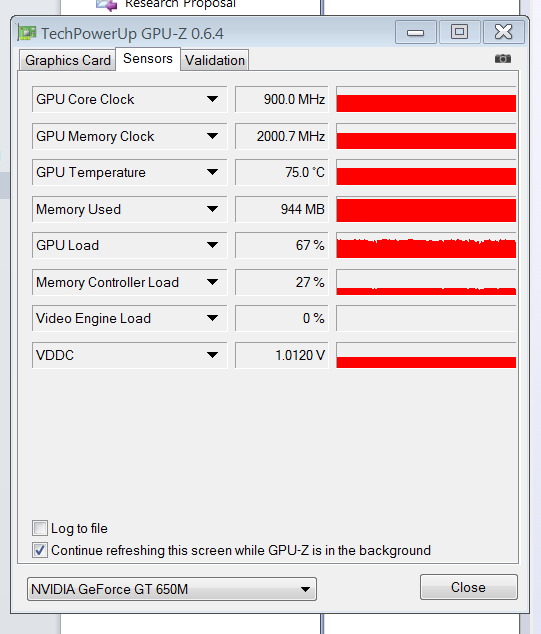

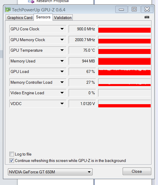

I've been playing Civilization V for the last week without any problems. Using GPU-Z, the 650m is running at full speed (900MHz/2000MHz).
Why don't you download that tool and use the log option to see if your GPU is working properly.
By the way, GTA4 is widely known to run poorly on PC, so I'd not use that game as a benchmark. I can't get the fps over 40 with with desktop computer at 1900X1200 using HD7950.
P.S. You are playing the game with the machine plugged in to the main power and have good ventilation right?
