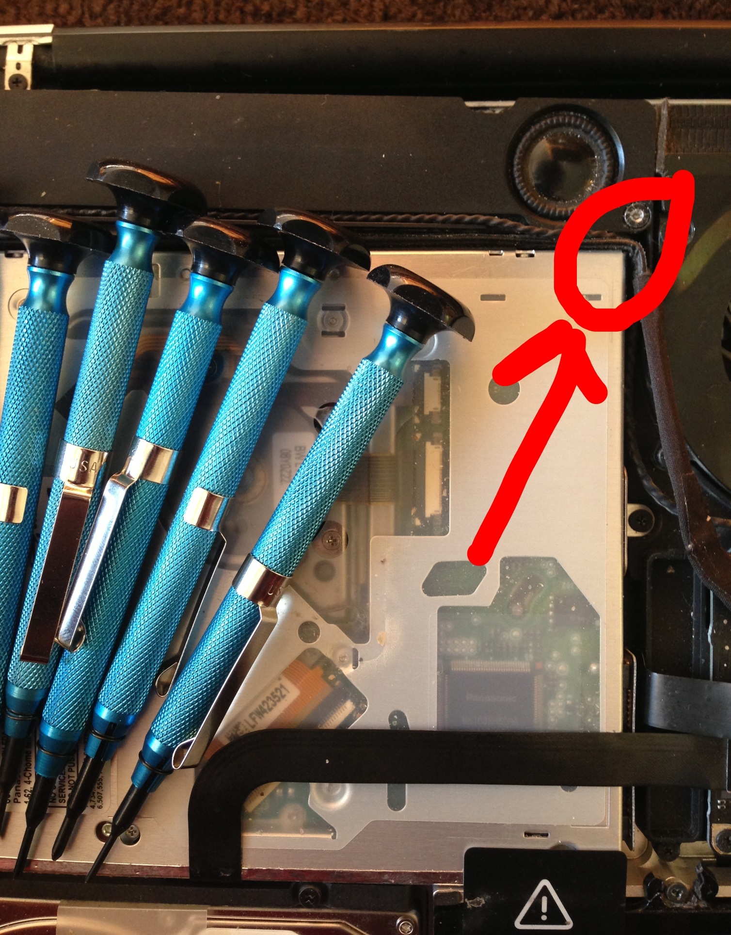

Hi everyone,
So I have the same problem with my MacBook Pro 13". Stripped the 5mm Phillips screw on the superdrive (shown in the pic) badly
Ordered the moody extractor set mentioned and it's been no help so far. Maybe I'm not using it right or I don't know which extractor is right
Any one help please???
So stripping screws happens all the time in the world of remote control helicopters - and one dude posted a fix that I have never had to try myself... but I'll pass it along in case it may help you.
He took a dremmel tool and put the thinest cutting tip on it he could and then used the dremmel to create a slot through the top of the screw head (so he could use a a standard slotted screwdriver). The trick, of course, is that there needs to be enough material in the head of the screw to provide enough torque without breaking off 1/2 the head of the screw.
Use at your own risk - but it looks like your getting to "try anything" mode.
