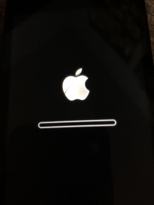

I was restoring my 4S to iOS 6.1.3 through iTunes with DFU mode and now I'm stuck on waiting for iPhone to respond with apple logo and empty bar??
I'm on latest version of iTunes and using genius Apple cable.
Any way to fix this?

I can restore it to iOS 9.3.5 successfully, but it stucks on waiting for iPhone to respond when I try to restore to iOS 6
Not sure what's happening?
My 4S is new and never repaired.
You can't downgrade anymore. Apple's new security feature to prevent it. All you can do is go up.

Someone doesn't realize that once an iPhone went up in OS version, it can't go down unless you have a mimicking Apple Server which serves your iTunes an authentication code for signing the firmware you just installed.

No it's not. If it's not letting you complete the downgrade it's because it's not. Also, older software (iOS) doesn't play nice with newer firmware (modem) which can also cause authentication issues.
My old 4S successfully restored to iOS 6 two days ago.
I got another new 4S today which is facing this problem??
Please help I'm stuck on waiting for iPhone to respond!

I know this sounds crazy, but you could try to restore using an older version of iTunes and start from there, as newer iTunes cant play well with older devices with older firmware.
