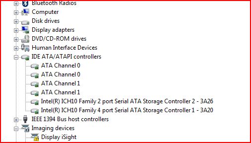

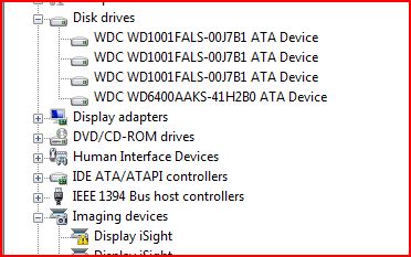

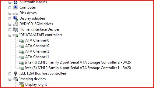

Here is a shot of my ATA controller setup in windows, any pointers guys?

funny thing is the drives, they all say IDE the AAKS is the windows drive, just shown as disk drive, the others just say IDE.

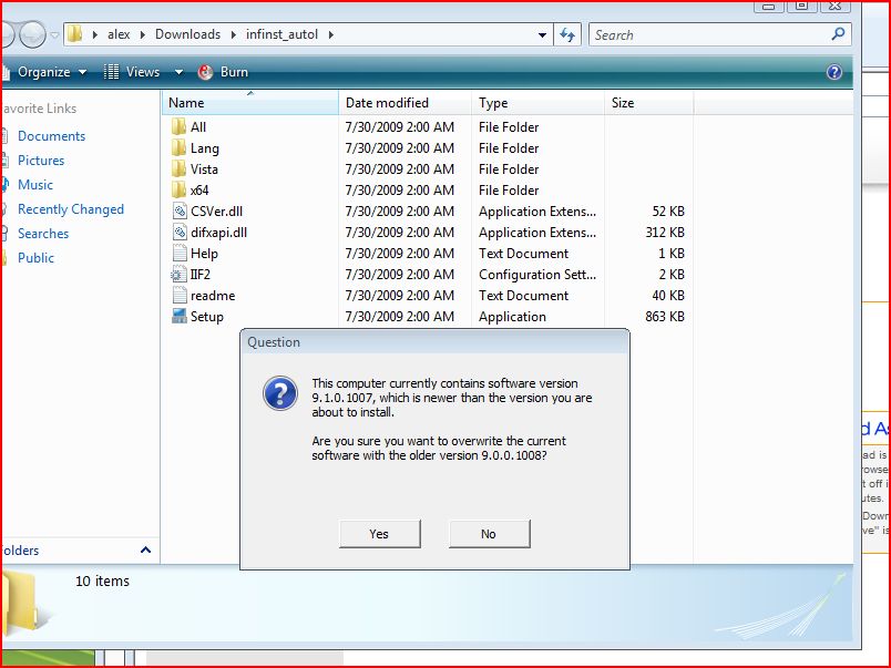

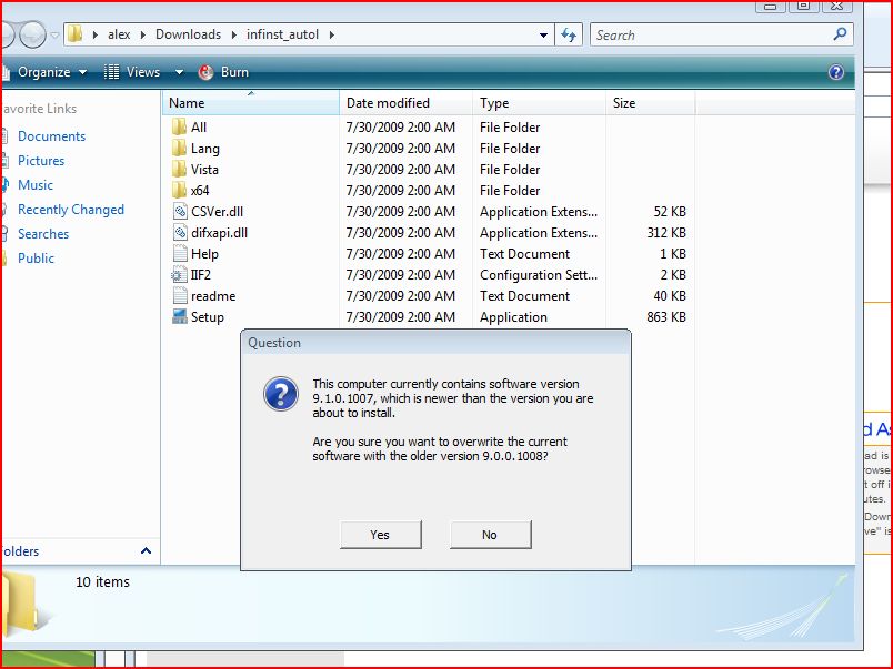

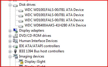

this is the message I receive when I try and install the latest drivers from Intel, they appear to be older than the ones on the Leopard disk. Secondly I have fixed all of the FDISK, loader delay and screen dumps by using easyBCD to repair the bootloader. Im definitely going to bed now, Im in court in 6 hours. Thanks everyone, will be back on it tomorrow,
I believe that the 1009 version is newer than the Apple version from 2007. If Windows misidentifies the older version I would still install the newer one.

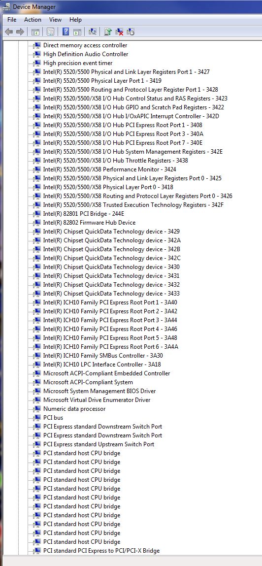

I'm glad your Vista is running ok now. Could you post a pic how the device manager looks? I have never seen Vista 64 on a Nehalem and would be interested to see the cores, graphics, SATA and the hard drive. A screenshot with those items would be nice. I believe your Vista is now running with the 9.8 AHCI driver?
I have been reading up on the AHCI installation for 2009 Mac Pros. There are some differences in the Chipset compared to the 2006,2007, 2008 models. The earlier models had a 5000 type chipset which treats all 6 SATA port in one device driver. The 2009 MP has a 5520 chipset which has separate devices for the 4 HD SATA parts and the 2 ODD SATA ports. You may have noticed that in your device manager. So consequently you have to install the AHCI drivers twice. The patching should only be done once though.
I can't even get them to install once, thats the problem, it says that the system doesn't meet the minimum requirements, or that the file cannot be installed in that way, when you right click and hit install, I am trying to find the right download for the drivers and the install files, so far none of them work,thanks for having a look though,

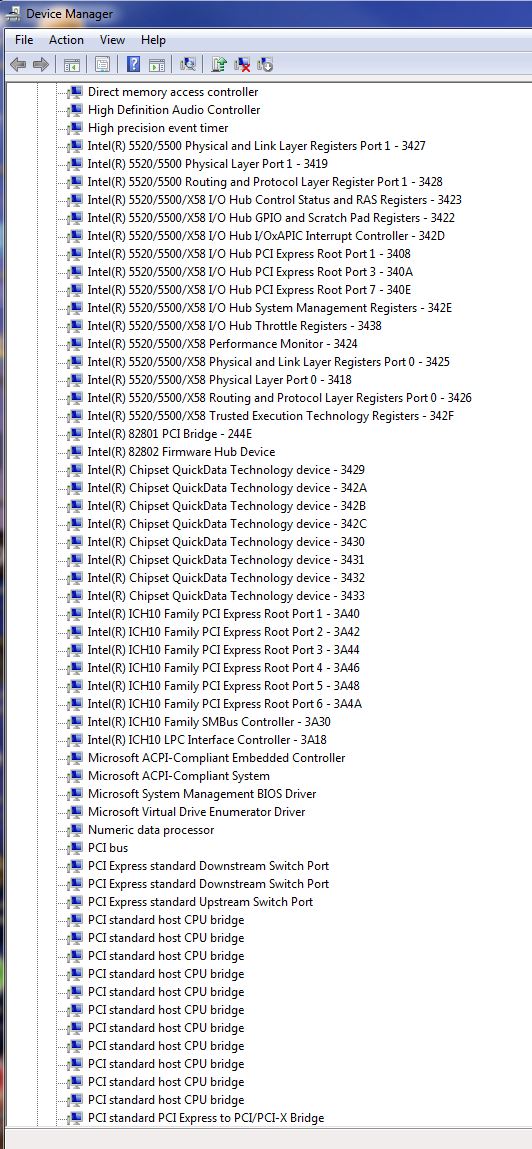

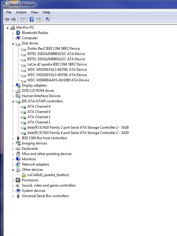

Is your device manager still in the state that you showed in posts #13 and #15? It would help if you could post an actual screen shot with the ATA drives detailed. Also if there are still unknown devices that information may be relevant.

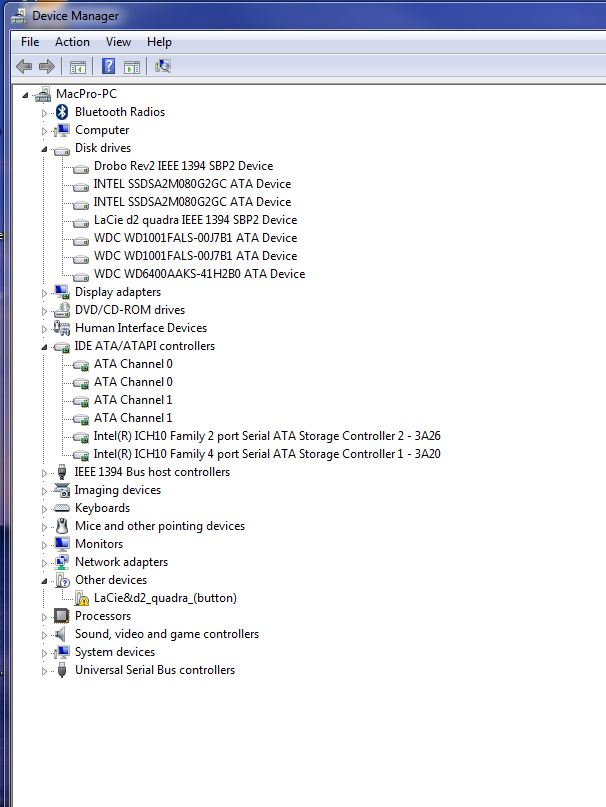

Been very busy with work, anyway here are the latest device manager shots, I have now upgraded to win 7, I upgraded from vista 64 internally, by removing bootcamp services and then upgrading, worked flawlessly, I think my situation is identical now to the other post that is going on,
shall I post here or on the other post?
