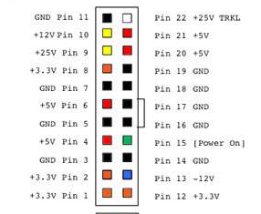

Yes, specifically, you want to test the trickle (or "always on") voltage. Put the black probe to pin 11 and the red probe to pin 22. Leave the PSU connected to the motherboard. Just wiggle your test probes in where the wires are sticking out. Set your meter to DC volts. You're looking for 25V.
Pin 22 is the only white wire, so that's pretty easy to locate. Pin 11 (ground/black) is right next to it on the other side. There is nothing dangerous about this. It's all low voltage DC. And there isn't much that you could do to cause damage to the computer. Even if you hooked up the meter backwards, you'd just register negative voltage (or register nothing if the PSU is bad). You do need to push the probes in there pretty hard so that they make contact with the metal connector.
Here is a pinout:
