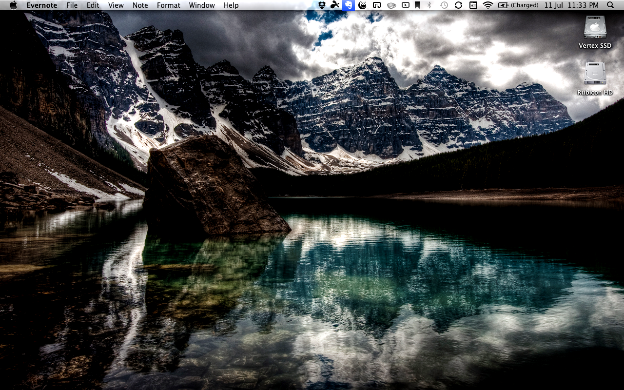

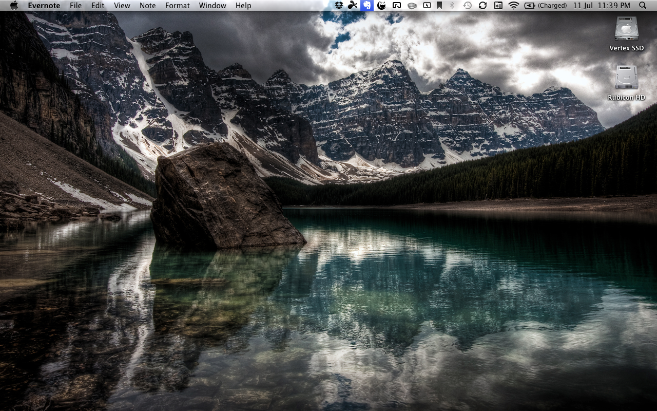

I just took a screenshot while in the darkened state, and then one afterwards, but since the screen was back to normal, so was the screenshot. Both shots are identical.
I edited one of the shots by playing with the levels to simulate the problem. Not 100% accurate, but it gets the point across.
The first is the darkened image, second the normal image.
