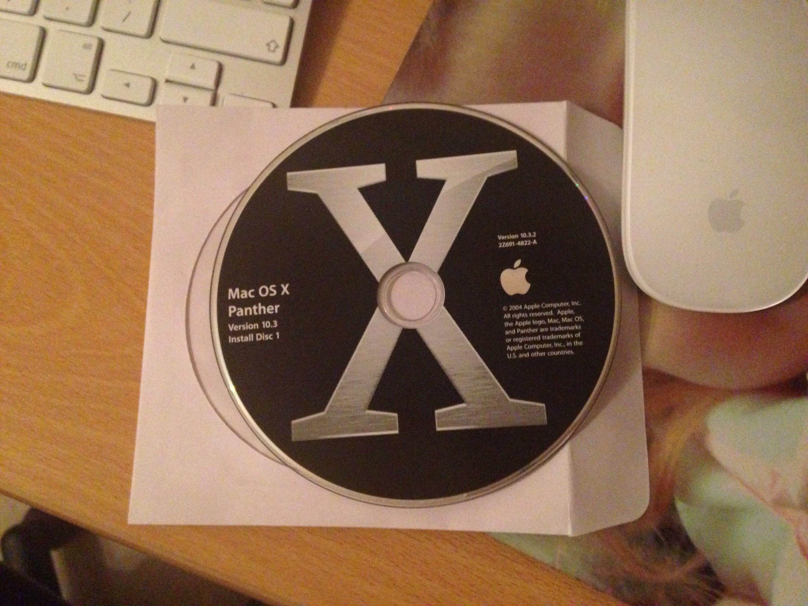

Broken 20" imac G5 non iSight
So if I connect mini to broken imac via FireWire and use TDM and pop the Panther discs into the mini can I install panther onto the broken imac that way

They were when it was working but not external DVD drive, I don't think you can install panthers via USB flash drives
These are the discs I have

Correct
