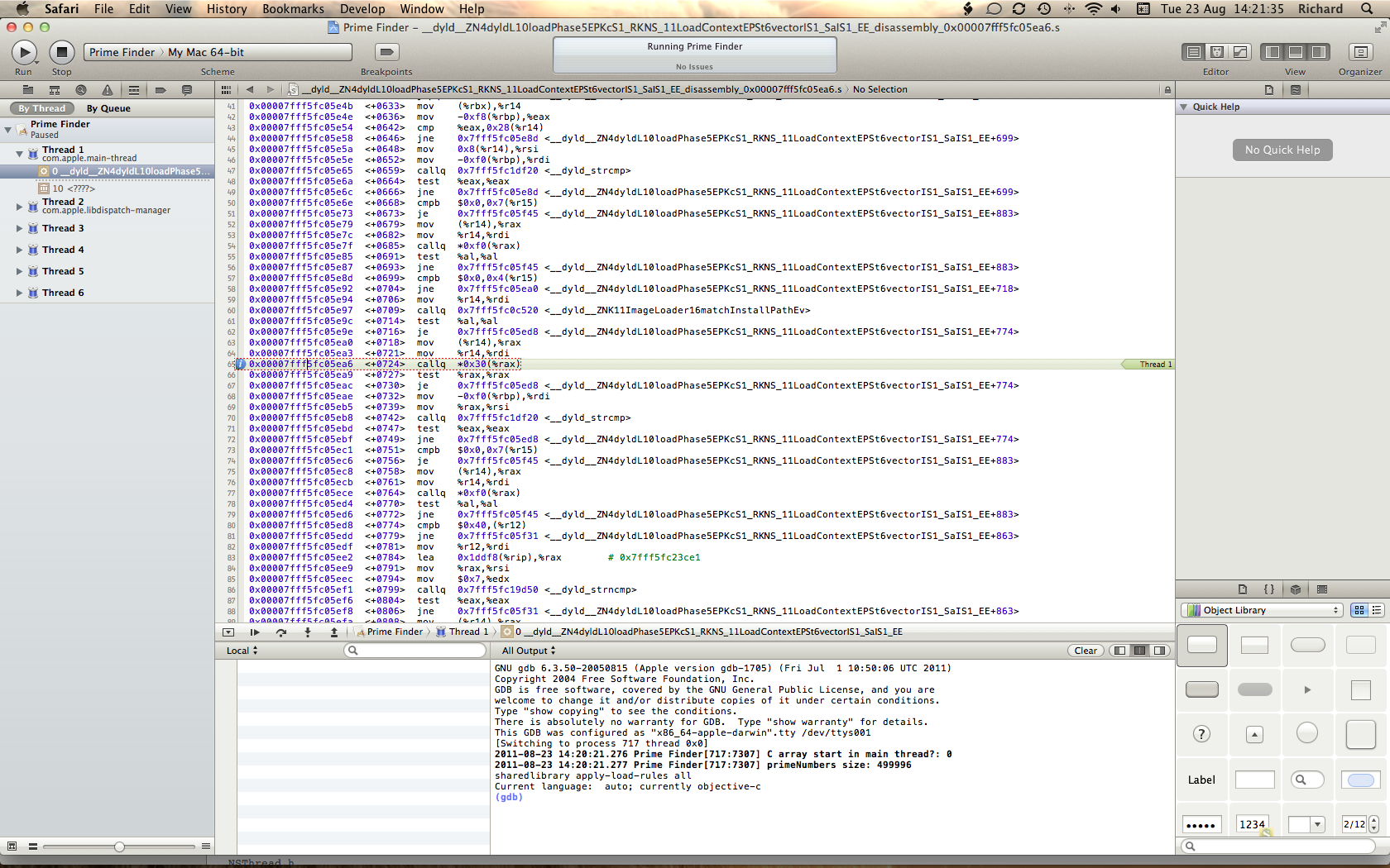

I would like to tell you the c array news but it keeps throwing exception, here's the code ('#if 1' for c array, '0' for NSMutableArray)

	NSLog(@"primeNumbers size: %llu", ((2+end-start)/2));// returns a correct value
	unsigned long long primeNumbers[((2+end-start)/2)]; //any NSLog after this line throws exc bad access, if there are no logs it throws one like the picture at the bottom
	NSLog(@"1");// like here
Very weird, changed code to the following and it worked, but without the final perform... here it either throws on main or 'primeNumber[primeCount] = n':
