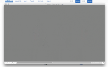

Could anyone test this 10bit 4k HEVC file, it's an mp4 so hopefully it should work in quicktime. http://demo-uhd3d.com/fiche.php?cat=uhd&id=150
This is what it looks like on Sierra with latest VLC

MKV is a wrapper. Most likely you have been playing h264 files because I haven't seen any support for h265 in VLC.
Not true. VLC *does* support HEVC. My Late 2014 iMac can do 1080p HEVC movies. 4K is way too much. It depends on the bit rate. HEVC is computationally intensive. On an AppleTV, MrMc can do 720p HEVC 100% in SW using hand optimized code (A8 SOC).

That's not a mp4 file. It has the wrong file extension, actually it's a mpeg transport stream. So it's not going to work in QuickTime.
