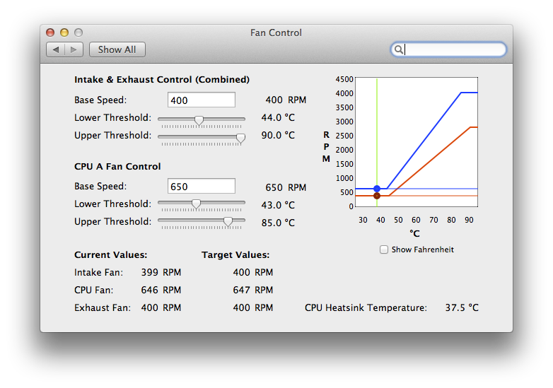

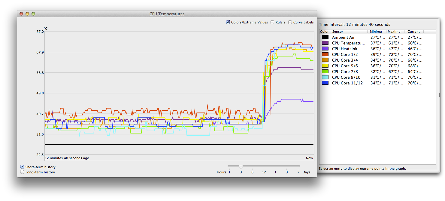

Even with 12 instances of /dev/null running, I still only see 61°C for the diode and 47°C for the heatsink. The cores themselves top out around 70°C. See screenshot 1 for details.
That said, I've changed my fan behaviour using a fan control utility, details here. I seem to remember my temperatures were somewhat higher before using it. See screenshot 2 for my settings.
