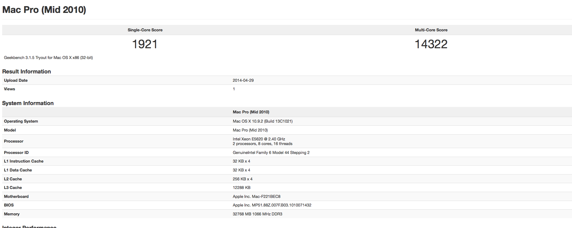

this is the benchmark that i just dis with the trial version, so no 64 bit but only 32:
so if the 3,33 gives me 18000 it's not that much right?
