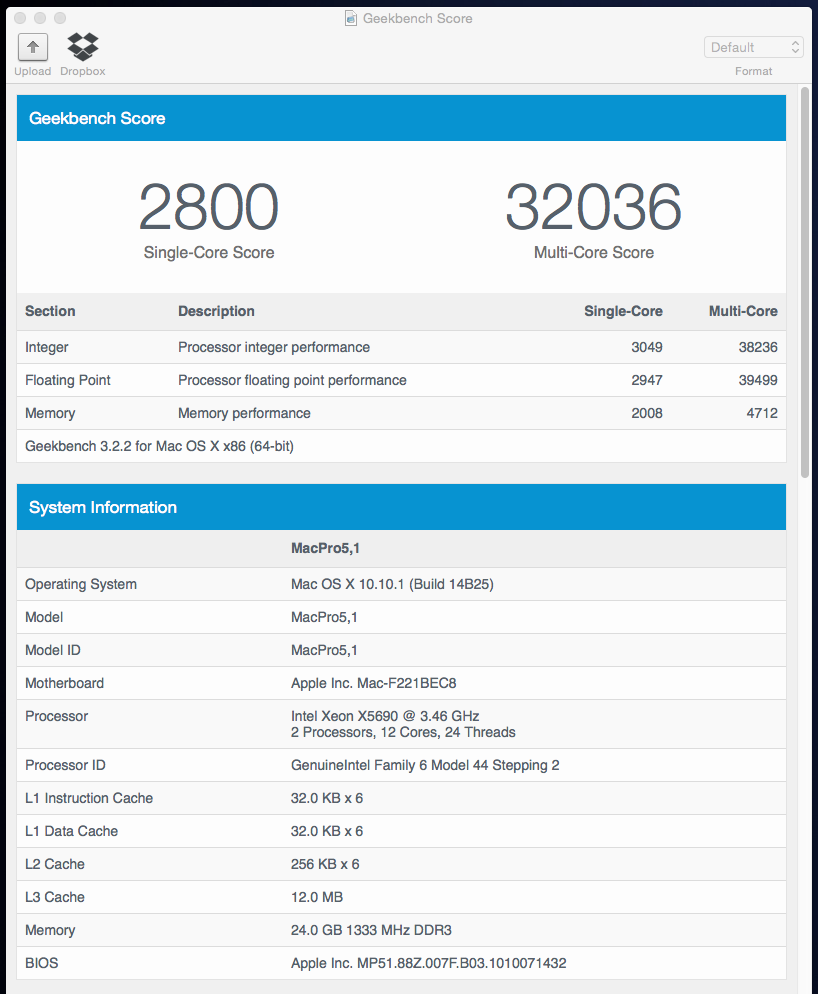

Thanks to this thread for the instructions on doing this. I recently did this upgrade on my 2010 MacPro, adding two x5690 processors and it flies!
Geekbench score attached.
