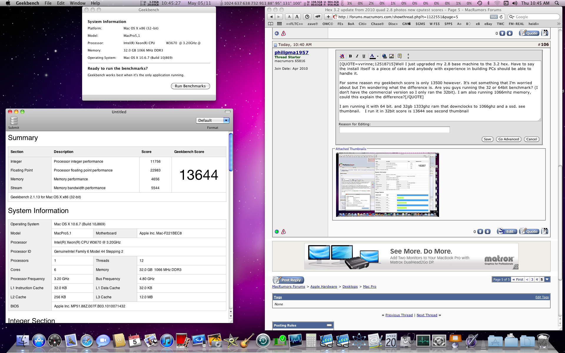

For some reason my geekbench score is only 13500 however. It's not something that I'm worried about but I'm wondering what the difference is. Are you guys running the 32 or 64bit benchmark? (I don't have the commercial version so I only ran the 32bit). I am also running 1066mhz memory, could this explain the difference?
Well I just upgraded my 2.8 base machine to the 3.2 hex. Have to say the install itself is a piece of cake and anybody with experience in building PCs should be able to handle it.
I am running it with 64 bit. and 32gb 1333ghz ram that downclocks to 1066ghz and a ssd.
score is 15357 see first thumbnail.
I ran it in 32bit score is 13644 see second thumbnail

Ah thanks for that. So the 32bit scores are in-line what you are getting.
