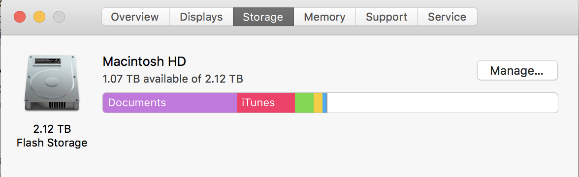

I installed on my MacBook Retina without any issues - so proceeded to my iMac - all seemed to install OK. It is a 2105 iMac 27 with 2TB Fusion drive - now 'About This Mac' reports a 2.12TB SSD not a Fusion Drive. I am having problems on wake - screen shows the file folder with ? mark as if it can't find a hard drive/operating system. Power button restarts OK

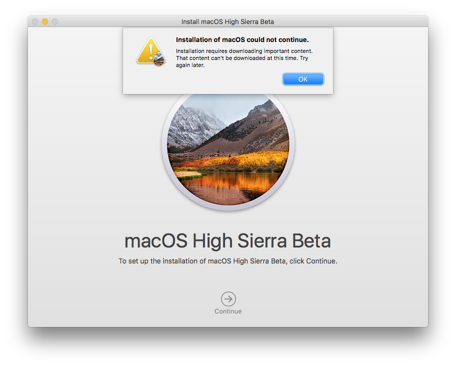

I'm on a 2012 iMac, macOS Sierra 10.12.5. When first trying to install the first public beta of macOS High Sierra I got the messages that my recovery partition was damaged could not proceed. So I deleted that downloaded of High Sierra and download it again and this time I got this message. Anybody seen anything like this?
