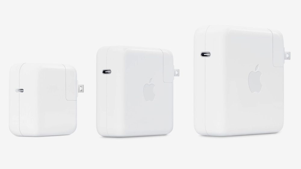

I think this photo shows the iPad, 13 inch MBP and 15 inch MBP adapters.
@VictorTango777 I guess the bean counters did their math on it... power bricks are still quite expensive, especially good ones. Even with GaN becoming more widely adopted I think a 60W adapter will still be significantly cheaper than a 90W adapter. The stupidy on the power adapter is that it comes with only a single USB-C port and no USB-A port (those iPhones are still delivered with a lightning to USB-A cable!). Because that way the adapter could have doubled as port replicator without any additional equipment or dongles necessary and that would have added almost zero cost. can't innovate my...
You wouldn't believe the amount of ignorance in these forums over this subject, with some people vehemently arguing that using a higher wattage power adapter will somehow damage the laptop. Those people seem to think that using a higher wattage power adapter is the same as force feeding electricity from the power lines directly into the battery. Their lack of understanding is compounded by Apple's tendency to ship different wattage power adapters for each laptop model, rather than standardizing on a single power adapter across all their laptops. Standardizing on a single power adapter for all laptops would simplify manufacturing for Apple. It would simplify inventory for stores so they don't have to stock adapters for multiple Mac laptops. It would simplify things for businesses and people who own different size Mac laptops. The difference in size between the Apple 60W and 87W is not that great. And since they are all the same price, it would make more sense to buy the most compatible.
The size and weight difference between the different adapters is definitely noticeable. My wife complained when she had to use my MBP 15's 87 watt brick when she lost her 29 watt adapter for her Macbook 12.

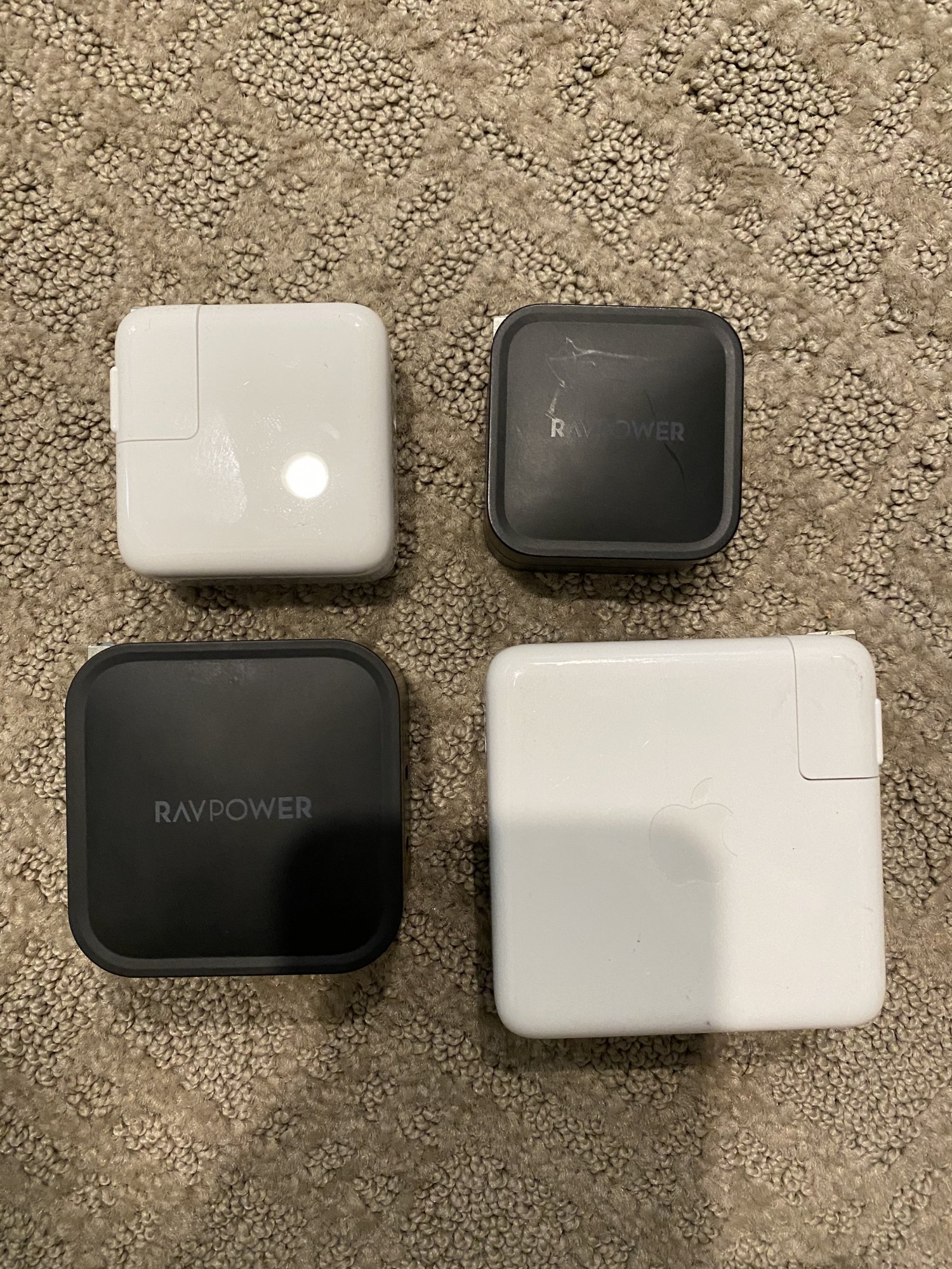

I've gone to ravpower USB-C adapter for my MacBooks. Much smaller than the Apple equivalent with the same wattage. Even the 90 watt model has 2 USB C ports which come in handy as I can charge iOS devices along with my MacBook when on the road.
Starting from upper left going clockwise:
1. Apple 30 watt from 2020 MBA
2. Ravpower 61 watt Gan - smaller and lighter than Apple's 30 watt adapter!
3. Apple 96 watt from MBP 16
4. Ravpower 90 watt Gan with 2 ports - about the same size as Apple's 60 watt - slightly smaller
