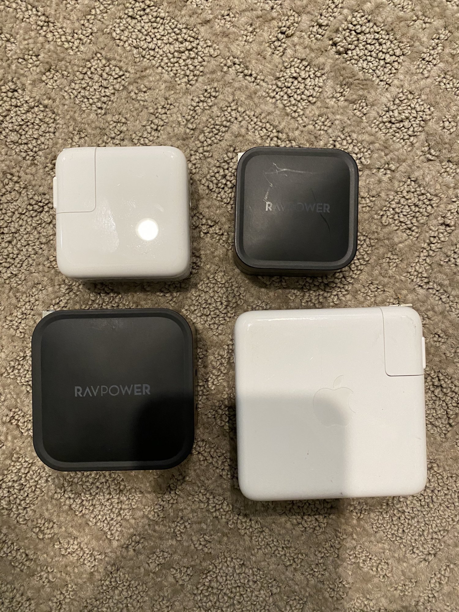

I've gone to ravpower USB-C adapter for my MacBooks. Much smaller than the Apple equivalent with the same wattage. Even the 90 watt model has 2 USB C ports which come in handy as I can charge iOS devices along with my MacBook when on the road.
Starting from upper left going clockwise:
1. Apple 30 watt from 2020 MBA
2. Ravpower 61 watt Gan - smaller and lighter than Apple's 30 watt adapter!
3. Apple 96 watt from MBP 16
4. Ravpower 90 watt Gan with 2 ports - about the same size as Apple's 60 watt - slightly smaller
