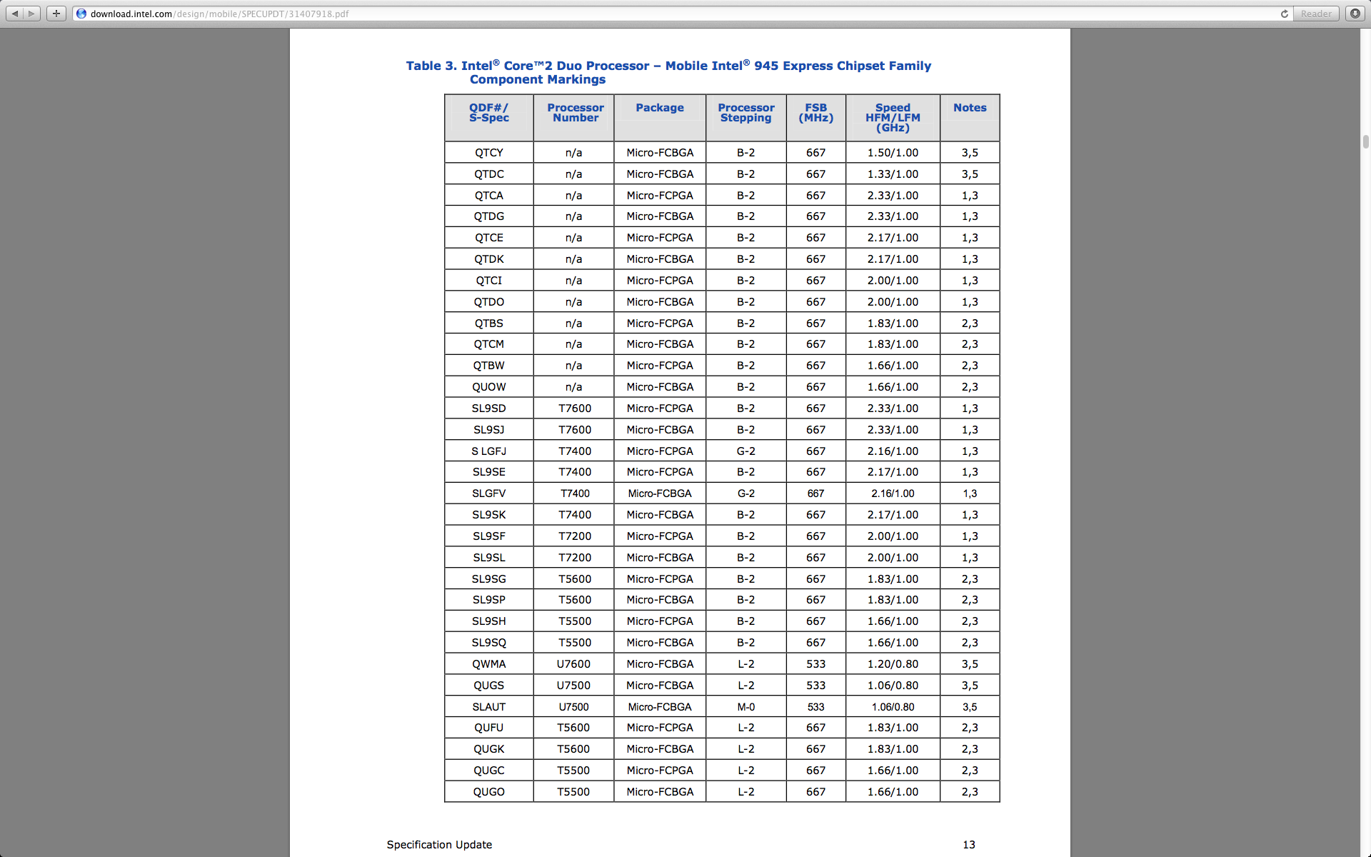

Talking about a a Core 2 Duo T7600, does somebody knows the differences between a SL9SD(B2) and a SL9SJ(B2). What does the sSpec number refers to? Can I either opt for one of the two?

note bold and caps are to show importance not shout.
NO you need the one with pins.
i believe the sl9sd is correct give me a minute for a link
http://ark.intel.com/products/27257/Intel-Core2-Duo-Processor-T7600-(4M-Cache-2_33-GHz-667-MHz-FSB)
go to page 13 from below
http://download.intel.com/design/mobile/SPECUPDT/31407918.pdf
if you look at the thumb nail you will see the t7600 sl9sd notice it says it is micro-fcpga the p means pins GOOD
notice the sl9sj it reads micro-fcbga the b means balls. NO GOOD
I am pretty sure I am correct not certain but 90% sure.
