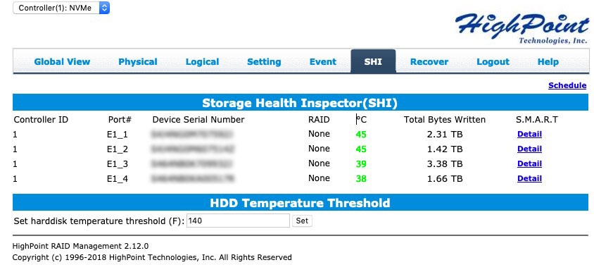

To quote your words "The 7101 might get close to throttling if you’ve got other warm cards near it." To the contrary, The SSD-7101-A is a well cooled solution that does not throttle SSD's. Whilst you may have a different opinion, the forums would benefit from any results results that illustrate this claim.
The SSD-7101A's large heat-sink does a great job of removing heat. Case in point, when I had 4 high-temp SM951 SSD's installed in a raid-0 configuration with minimal increase in temps and absolute no throttling over extended tests. I'd be interested in ANY results that show the contrary. While I'd like to retest, I no longer have those legacy SSD's.
Regarding users who burned out their Broadcom PEX8747, this was likely a self inflicted issue caused by users replacing the factory provided heat sink with an insufficient cooling solution that allowed the chip to exceed the maximum temp of 70c. Excessive heat build up from 8w of power consumption without an adequate heat sink and directed airflow can easily shorten the lifespan of any PCIe switch.

Thanks to @handheldgames who shared with us Amazon's early warehouse deal of $275 on a new 7101A lot, I bought mine and modded it to be near silent with effective cooling to both the switch and 2x 970 blades (1TB Pro/2TB Evo Plus). Summer was quite hot this year here and my 970 Pro never crossed 42C under heavy writes at 28C ambient temperature (average is 24C). The Evo Plus, which I only recently bought and is also known for running hotter than the Pro, had a max temp of 44C under heavy writes.
As for the switch's temperatures, I recently took another reading with the infrared thermometer and noticed an increase of 2 ~ 2.5C to the earlier reported max temp of 41.5C to 43.5C ~ 44C which is still way below than the switch's max temp spec of 70C. I am attributing this increase to the newly installed Evo Plus blade.
The reported temperatures are very normal, and within specs, for Samung's NAND and Broadcom's PEX8747.
