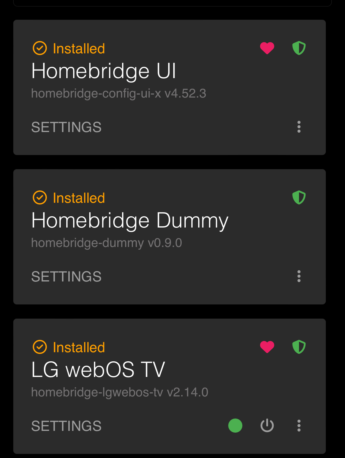

I installed lg webos tv plugin to homebridge and added it to homekit. I entered the IP address of the TV from the router into the plugin, as well as the MAC address of the TV from the router. it's like bridge now, not like tv. I can't create automation as TV, because there is no separate icon for TV.

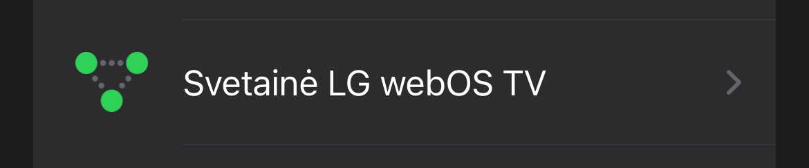

the problem is, I don't understand how to use that homebridge and how to make the TV as a TV, not a bridge
there are 2 options
1 - you haven't set homebridge up properly, and don't have a TV configured, check the homebridge logs
2 - it's been added, but it's in the default room, if on the main home page, you click "speakers and TVs" you should see the TV there, no matter which room it's in. you can move it to the proper room from there.

Install other plugin. a tv icon appeared! Thanks. but the tv on and off icon does not work. hmm, it's not clear what to set there. tv ip address and mac added.

thank you very much man. homebridge added. it was necessary to turn on the TV and activate it through a pop-up window.
