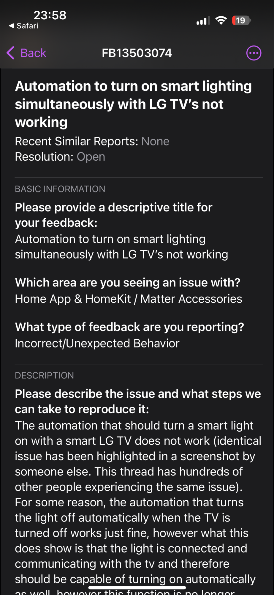

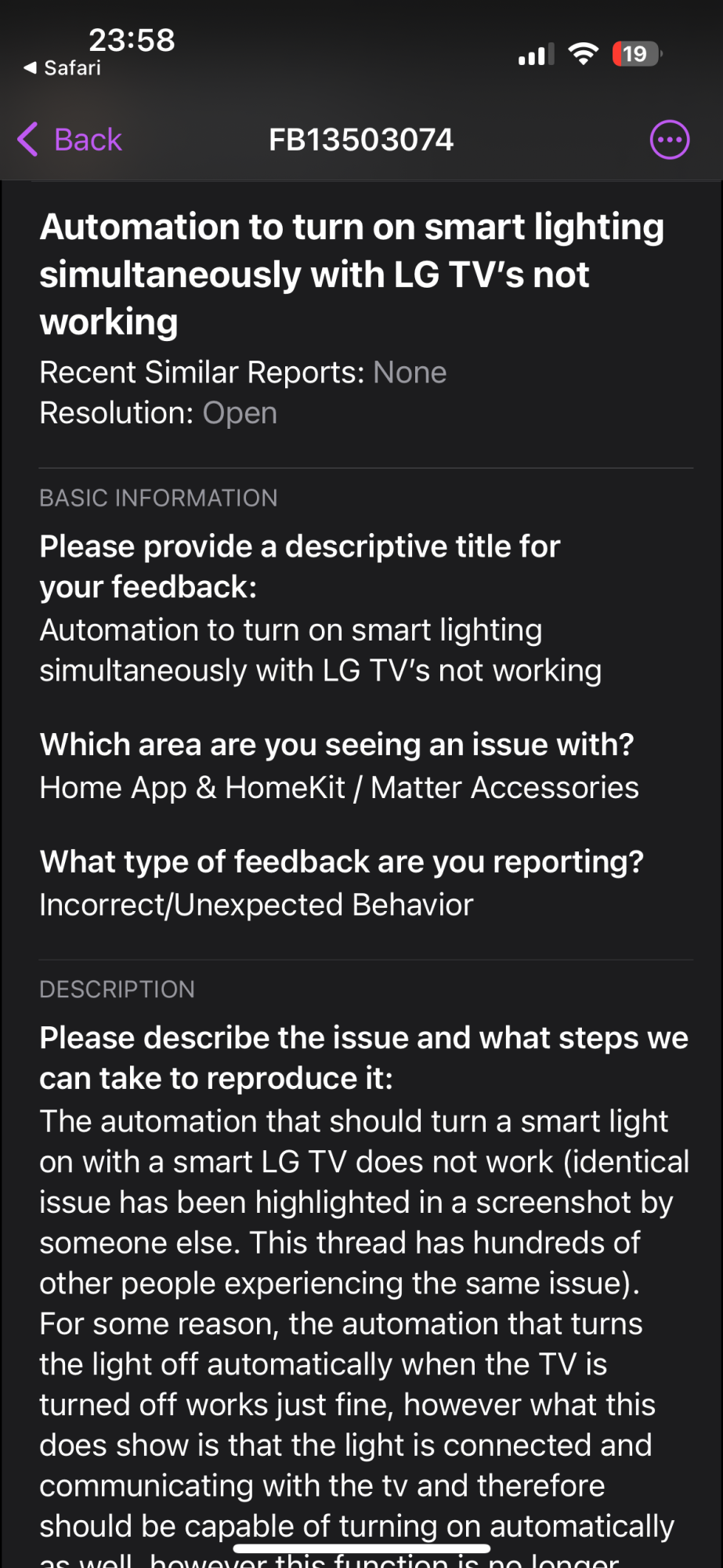

I too am having the same issue. If you go to https://developer.apple.com/bug-reporting/#feedback-assistant
there is a link that will open the Apple Feedback portal. I have submitted an incident there (screenshot below) and if everyone does the same with a similar title then hopefully this will get escalated and fixed soon. I’m going to post this same information on a couple of other forums that I’ve found this same issue on and hope to get it patched soon! Cheers!

Hey all,
