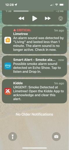

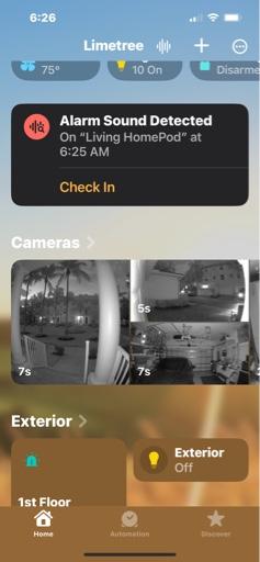

I was able to get the HomePod to detect the smoke alarm video, but I had to hold the phone speaker right next to the HomePod and it took ~30-60 seconds.
I will have to try with the smoke test button later in the day so I don’t alarm the family.
I also ran around and rebooted all my hubs (ATVs), not just my phone and HomePod. Not sure if that made a difference.

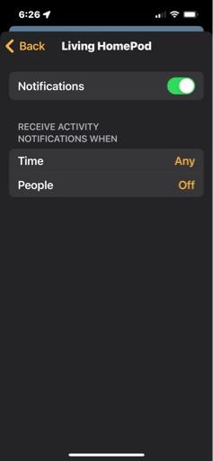

It appears the location based setting for notifications does not work. You have to set it to “off” to get it to work while home. “When I am home” setting did not work for me and I confirmed I have location enabled on my phone. I have some devices with share my location turned off. Not sure if HomeKit is having trouble deciding which device is your primary home vs away location status. Seems like the notification and home vs away should be device specific.
Also, there does not seem to be a way to dismiss the notification in the home app.
I tried checking in, but that just resulted in audio feedback loop between my phone and HomePod. The notification in the home app simply disappears after some period of time.

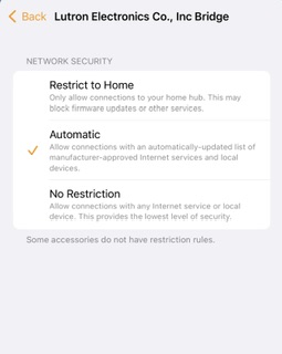

I'm curious about that WiFi Networks and Routers section you have. What devices are compatible with that?
That’s HomeKit Routers. Only three manufacturers implemented it and on older models. Linksys Velop (Sold at Apple), Eero (Used to be sold at Apple but not anymore) and the newest is Amplifi Alien (Sold at Apple).

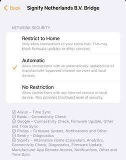

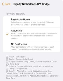

It’s basically a firewall for your HomeKit accessories. Has three modes. “Restrict To Home”- The accessories cannot communicate with anything other than HomeKit, “Automatic”- Only communicates with its native third party app for stuff like firmware updates, and the last mode is “No Restriction”- flood gates are open…
Yup, exactly this. Mine are a set of Eero Pro 6 units, which is a mesh system. That’s why there are four entries. The entries themselves don’t do much other than show up as devices in HomeKit, but once you e added one the additional security options show up.
Sadly, eero seems to have dropped HomeKit Router support in its newer models like the 6E and 6+, but it’s committed to continuing to support it for models that already have it.
That’s essentially correct, although “Auto” is a bit trickier. It doesn’t communicate through the third-party app; it’s more like a limited firewall with only specific ports open for things like direct firmware updates and time sync. However, the manufacturer has to give Apple a list of these rules. If a company hasn’t done so, then “auto” is the same as “no restriction.”
In my case, Philips Hue, Ecobee, and Logitech all have specific rules for auto mode. Others like Lutron, Chamberlain, and Eufy don’t, so I leave them as “Restrict to Home” during normal use.
There’s also another benefit to HomeKit Routers. When setting up Wi-Fi HomeKit accessories, they will be assigned a private key instead of using your actual Wi-Fi password. This improves security in the event one of your IoT devices gets hacked or decides to leak Wi-Fi info, and also means you don’t have to run around updating passwords on a bunch of smart home devices when you decide to change your Wi-Fi password.
