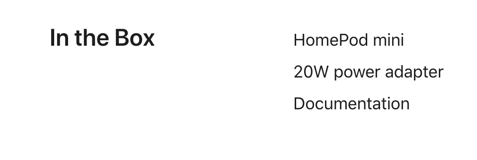

So we know that the HomePod Mini comes with the new Apple 20W USB-C adapter.
We also know that USB Power over USB-C is a confusing mess, with various supported power delivery options.
But, does anyone know if the HomePod Mini actually requires 20W of power, or will it operate with an 18W or even 15W alternative adapter?
It would be nice to know if I could swap out the 20W HomePod Mini adapter with my iPhone 11 Pro 18W USB-C power adapter so I can use the new 20W adapter with my MagSafe charger without having to buy it separately.

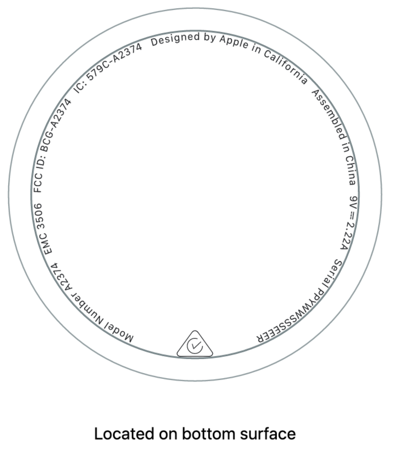

Attempting to research answers for my own question, I found an FCC filing for the HomePod Mini. The bottom of device does specify 9V ⎓ 2.22A, which is the same power provided by the 20W adapter. If that is true, then only adapters that were already found compatible with the MagSafe charger will properly work. I would still like confirmation on this though, as I won't get mine until the very end of the month.
https://fccid.io/BCG-A2374/Label/FCC-ID-Label-and-Location-4938487
The mini includes a 20W adaptor, why would you want to use something else? The actual demand is going to depend upon how loudly it is playing, if it is in standby then the draw should be near or at zero.
So what happens if it is plugged directly into a Mac's USB-C/TB3 port?
It will probably work just fine. But there is really insufficient information available, that I can find at the moment, to really clearly understand what the options will be for powering the HomePod mini.
