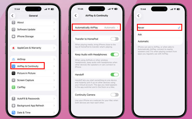

I found a final solution of this ghost touch, if you have update iphone or ipad to the latest version, go to setup->chose general-> airplay & continuity->Automatically Airplay, choose Never option rather than automatic. Hope it will helps to everyone.
I have setup the Ask setting on my 2 iphones (one personal, one work).
but how to solve when in the house you have lots of Airplay compatible devices?
My faulty Homepod (alone or in stereo mode) happens to stream also music from AppleTV which uses them as the default speakers
Sorry, I don't use airplay this feature much more, I only ingnore this setup on my iPhone and iPad devices.

So far, I still keep disable airplay feature on my iPhone and iPad, seems Apple has changed some fundamental data for release apple challenge at IOS 27
