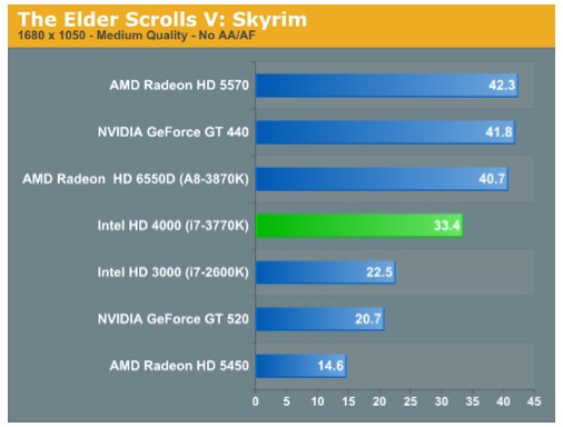

To me it's very impressive that a GPU located ON THE DIE of the CPU is capable of running Skyrim at 30+FPS.

The Intel 4000 is approximately 60% faster overall than the previous integrated graphics king on MacBooks, the 320M by Nvidia.
