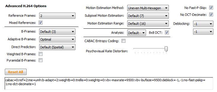

These are the advanced options I use:-
All of my HD video is encoded at 1280x720 and has a bitrate of around 6-6.5Mbps, I stream all of my content over a wired connection and my ATV never has a problem. I curently use HB 0.9.4svn3154 but have never had problems even using older versions.
As others have mentioned, and also shown in roidy's screenshot, disabling CABAC is the key to this one. Although not officially supported as per Apple's ATV specs page I think it is safe(ish) to use on SD material but I would say it was a no-go on an HD source.
Your other advanced settings look pretty close to what I use and I have no problems with HD playback, with CABAC off.

In the last column of roidy's settings there are some different values but I really don't know what they do. Maybe these could help with the "moving walls"?

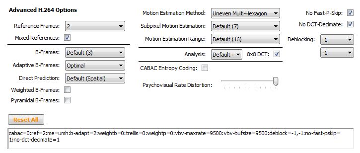

Yep if you look at my screen shot you'll see I use both the 'No Fast-P Skip' and 'No DCT-Decimate' options and a deblocking value of -1,-1.
First the 'No Fast-P Skip' option is the one you want to stop the problem your having, namely the color banding(solarization effect). Don't let anyone tell you that color banding is because iTunes uses higher quality source because it isn't, I've seen the same problem on quite a few iTunes purchased encodes. If there is no color banding on your source material then there is no reason it should be on your encoded version.
Second the 'No DCT-Decimate' option will prevent the encoder from destroying subtle detail in the source material like filmgrain.
Third, the -1,-1 deblocking values are because I think Handbrake makes your encodes too soft and blurry with the default values.
The only downside to these options is a slightly longer encode time. Give them a try and see.
