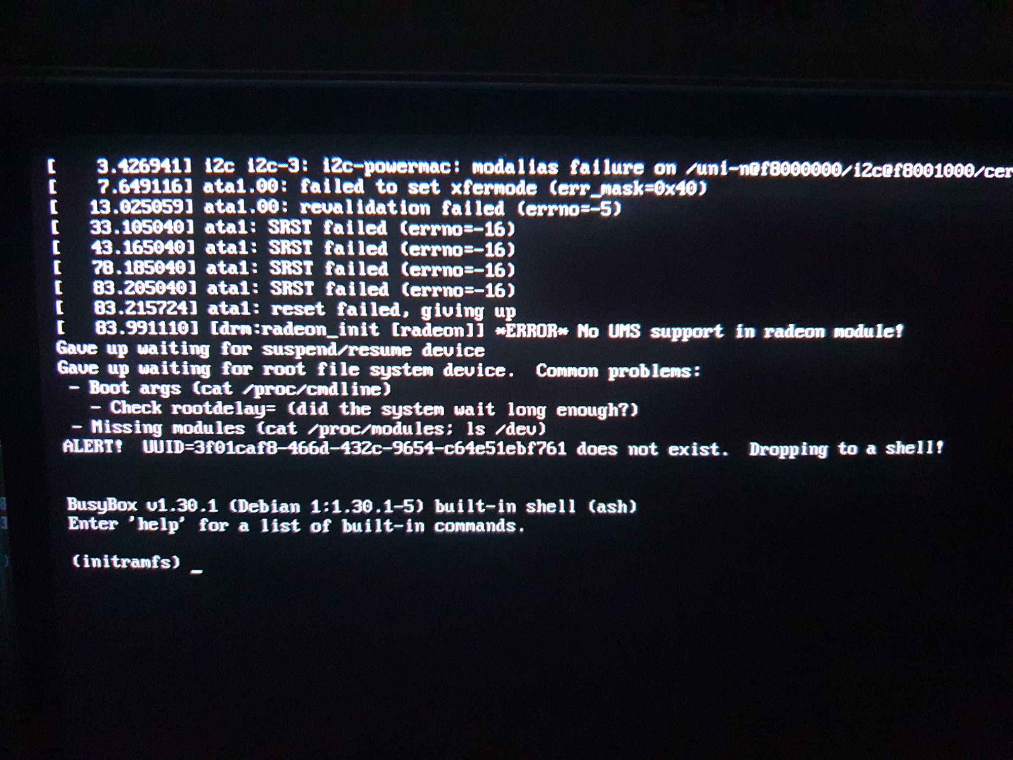

Hi all!
The dance started.
I've booted Lubuntu with nomodeset, everything was so unreadable that I could not find the install lubuntu icon (imho it is not there) in the live distro so I said myself let's go back to good old Debian.
Installed 10.0 like a breeze.
Added to the list openssh server and lxde desktop, a joy.
I reboot and I see this
Seems like my hdd is no longer seen.
If I reboot and start mac os x works like a champ from the same hdd so...
It must be some driver I fear.
Is this something eMac related?
I have to add that I use a sata to pata adapter and ssd drive but the same disk was detected during install with no problems.
Maybe instead of choosing kernel 5 I should have chosen the other option (the one without version)?
Maybe using an older LTS or one of the remixes shared here can help?
Thanks for your time and help on this crazy quest 🙂
If the root filesystem is the issue, you may want to try manually partitioning the drive as detailed in the Manual Partitioning guide in The PowerPC Debian Wiki.
I think I installed Debian 10 on my eMac before, and while I didn't encounter this, the screen went black as soon as it switched into X, so I am inclined to believe it is indeed some kind of filesystem issue, just as the errors hint at.
That said, Linux 5.x sucks on PowerPC (in my experiences), so perhaps choosing version 4.x or whatever else may be useful too.
Very interesting suggestion!
So the idea is to download a more compatible version of Debian / Ubuntu (one from that period in time) and then just apply security updates without ever doing a distro-upgrade?
@ltpitt The idea is to first attempt to manually partition the drive for installation as according to what the Wiki instructs, in order to get around this filesystem issue, if it is that.
Keep in mind however that you will then need to screw about with the xorg.conf file in order to get X even working on the CRT display, as detailed here:

Hi again!
I tried manual partitioning but something weird happens...
The disc is "intermittently" detected by Linux.
Configuration is weird because I use a Startech sata / pata adapter and a ssd drive.
Mac os x starts 100x100 of the times, zero issues.
Linux sometimes detects the drive and installs (but never sees the disc at the next boot and sometimes doesn't even see the disc when I install.
I read it could be dead ssd (but this is false, why should be mac os x work?) or a kernel issue so my next step is trying another kernel version.
What is the "most emac compatible" Linux distro and version I can try?
Something older, I guess but how old?
Is it better Debian or Ubuntu or other?
Thanks!
@ltpitt The most "eMac compatible versions" would be Ubuntu 12.04 and Debian 7. The display works out of the box in those.
I would actually recommend @wicknix's Lubuntu 12.04 Remix for this, not only because there shouldn't be any xorg config issues, but because it has also been updated to a great degree.
