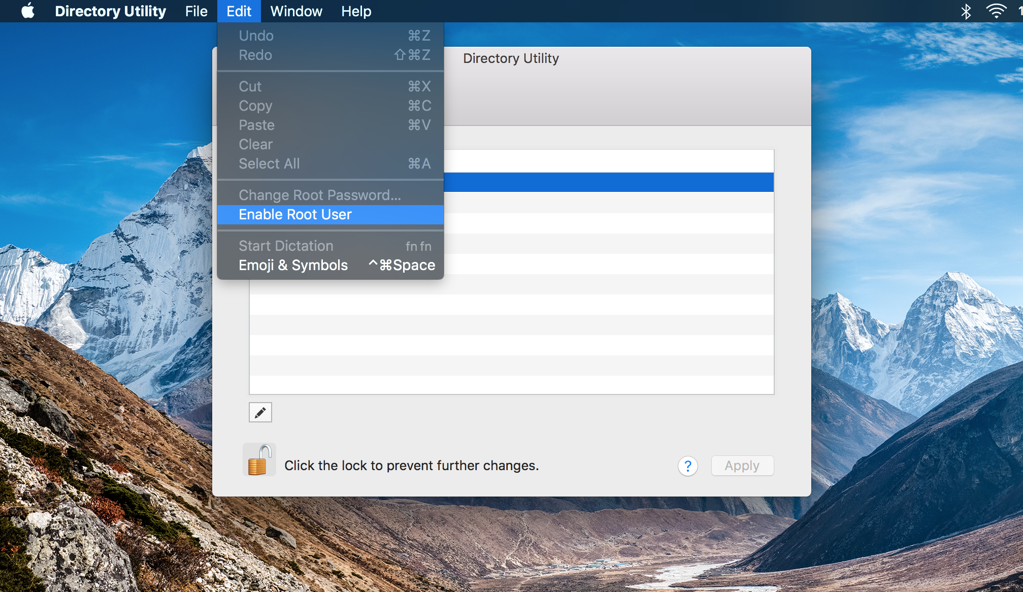

The "other user" for me is because the root user is enabled by High Sierra install somehow. I turned it off again with command "dsenableroot -d" and it's gone.
