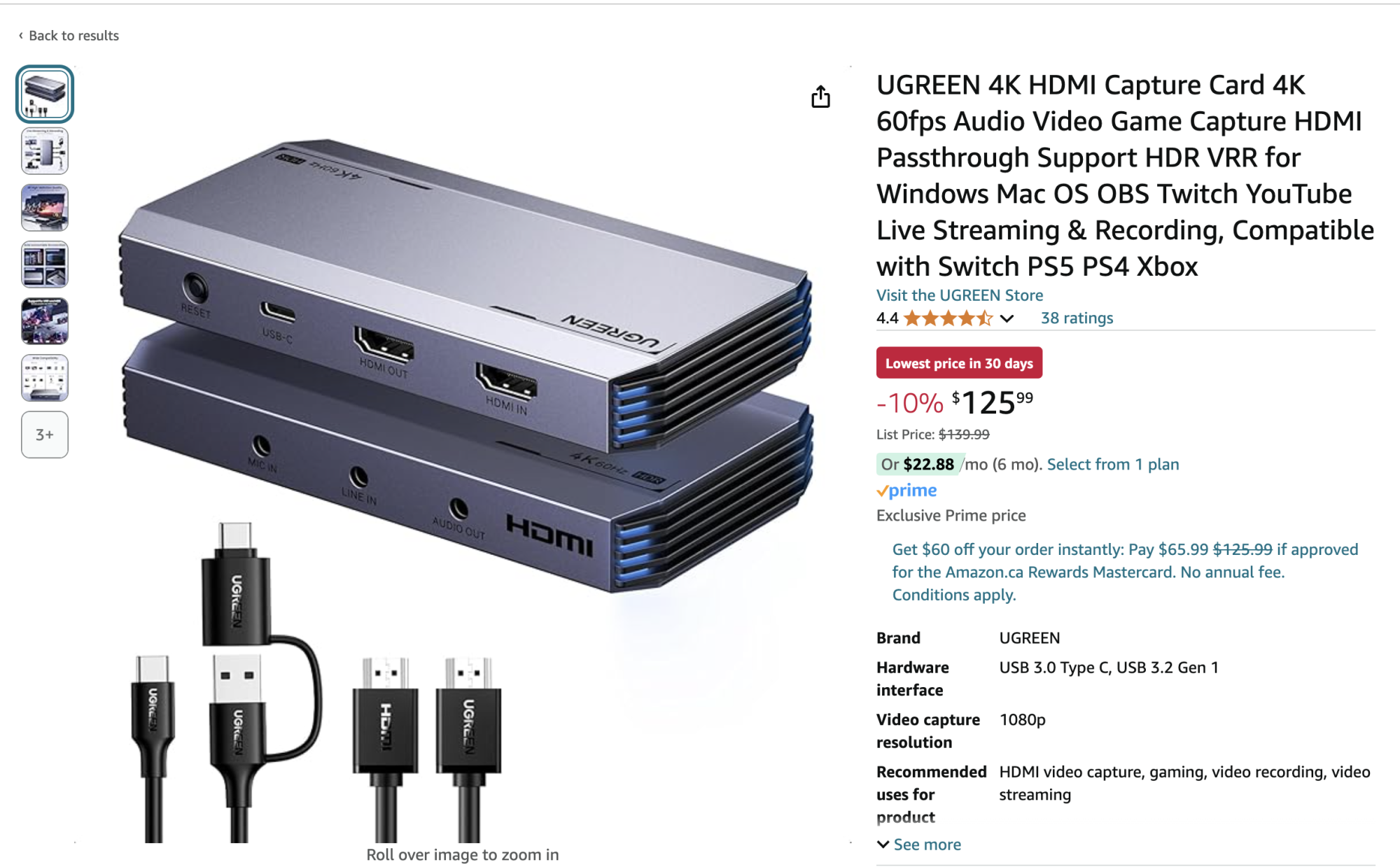

Any recommendation for a good 4k grabber ?...i see most are sold as USB3.0 out,...no USB C (TB4) ? (not needed/better? )
Thumbs up on this unit ?
